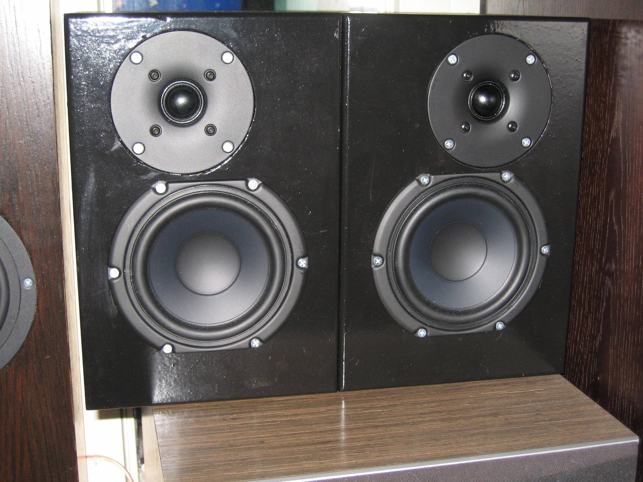

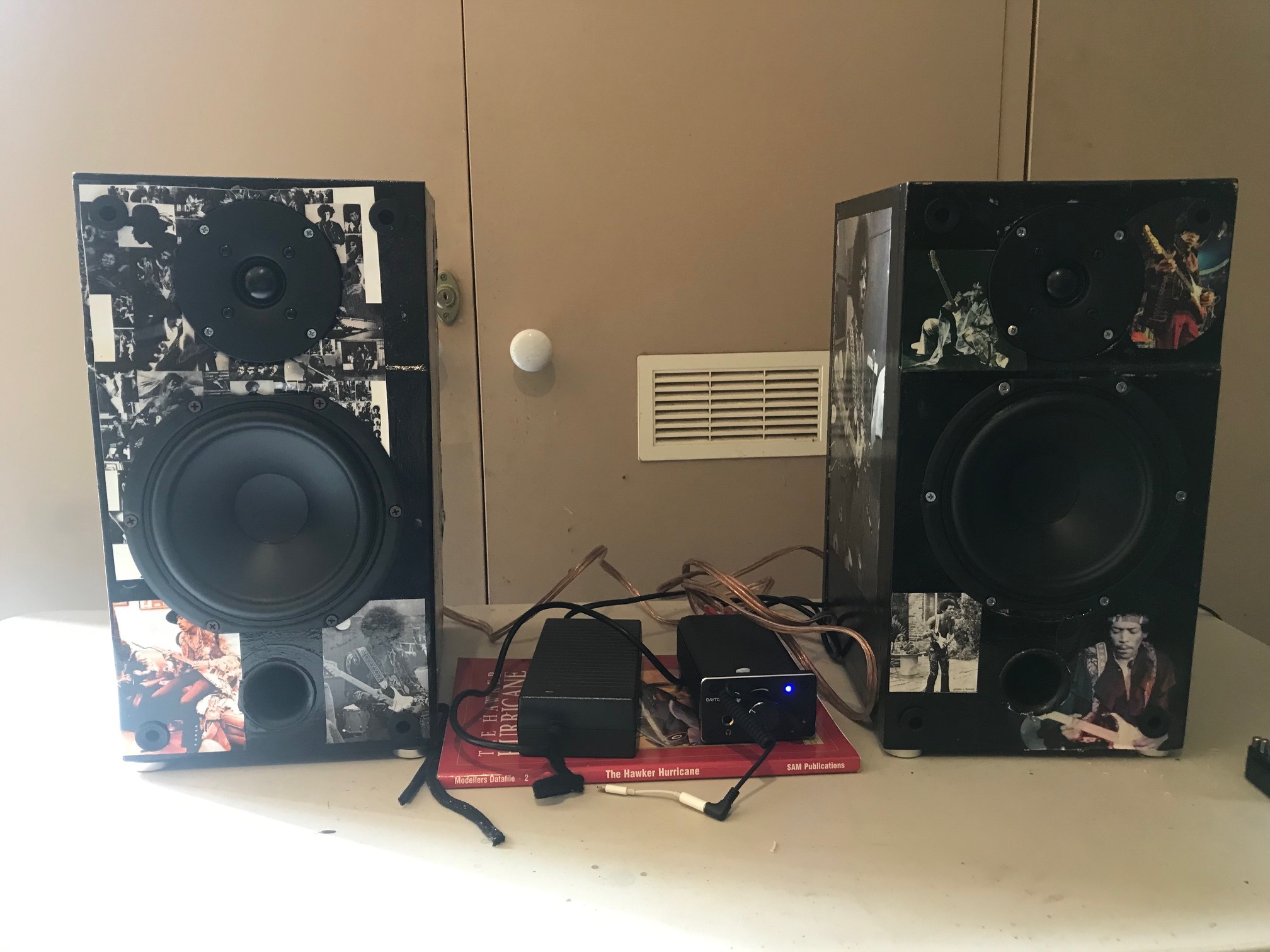

Have used the 4 ohm with the SB16 (Michael Chua's Lark SM); in Paul's Classix II; in a two way with a Peerless 830656 (5.5") courtesy Ralf Giralfino of this Forum; and with the Peerless SDS160 (6.5"). The latter two are shown, please excuse the amateurish cabinets.
With some XO tweaks to allow for the 8 ohm tweeter, these would give you some good options - and all pretty cheap, too. Ralf's design had the lowest XO parts count, if that's an issue.
Not sure how any XO parts value changes would affect the designers' good work on the originals.

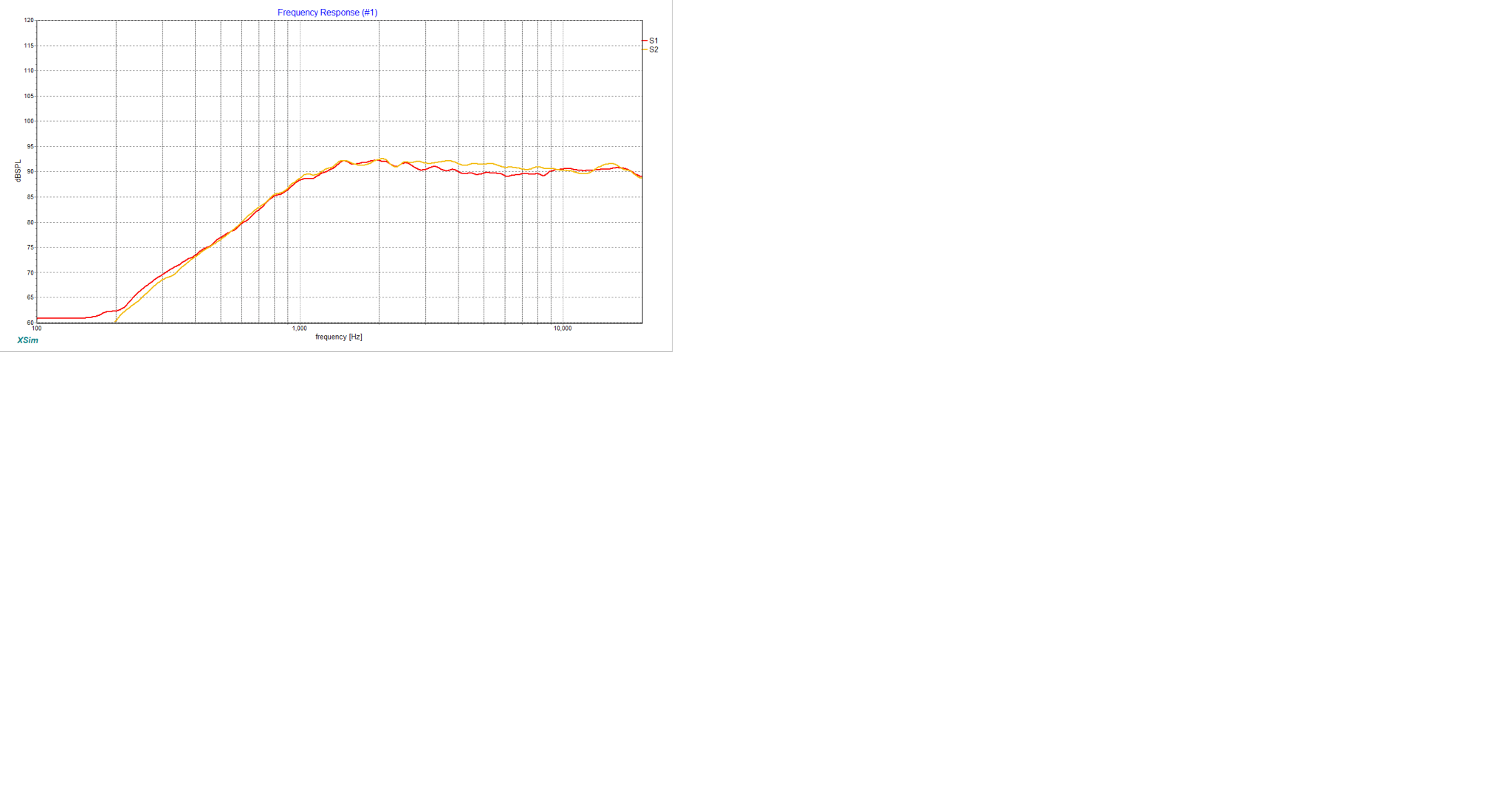

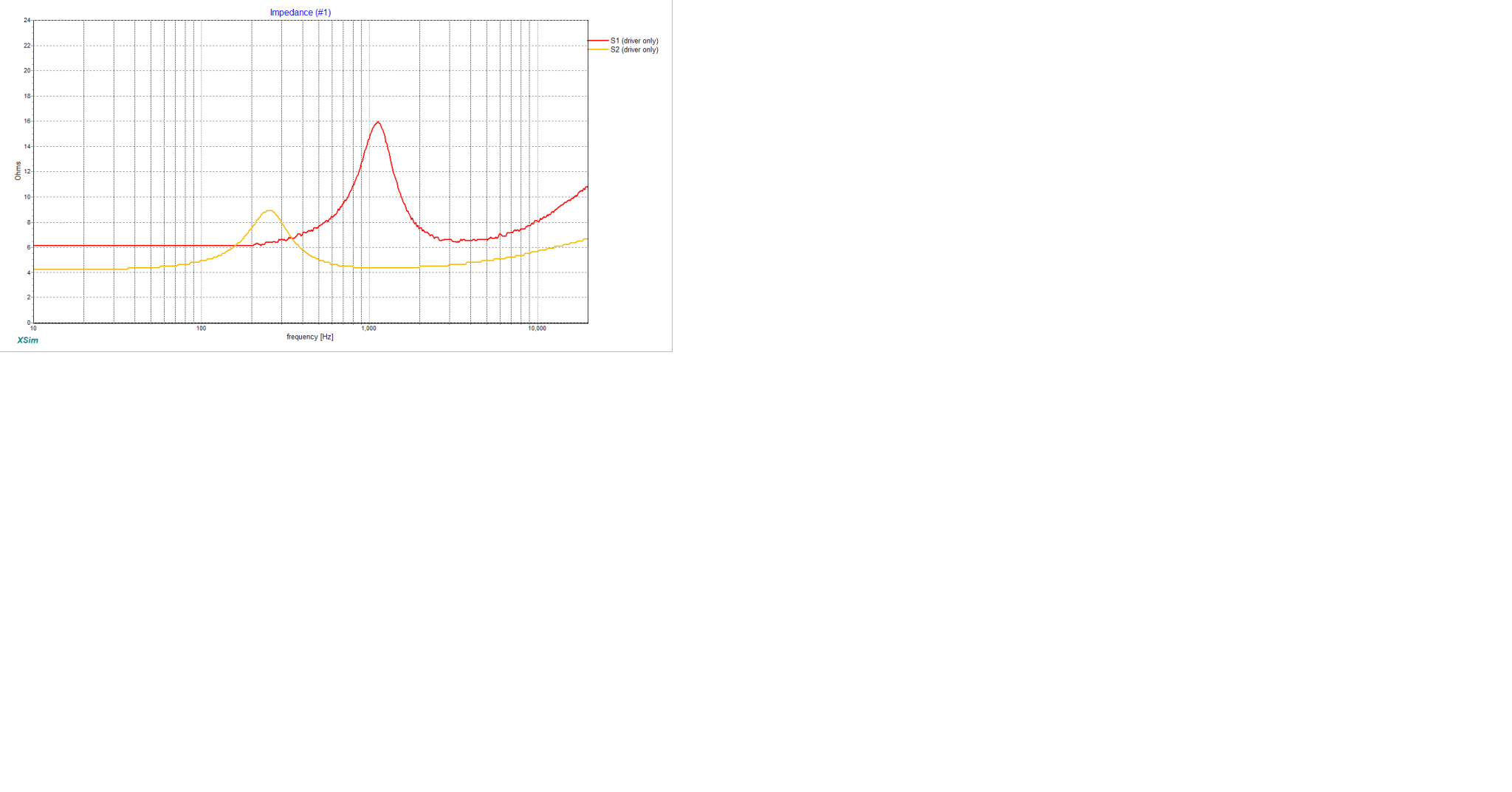

FYI, here's my Xsim comparison of the FR and impedance graphs of the 4 and 8 ohm BC25TGs, using Vifa supplied graphs and fptrace.
Please note that the Vifa data is not measured in your cabinet and may not, in any case, be accurate, but at least the comparison is like with like. Red line is the 8 ohm version.
The ZMA graph is a bit puzzling, as the stated resonant frequency of the drivers (1136Hz for the 8, 1128 for the 4 ohm) is almost identical, but the supplied ZMA shows that the 4 ohm has a much lower resonance peak - I think that's quite wrong; I'd expect them to be almost the same.

Maybe that's from an older Vifa datasheet that had the wrong scale? The current one in Peerless's webpage looks fine:The ZMA graph is a bit puzzling, as the stated resonant frequency of the drivers (1136Hz for the 8, 1128 for the 4 ohm) is almost identical, but the supplied ZMA shows that the 4 ohm has a much lower resonance peak - I think that's quite wrong; I'd expect them to be almost the same.
https://products.peerless-audio.com/transducer/29
