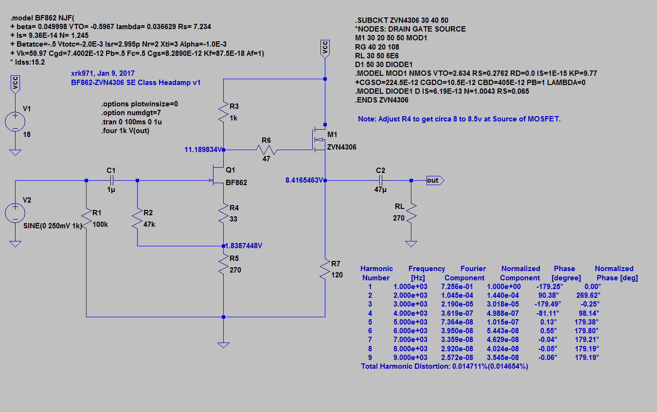

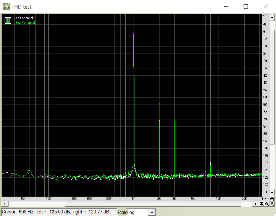

A simple circuit like what I use for a headphone amp makes nice circa 0.06% H2. It works with any SS low THD amp to give music some euphonic H2.
xrk971 Pocket Class A Headamp GB
There is also a variant where you can adjust relative H2 and H3. In above circuit varying R4 changes relative H2 to certain extent by changing bias current.

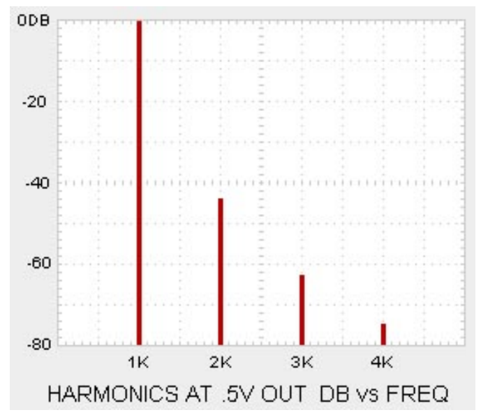

The H2 generator PCBoards given out at Burning Amp 2018, and discussed in Nelson Pass's article on firstwatt.com, have about 1% H2 (-40 dB). The circuit simulation in #43 has about 0.01% H2 (-80 dB), which is not nearly enough to achieve Pass's objectives.
_
In practice, with some tweaks to setpoints or because two 9v Li-ion batteries run closer to 15.5v, the H2 is closer to -60dB, which IMO, is the ideal value as -40dB is a bit too much for my taste. The -60dB is not something that gets in the way of the music, but simply makes it sound better, more “musical” and exciting.

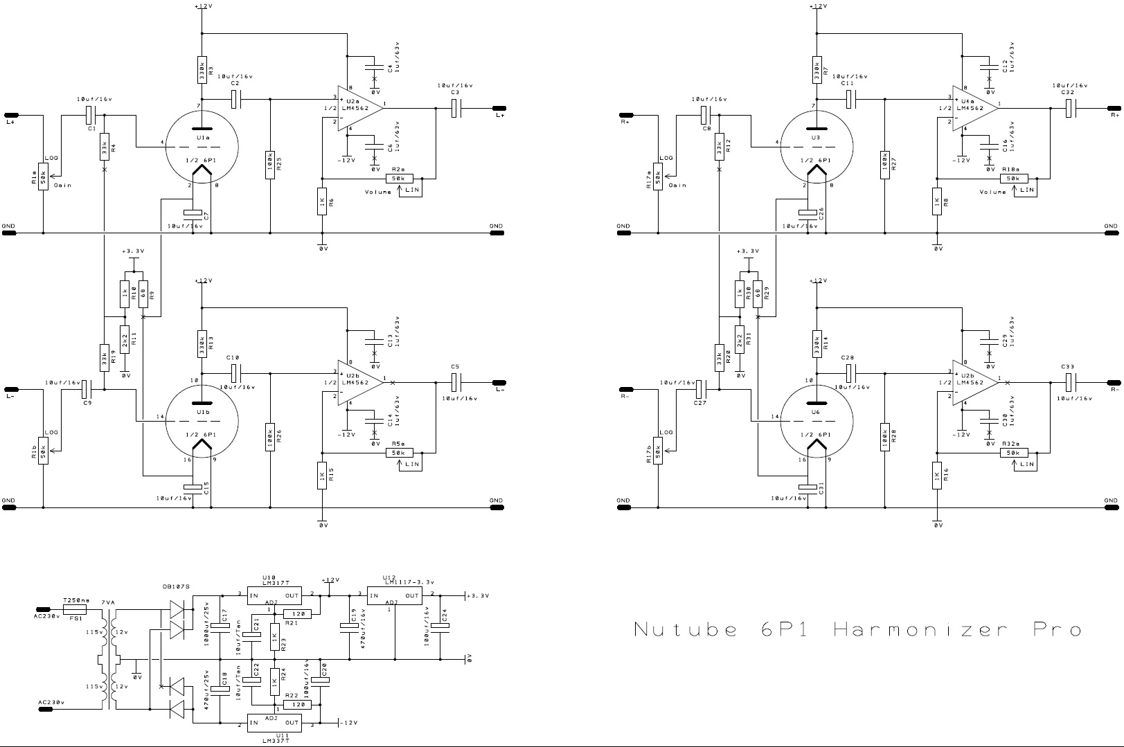

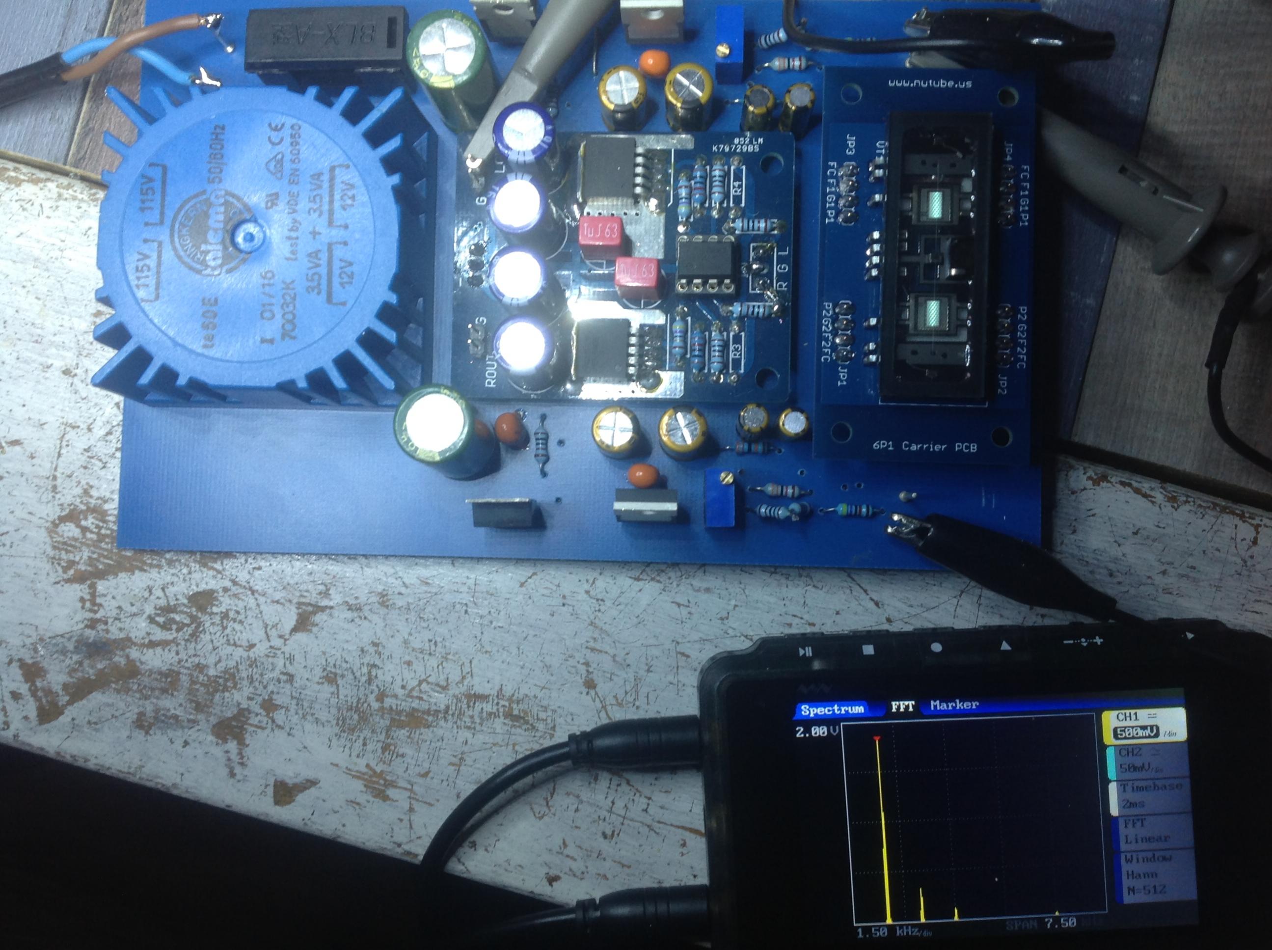

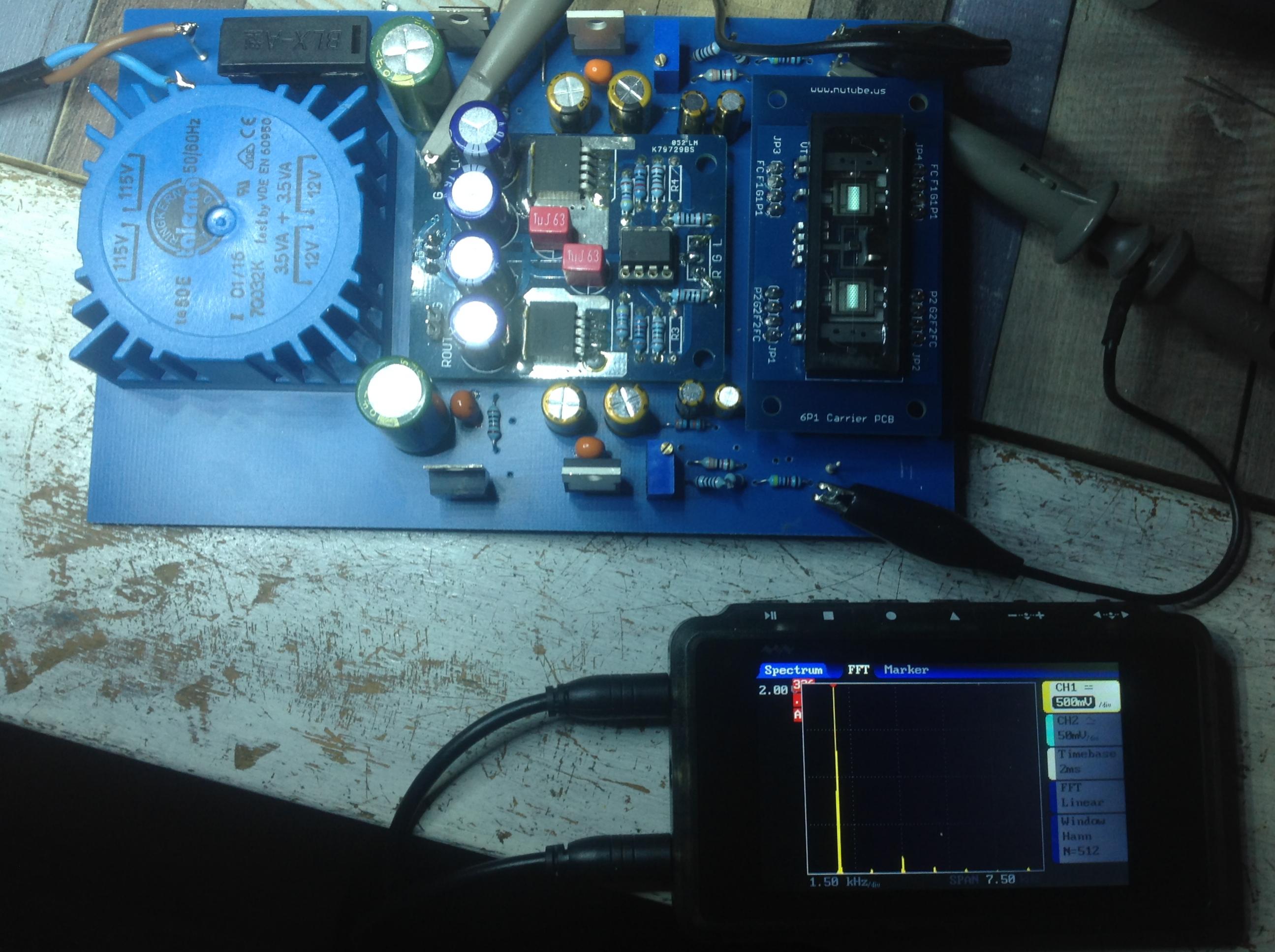

I have harmonizer with adjustable harmonics. Works great.
While adjusting bias, harmonics spectrum change. I have a hifi version( rca) and a pro version(XLR).
