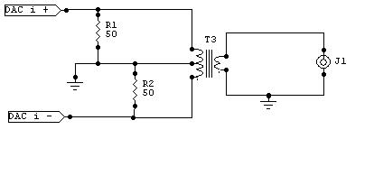

I did it like this, passive conversion. The DAC don't like large voltage swings, and the 50ohm resistors are a good match. The transformer is a Lundahl. Sounds pretty damn good😉
The output level is lower than redbook standard, but thats a good thing because you can crank the preamp volume, which means less wiper in the path.
Hmm, something is playing with me, cant seem to get the schem up. Perhaps I saved it in the wrong format....
Trying a jpeg.
because 1 resistor is IMO and many other opinion, NOT PLENTY. you do not gain the best performance from the dac this way. current out dacs often prefer to operate into very low impedance and preferably with their outputs returned to a virtual ground biased to AVCC/2

I agree about low impedance, but what is gained by biasing virtual ground to AVCC/2 ?

Well, with a passive solution and an output transformer, you can make the return anywhere u like. 50 ohms is low enuff, the DAC stays linear and has plenty complience.
The only issue is the lower than standard output level, but that to me is a good thing since I can set the volume potentiometer higher, which leaves less in the way. I have never had problems with playing loud enough, in fact the level is more like my phono pre, and I can pretty much leave the volume when switching between the two.
The benefits of a good transformer is also a choice of SE or BAL output, as well as preventing ground loops.
