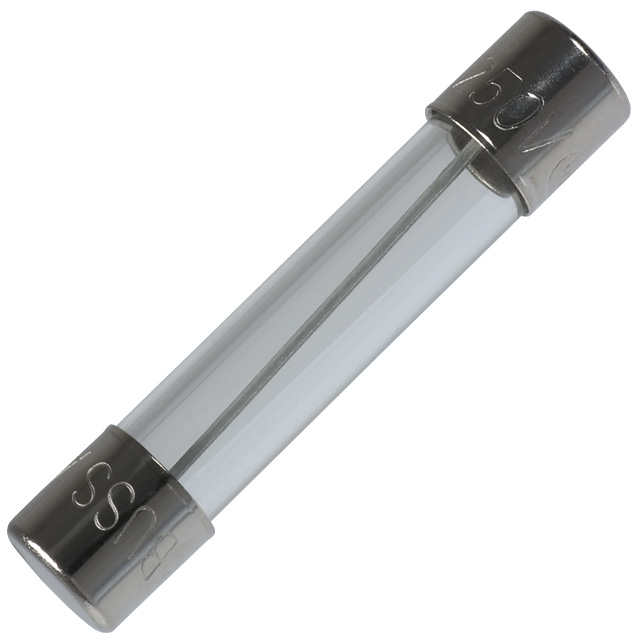

yah, the little bulb worked great, i'm charged and ready to go! thanks all.
My inner evil monster is wondering if the little glass bulb looked like this:
