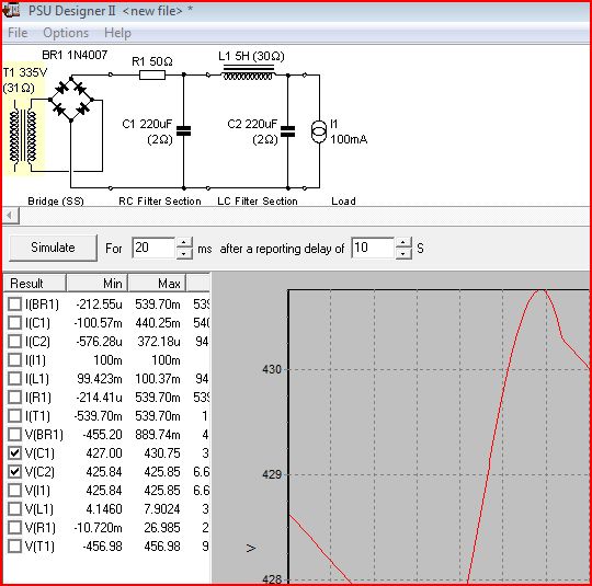

Oh damn, I forgot about the AC peaks. Are caps rated at peak voltage, not RMS? To avoid getting a whole new transformer (or removing a cap, as I would think removing capacitance from the circuit would be a bad idea) what sort of wattage and value of resistor would be required to bring it down, say, twenty volts? (I used to understand this, but I always forget my rules.)

Mable just got back to me and the output transformer's primary impedance is 5.5K, so that sounds like a pretty decent trade off between EL34 and 6L6. I'm now tossing up between EL34 and 6L6, but I think I'd like it to be usable for both. I figure at the moment that I'll start off with the EL34 tubes (just ordered some JJ's which happened to be going cheap.) to make sure it works correctly, then have a crack at the 6P3S-e tubes, biasing lower (perhaps pushing them up after 20 hours or so)
Should 70v at 100mA between the four 6L6's be enough to bias them down to 20 or 25mA?

Add a 50 ohm 10-20W will do lower a little. See attached.
