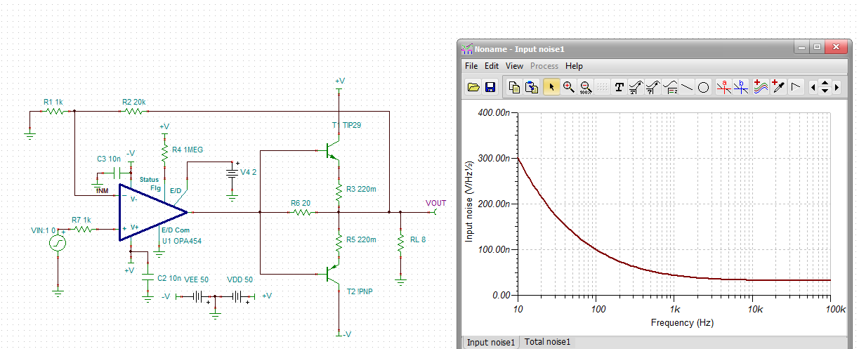

How do I calculate the inherent noise of this amplifier?
wwenze: I have a question about this way of biasing a class AB stage:
If I go with global feedback on this configuration the amp won't have any DC gain so the op-amp can't change the DC output, right? It will just ram the output to either +V or -V unable to compensate for the DC offset, right? How is this solved? I find settling for local feedback unsettling 😛
The resistors set the bias current, the dc output is set by the resistors and diodes, if there matched it should be near zero. The base emitter voltage is always .6 ish volts when the transistor is on.
