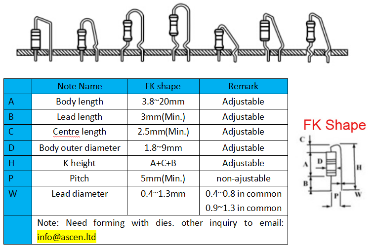

reading the datasheet offered by Mouser https://www.mouser.com/datasheet/2/219/CF-6922.pdf which admittedly is obscure, 2 possibilities are:
so maybe you should order NON CFS/CFPS types* Reduced body size (specify “CFS/CFPS”)
or, they talk about "forming"
Axial: T26, T52, L52
Radial: VT, MT, MHT, VTP, VTE
U Forming: U, UCL
M Forming: M5, M10, M12.5
L Forming: L10, L12.5
S Forming: S

It's definitely the forming - the part number you ordered is CFS1/4CVTR103J - the VT indicated radial forming (as JMFahey listed). In future, check the part number and go for one that has T26, T52 or L52 instead of VT.
Mouser did make an error here, as the product page lists termination style as axial, but always read the data sheet.

Axial = both leads are in line with the body of the resistor (colinear).
Radial = both leads are bent in a right angle with respect to the axis of resistor.

I assume Radial means exactly what I got?
I would not call that radial. Radial leads are at right angles to the axis of the part body
(whether by the construction of the part, or by bending).

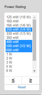

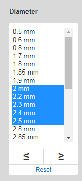

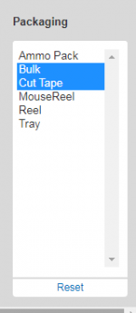

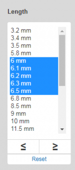

I tell Mouser's parametric search engine that I am ONLY interested in viewing resistors which
Images below.
_
- are in stock today
- are rated 250, 400, 500, or 600 mW
- are the standard length and diameter for 1/4 watt resistors -- NOT those overgrown monstrosities that KOA Speer sells thru Mouser
- are packaged in cut tape or loose in plastic bags ("bulk") but not Ammo Pack like the picture in post #1 of this thread
If you look at radial capacitors, and the vertical-style of mounting to conserve space, you'll see that those resistors are also vertical style, with two leads pointing down in a parallel fashion to the board as well.
So yes, they are designated as radial (style).
- are packaged in cut tape or loose in plastic bags ("bulk") but not Ammo Pack like the picture in post #1 of this thread._
