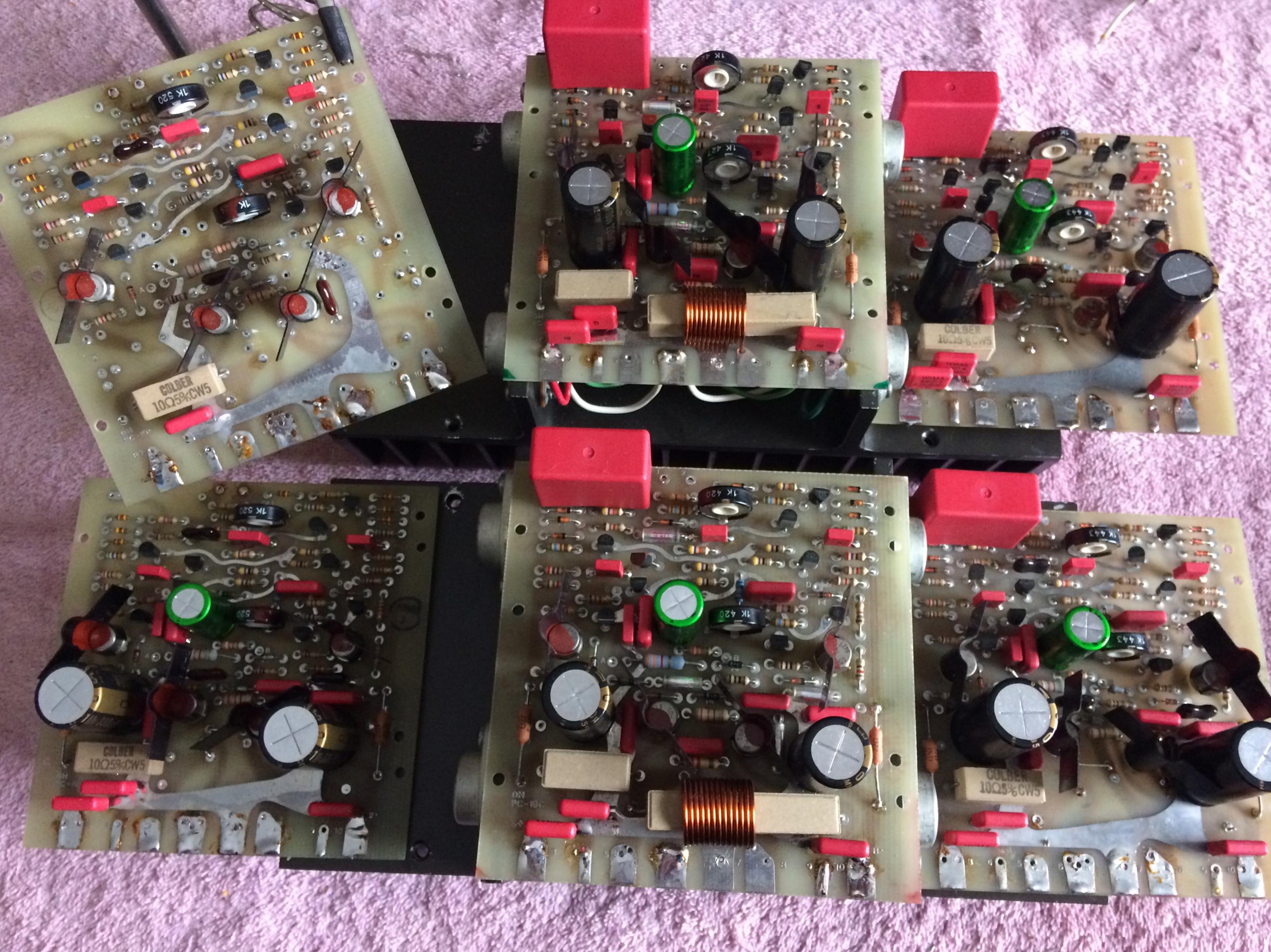

I really would like you to post up some details of your input board mods. I think these boards are begging for film.
(more of) optimizing the parts
I like what you did there. When you swapped out the blueberries for the Wima films did you stay with stock values? How about the single BP?
Thanks man!
Background - some context
I usually try to build and/or modify in groups of 3. Successively "leap-frogging", each step, each amp, then sum the collective changes of the 3 slightly different builds into the 1 final build... they start as a baseline, all built the same, all sound essentially the same or close to one another, it is easy to navigate meaningful changes / improvements.
I was not really trying to modify (the base circuit) an other wise good [for its day] front end design, but to work towards greater neutrality, that which I know can be possible. I *did not* change the values on the film caps. And (now) use the larger 330uf/100v cap in the driver stage, it will fit;
I was trying to "standardize" the stock Hafler PC19 (as shown) replace all electrolytics, passive parts, use silver micas below 1000 pf (get rid of cheap parts) I do like the Wimas *a lot* in scale of economy, transparency, consistency = I can / do stock every value and lead spacing for clean build practices.
The MUSE BP cap in the feedback loop, essentially stays the same value. 470uf, slightly tighter bass, 1,000uf slightly deeper bass (of course system dependent) I tend toward 470s, but like both.

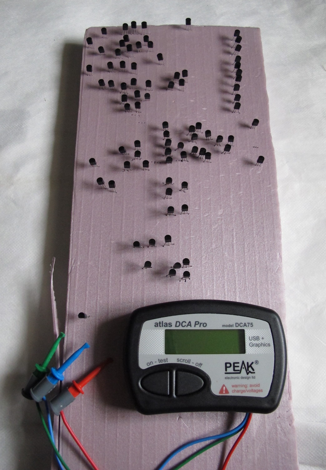

**The image (as an off shoot / tangent) Before Musical Concepts PA7 entered the equation (I owned / was using 4 sets of PA4) I was beta matching front end transistors for the PC19 boards ~ I have not give up completely ~ yet. I would have rebuilt the PC-40(s) from the 600 and 280. But they have too many obstacles / for me, problems... time is much better spent/server elsewhere.
~ I want to emphasize this ~ I [usually] am not trying to redesign an already good design (or I would not have owned it)... as much as optimize it and get beyond many budget driven limits of the designs, while prolonging its useful life.

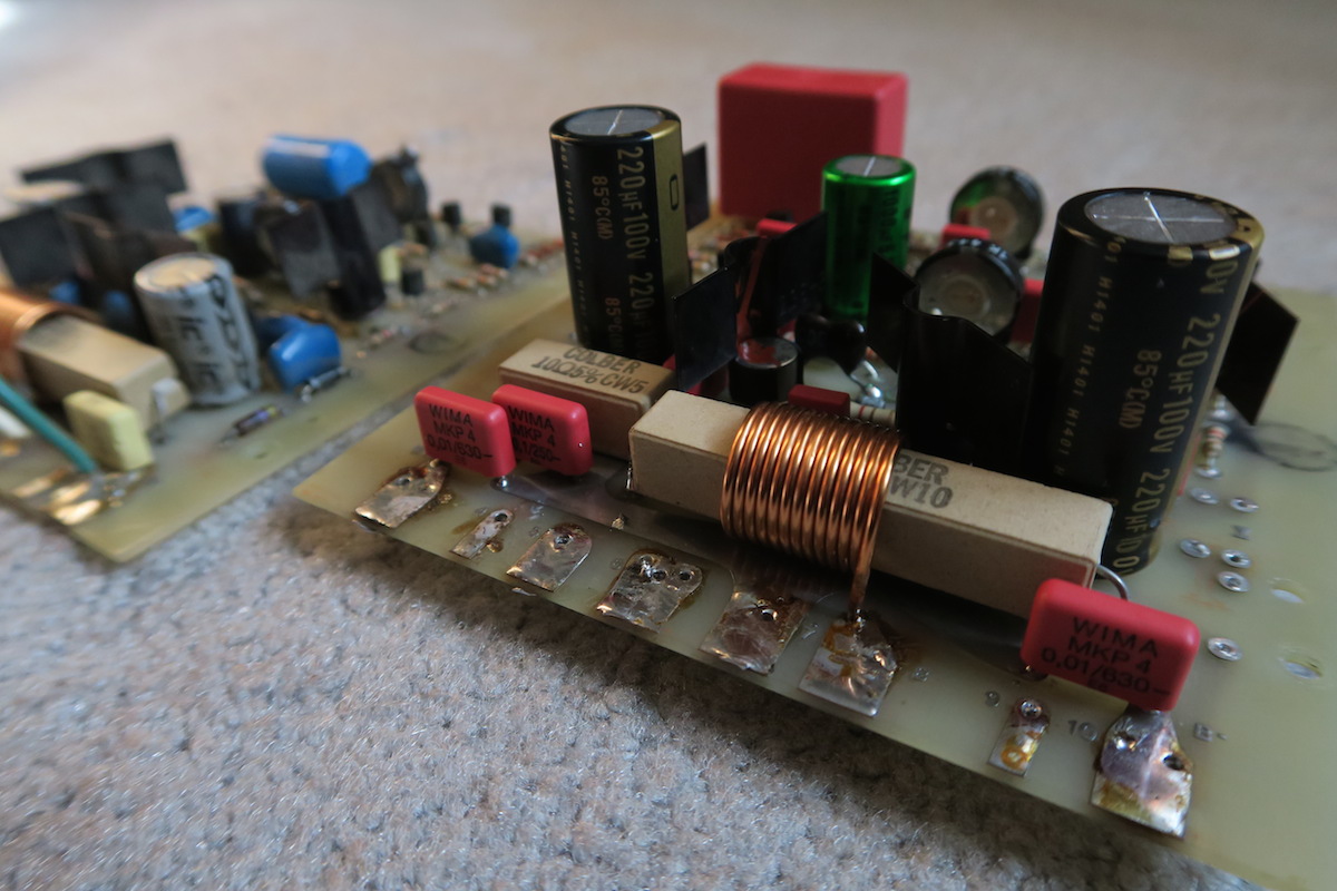

Are you talking about the PC19 or the PC40 for that one? I saw you had the 220uF/100V in your pictures for the PC19.
As far as the BP, if the 1000uF means getting deeper bass, thats what I'll stick with. I noticed the parts list calls that cap a 6.3v but both PC40 in my amp have the 10V part instead. I used the 6.3v caps I had on hand, I doubt that will affect anything since the circuit is designed with that value.
It applies to "to the nature of" and base design of their circuit. 6.3, 10, 16 will all work. ~ BUT ~ use the very best part possible. Nichicon MUSE is hard to beat and this cap will influence the overall transparency (nature) of the amp.
(at the time) I used the 220uf, a 15mm cap, already tight... by finessing surrounding smaller parts during replacement... the 330uf fit, by carefully repositioning the driver stage heatsink(s) on PC19 boards, as shown. There is plenty of room in the PC40, I just looked at it. The 330uf/100v MUSE is impossible to beat, and not separate supply is required.

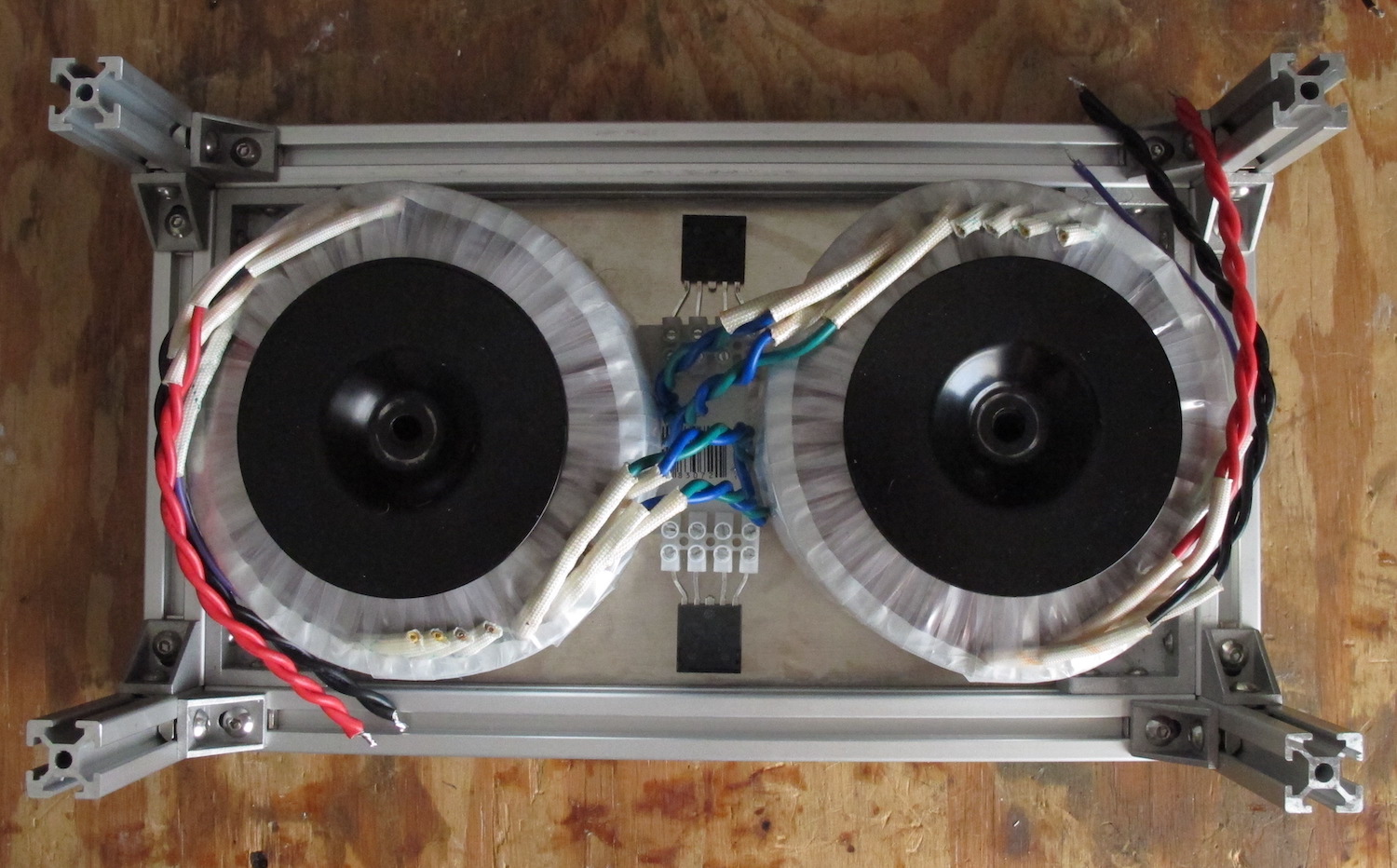

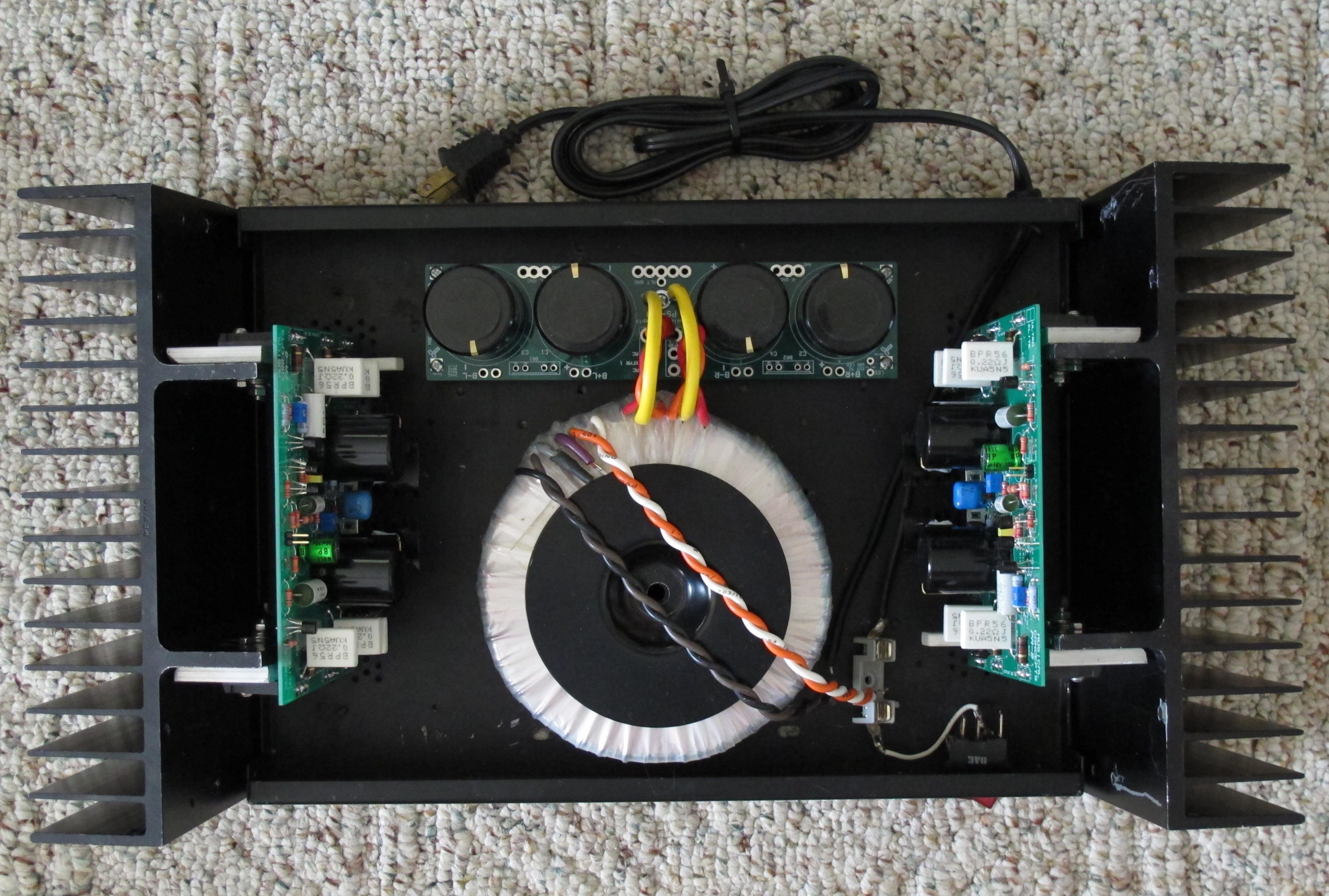

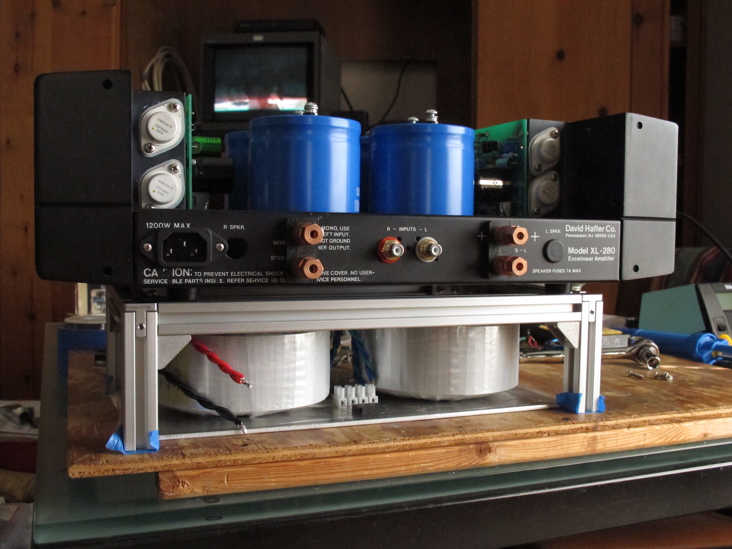

Power modules on heatsinks. Toroids, caps
cap banks. When this hits me.
Someone mentioned something here... TYTY
"Franken XL280" with my version of
A ROBUST POWER SUPPLY
There simply was not enough room
to do what I wanted... DH500 on a
200 series frame / body.
As SILLY as this may look
I am building it.
Where I can find the right values and the surrounding parts will allow it, MUSE is my go-to brand.
