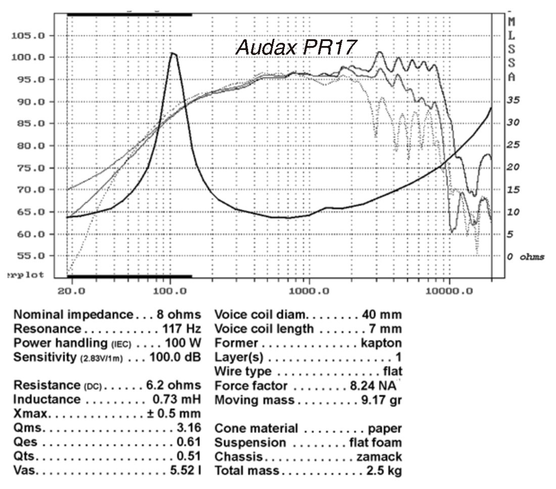

The question of using a larger Alpairs as a mid-range driver was asked by member Wallacefl:
"any thoughts about which 10 is better/more transparent say 250hz-7khz...I am thinking of trying my own variation of the Unifield 3..Dayton woofer on the bottom and ribbon tweeter for the top. I already have the 10.2 and thru the midrange it seems to be very bit as good as my Seas w18e!"
Dealing with this issue is relatively simple at first glance. Taking as an example member Murphy's first love, the 6.5" Audax PR17, its output places this unit firmly in the "mid-band" driver class, as described by its maker. Its usable frequency range will likely be from 1-kHz to 6-kHz (allowing for some roll-off for the cross over). Its frequency response looks quite nice in this spectrum but like all drivers, its not flat from 3-kHz up, the data (see makers graph) appears to be smoothed. This variance in its upper frequency response maybe an issue for some, but I think its designer's intention is to trade some stability for increased sensitivity by reducing operating mass, something I've done with the later model Alpair drivers.

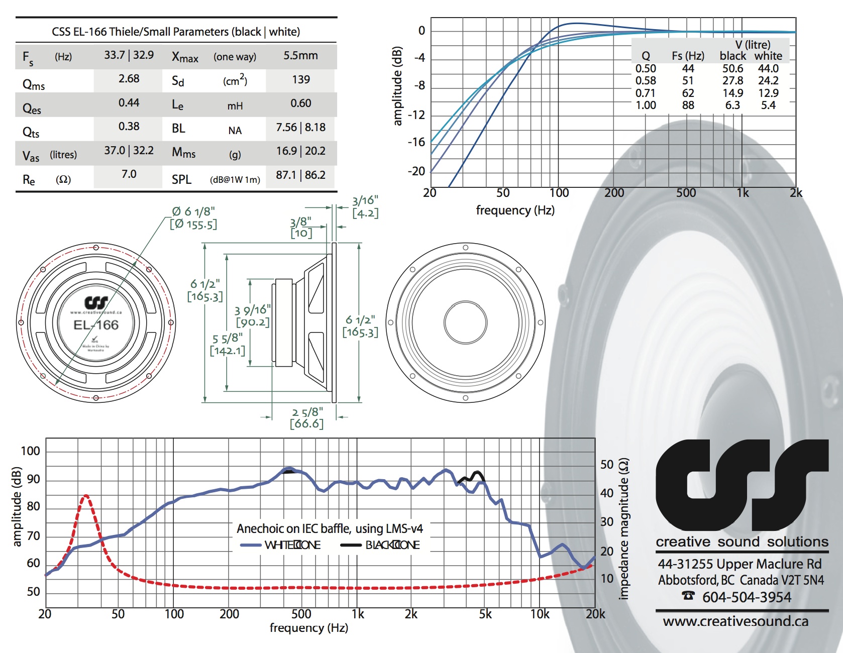

Looking at the Woofer No.6 (EL-166), also a 6.5" driver that falls inside the "mid-bass" category, but one that comes very close in usability in the mid range, shows its upper usable range to around 5-kHz, relatively flat, also on smoothed data (see CSS data pic). The advantage of Woof No.6 is its ability to go lower, thus making easier to match with much bigger bass drivers (if needed).

In terms of comparing mid-band and and bass-mid drivers to Full-Ranger's when used only for mid output in multi-way applications, make sure you treat the Full-Ranger fairly by applying adequate filtering to properly match it with the woof and tweeter either side of the selected mid-band. Those Full-Rangers with rising upper band responses may require allot more filtering effort to create a good match to a tweeter.
As regards which driver type makes the best mid-ranger, this is purely a matter of personal taste having applied the skills needed to do descent filtering and get the box properly sorted.
