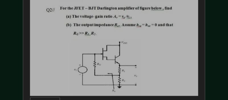

Maybe a normal or Sziklai (compound) darlington (i. e. by using an additional BjT) reduce this 4rd and 5th harmonics.
check out the attachment and
https://sound-au.com/articles/cmpd-vs-darl.htm
OTOH - I doubt, that a bit higher values for 4rd and 5th harmonics are audible.

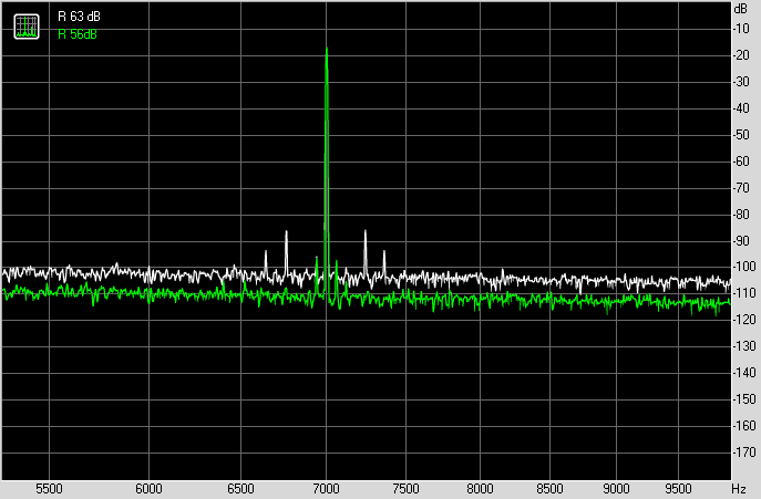

Thanks for the idea. My thought was to take two 2sk170 in parallel with separate source resistors for J1, and to reduce R1 accordingly.
I thought that additional distortion shouldn't be a big deal, but in comparison with a lower gain version it sounded very dull. Bypassing R2 also reduces input overload capability in half to around 2.5mV.
Here are detailed reports.
