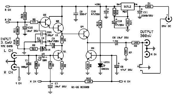

As above: is there any possibility to adapt OBH-8 circuit to MC cartridges? Any comments is welcome.
Ludwik
Ludwik
I assume this phono amp is MM only?
If so, there's no real way to 'convert' it to MC, as these MC-buggers need much more voltage gain (with the exception of high-output MCs, but in that case a MM-stage is already perfectly suited).
Of course you could use an input transformer.
Have fun, Hannes

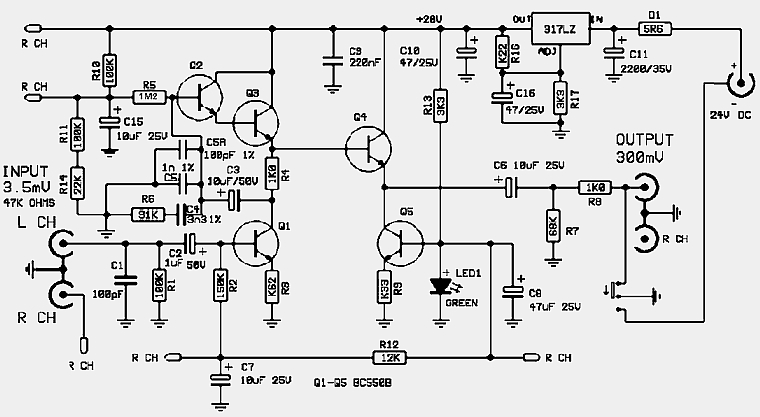

Here is OBH-8 circuit diagram. Any comments?
Yes... Can You upload in a better resolution 🙂 I'm about to get one myself, and would like to see if there are any chance of improving it.
Best regards
Ebbe
Exactly this topology also used by the Cambridge Audio phono modul for the integrated amp "Atac 3" and the "A3i". It sounds very fine. Because this modul uses a SRPP, you must add for moving coil cartridges with low output (200-400uV) a MC head line amp (gain approx. 10 times). I recommend a used JC-1 from Mark Levinson,OK, I try.
http://www.zenn.com.sg/ML_JC1.JPG
for MC cartridges >500uV output voltage (medium- and high output) gain factor of your OBH-1 must be enough. Perhaps a lower value of input termination resistor you must choice (mostly arround 1-2 kohms).
From the low cost MM RIAA preamplifiers this is one of the best sounded, that I know.
As Alex Nikitin said, it is possible to raise voltage up to 40V and changing R13 to 1Watt. It will double the output voltage and gives ~70dB gain.
There is another edition of OBH-8 - special edition with jfet.
http://obh-8se.narod.ru/obh8SE_S.jpg

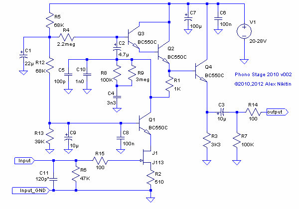

Some while ago I've published the "2010" version of this circuit - specially for DIY.
Simple Phono Stage 2010
That version can work with either MM or MC cartridge. For a medium-output MC cartridge (~0.4-0.7mV@1kHz) the input FET J1 should be 2SK170BL, R2=68 Ohm, for a low-output MC (~0.2-0.3mV) on top of these changes R2 needs to be shunted by 1000uF 6.3V quality capacitor - that doubles the gain to ~65dB @1 kHz. The input resistor R6 should be chosen for the required cartridge load (100 Ohm - 1kOhm), R15 replaced by a wire link and I usually use C11 = 1nF for MC variants.
For input FETs a selected pair should be used.
Noise levels in this circuit are very good both for MM and MC.
Cheers
Alex

Why do you need to use larger capacitors in the RIAA network? This circuit is nicely balanced and it would be not easy to change the values without some drawbacks.
And another question: why is the emitter current through Q2 not defined by a resistance, rather depends on the Hfe of Q3 ??
For me it sounds better this way 🙂 .
Cheers
Alex

Larger capacitors could be actually more microphonic and more problematic in general. I prefer polystyrene capacitors in the RIAA network and had no problems of this kind with these. With a good layout and quality components this circuit is capable of a very good sound quality, far surpassing it's modest cost.
Cheers
Alex
Cheers
Alex
Which parts are determine the line gain factor after remove the RIAA network consist of C5+10/R8+9/C4 ?
One part is the resistor R2 + the forward transfer admittance.
