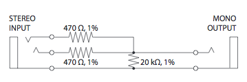

What I did
This is what I did in same app as yours. I didn't have the values shown and used 680R instead of 470 and 22K instead of 20K.
Instead of using a stereo and mono 1/4" jack as shown in the diagram, I used two female RCA connectors and one male connector to make the wye. It worked well .
