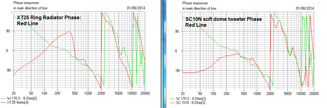

You are not imagining that the XT25 ring radiator sounds cleaner than a soft dome. It's measurable in the phase response, with a 3kHz crossover and a 6" bass here, which is more linear, and hence has less stored energy, group delay and resonance.
It's because the centre of the spherical soft dome is effectively pinned, so doesn't flap around uncontrollably. 😎
