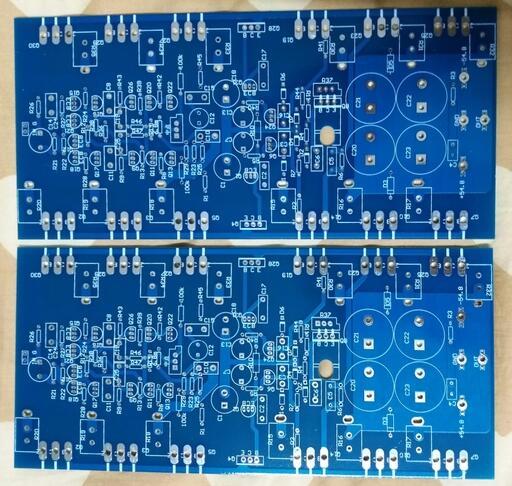

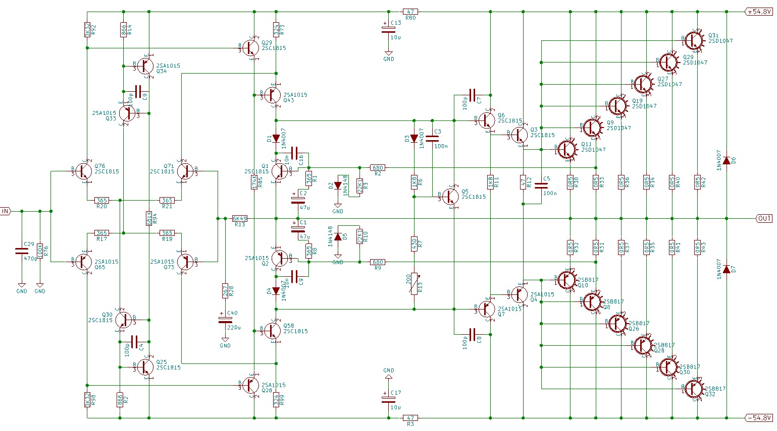

Suppose this thread is dead by now - but on Taobao.com there is a mc602 clone for sale. Unbalanced input and seemingly without output transformer.
So maybe not a true clone, close enough that I bought myself a couple of PCBs. Made a quick drawing and it seems to be true to the original.
Note that the transistors shown are just available models from KiCAD which I use.
