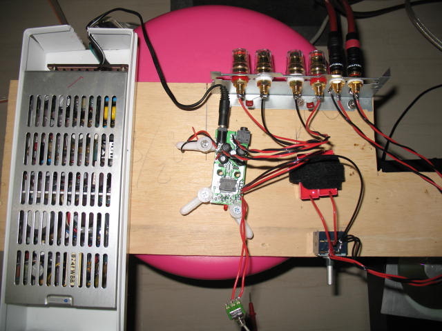

Hi folks,
Need your advise.... Thanks to the excellent instructions on Mike Mardis's website, I have successfully completed the "stealth" mod. 😀
BUT... for some reason, there is this constant "hissing" sound on the speakers. It is really faint (barely audible unless ears next to it) and does not increase with the turning of the pot (I'm using 100K Alps Pot). But, the "hissing" sound does get real loud when I touch the pot. I tried touching the cap and cables... no sudden amplification.
I'm using a single ground cable to the pot. It is wired to both L & R terminals on the pot. The ground from the RCAs then tap from this same point on the pot's terminal.
I have since resoldered the terminals on the PCB and ground cables on the pot. But does not make any difference... :bawling:
Anyone has similar encounter? What else do I need to check? 😕 Thanks in advance...
Here goes.... first time posting pictures.. hopefully it comes out fine... thanks!
Btw, I read in one of the thread that high DC offset is bad. It should not exceed 100mV. How do we measure that? Probe the +ve and -ve of each set of speaker binding post? What can we do if it exceeds 100mV? Thanks!

Hi Rob,
Low level signals refer to the input? I will try using copper braids. Does this goes back to supply ground (as in 110/240v earth), the 12V ground (or 0v), or the digital ground that the inputs are going to? 😕
Chances is that I cannot shorten the cable anymore coz I will be re-housing this into a fairly long wooden box... 🙂
Do I need to shield the output/speaker cables as well?
Thanks!
Hi
I assume you mean by "copper braids", the shielding around the cable. Just connect it to the same place as the existing black wires. Shielding the input leads should be sufficient as long as you keep the speaker leads well away from them.
Cheers
Rob
Rob is right, you need to clean up your wiring. Keep everthing as short as possible and use sheilded cable for the inputs. Keep the speaker wires away from the input wires.
As far as I can see, all the connections are correct.
That's a mighty big power supply you have there!! 😱
Heh...heh... that's a SMPS I bought off some second-hand shop.. think is a 75W power supply. Comes with both 12v and 5v... I tuned the pot within the SMPS to supply 12.8v. So far still hanging on... 🙂
I will try the shielding of the input cables first. But strangely, how does my hand touching the potentiometer's shaft (I have yet to put in a knob) or it's metalic surface amplifies the ringing sound? 😕

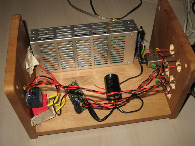

Btw, here's a pic of the new "housing", with integrated SMPS, using an input receptacle with EMI filter. 😉 Still "al-fresco" style... easy to change components. Will put a cover after that. 😀

okay... last ditch efforts to rid the ringing sound... 😛
1. Changed C10 to 2200uF Elna (is this too big?)
2. Changed the stock inductors to some other bigger coil ones...
- measured at the shop... was 11uH... how does it being a little bigger than the 10uH suggested by Tripath affect the output?
- the highs seems a little "truncated"... less dynamic too... 😕
- What's the purpose of these output inductors? Noise reduction?
The sound seems a lot more tamed... actually, it happens alot lesser now.. though it still comes back once in a while... similar loudness as before when it happen actually... will run it a little longer before changing anymore stuff.... 😛
Thanks...
Hi folks,
The ringing sound seems to be solved liao.... tried quite a few things until stumble on the ONE... 🙂
1. Shielding + grounding for input caps (wima mkp)
- improves but still significant
2. Shielding + grounding for pot
- waste time... no difference!
3. Attached a grounding cable to silvery top of cap C10 (onboard cap)
- Clears up immediately!
Really strange... before I change the stock cap to Elna 2200uF CEW, ringing sound already there. Could it be 2 cases of bad caps? I will probably try another cap when I make more changes... status quo for now... 😛 Anyone experience ringing noise due to the same issue? 😕
