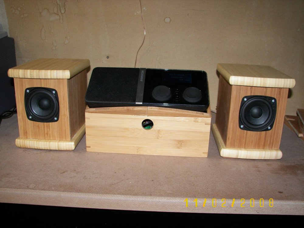

Was able to bypass the preamp, and built some bamboo cabinets for the 3" fullrange speakers. Picture attached.
The amp is now housed in a bamboo "letter box" (Tuesday Morning, $10), which also serves as a stand for my Freecom MusicPal streamer and hides the cables between the MusicPal and the amp.
The speakers are built from two large carmelized bamboo cutting boards (T J Maxx, $10), and four small "bar boards" (Tuesday Morning, $1.99 ea).
So, total cost for Tripath stereo amp and two speakers with pretty high WAF, about $60. Not bad, sound is about the same as the Sonic Impact T24 (see above), with the bonus of higher WAF and stereo separation.
Just need to add grilles - bought a yard of speaker cloth from Joanne Fabrics today with the 40% off coupon in the paper, came to $6.00. Way more than needed for this project, but who knows, I have caught the bug, so maybe more to come.
The speaker cabinets are sized based on my JVC FS-7000 system. Nice looking solid cherry speakers. I figured these speakers would probably work OK in a cabinet of the same design, and they sound almost identical to the JVC's. I used a 1" X 4" Port Tube from Parts Express to match the port in the JVC speakers. Now just need to match the nice curved grille...

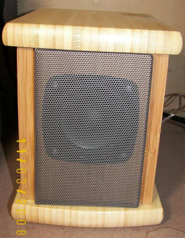

chicks said:Turns out the grilles were hiding in plain sight. The metal grille from the Psyclone proved easy to cut with tin snips, and fairy easy to shape, even with primitive tools (a hammer and bench edge). Doesn't look half bad:

The grille appears to be acoustically transparent. Here's a pic of the tinsnips I used. Don't remember where I bought them; years ago.

I found that a 1X4 piece of wood worked pretty well as a form to bend the grilles around. It was exactly the right width, and just cut it to length. Takes a bit of hammering to get them perfectly flat, but it works eventually.
Also flirted with using fabric over a thin plywood frame (spruce plywood from my model airplane building days). Didn't look nearly as good, the wife says that these grills have a more "modern" look.
Here's the pair after a coat of lemon oil:
