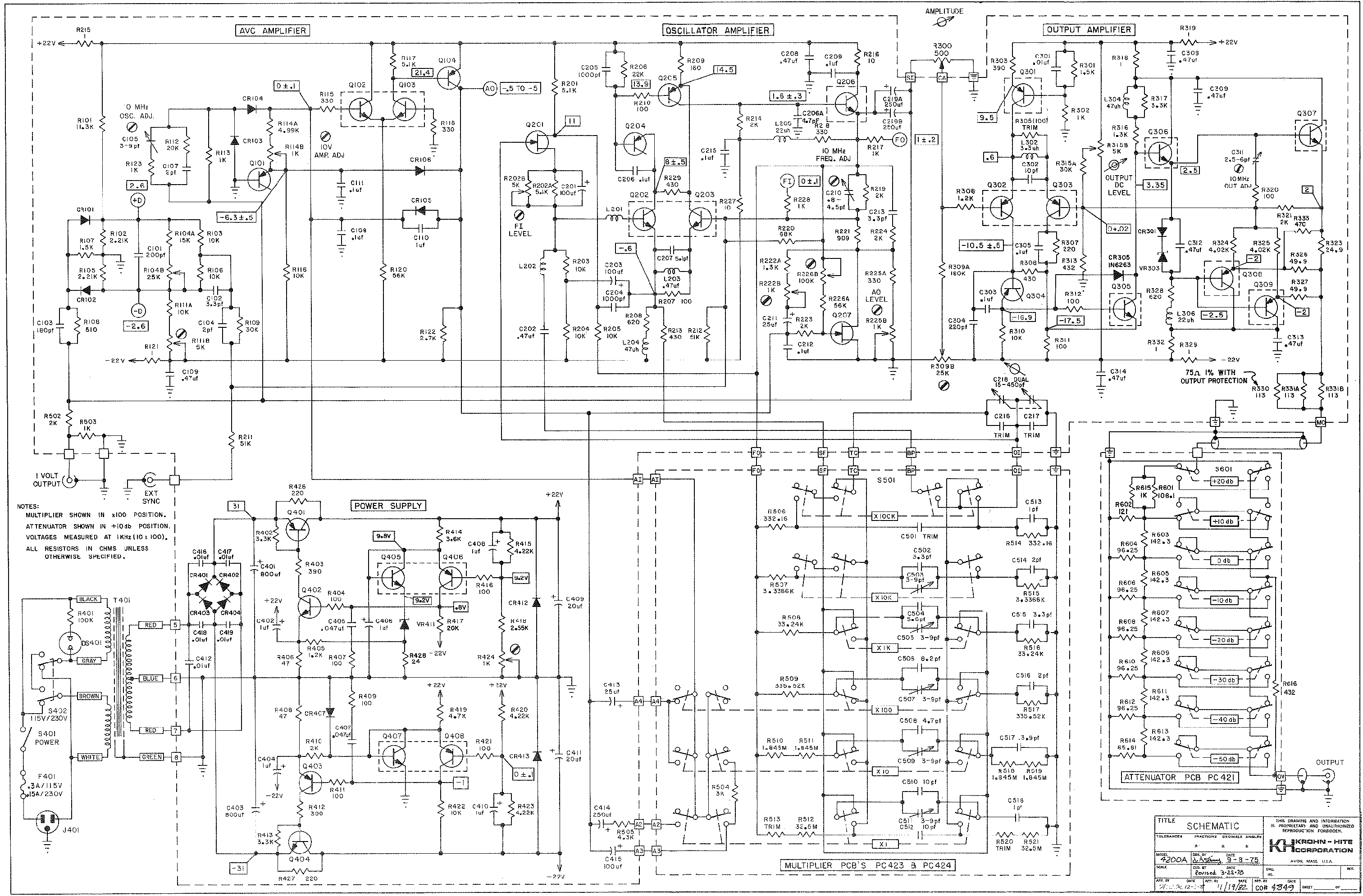

Hello
I finally found the schematic diagram of my Krohn-Hite 4200A.
How can I improve it to reduce it's distortions ?
Thank
Bye
Gaetan
Don't know that you are still following this thread -- Decide what characteristics of the 4200A you can live without. Don't need 50 ohm output Z? Raising the attenuator Z to 600 ohms or more will really help a lot. Don't need 10MHz upper end? Simplifying the circuitry for say 100kHz max frequency will also help a lot. In the end, not much else can be done. Having an oscillator that will deliver 10VRMS at 10MHz into 50 ohms is impressive and could be useful... But low distortion is not part of that set of qualities.
