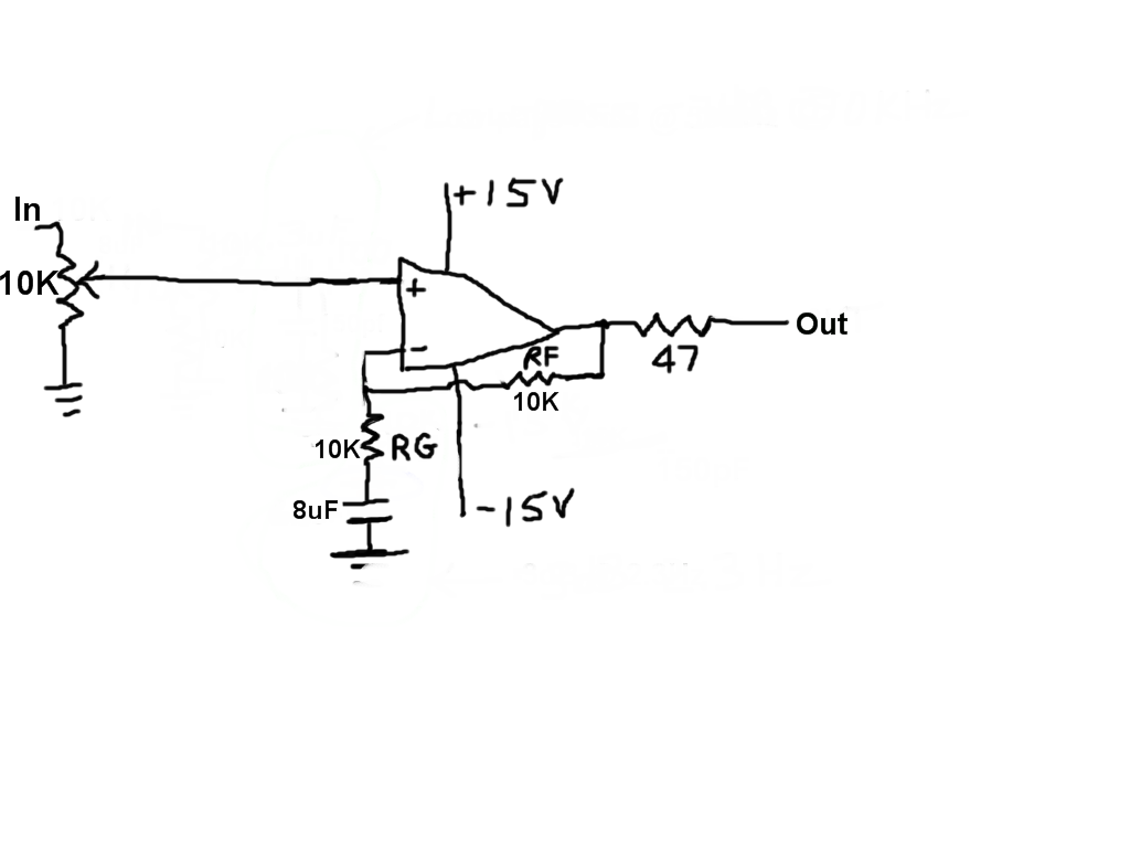

The circuit in post 57 has 20k on one input and 10k on the other, so input current will generate a voltage offset. Of course, using lower value resistors will reduce this problem, but you have to be careful not to load the source too much. Is this an appropriate opamp for this application?
OK, now does the + input see 10K now?
I, too, am wondering why a 50MHz, 10uA Iin part is being used for audio?

OK, so do I need to put a 10K from + to ground? If not, what do I need to do the circuit in post 57 so the + sees 10K?

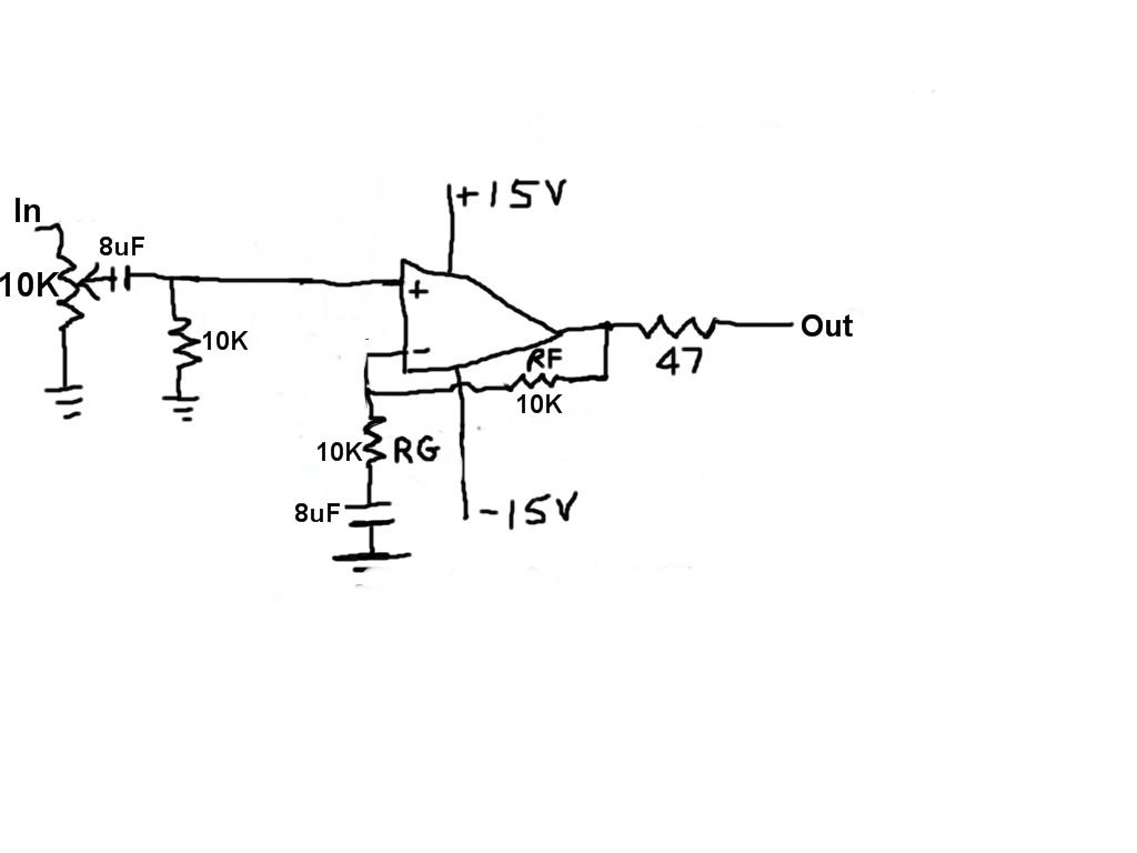

Put back the RF attenuating filter at the input.
I suggest you increase the 8uF in the NFB leg to 15uF, or 22uF.
Then you can experiment with the input cap to find what you want to hear.

OK, here's where I'm confused...won't adding the series resistor for the RF filter change the resistance of the + input unless both resistors' total is the same as Rf for lower offset?
Everything is a compromise and unless you greatly add to the complexity some interactions are inevitable.
Your circuit meets the requirements for offset. The 1k and 9k give a total resistive path of 10k to ground. The input cap (the 1.5uf) and hf filter cap (whatever value you choose) will not upset the DC stability of the circuit.
One practical point is that the wiper of the pot, in seeing 9k at the wiper to ground, will have its "law" altered. That's no bad thing and it means you can use a linear pot rather than a log one even though the values aren't really correct to fake a log law.
