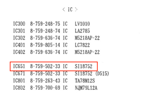

There are two picks from the Sony STR D-615 service manual to help in my question. My receiver (Sony STR-D615) started blinking "protect" after a power outage. The outage actually fried the surge protector the receiver was plugged into. I have never tested a transistor for short such as the one in the pics which has 5 terminals. I tested all of the transistors on the heat sink besides this one as they all have only 3 terminals. They all tested OK (at least not short). I would like to know precisely how to use my multimeter to check the one in the pics below...

The chip that you are referring to is most probably not a simple "transistor", but an integrated "Operational Power Amplifier", with 5 pins.
Or in other words, a complete power amplifier within a chip.
If I understand correctly, the pins are numbered as follows:
1: The non-inverting input of the operational amplifier
2: The inverting input of the operational amplifier
3: the MINUS supply voltage as delivered to the chip
4: the OUTPUT (to speaker) of the chip
5: the PLUS supply voltage as delivered to the chip.
If I were to guess, I would check if there is a short between the legs 5 (positive power supply) and 3 (negative power supply). If this is close to zero ohms, I would suspect a serious problem with the chip.
If between 5--3 you do not observe a problem, then ...
Then I would check if there is a short between any of the power supply legs (5, 3), and the output of the chip, the output that goes towards the speaker. If you observe a very low resistance between 3==>4
and/OR
4==>5 ,
I would suspect that one of the output transistors within the chip is fried short.
If you do not see evidence of a short between 3==>5, or 3==>4, or 4==>5, then I would maintain hope that the chip is intact.

This Sanken chip seems to cross to LM1875 or TDA2030A, medium power chip amps. The above links will give you the pinout and everything. It's +in, -in, -V, out, +V.
If the chip is still installed, the first thing I would do is check the DC voltage at R659, R658 or L651 vs. ground (use chassis or speaker (-) if nothing else) when powered up. Something in the millivolts is good, more than 0.5 V in either direction is bad and would indicate that the chip is indeed faulty. Follow the pin 4 connection to the Rear output if you don't know where these components are.
You could also measure the voltage across C653. If it's more than a few mV, something's really amiss.
If you can't get the unit to stay on long enough for a measurement, you could test for shorts between pins 4 and either 5 or 3 when powered off. Even if that turns out good, the chip could still be damaged in other ways. Temporarily unsolder one end of R660 to see whether that clears the fault. (You should have removed any speakers by this point for obvious reasons.) If so, bad chip. Otherwise, it's another power amp give you trouble.
If you need a replacement, LM1875Ts are still being made, it just seems to be a good idea to buy them from trusted distributors (Mouser, Digikey etc.) rather than random Chinese eBay sellers, as counterfeits abound.

Using continuity check between pins 3 & 4 I am getting a continuous beep from my multimeter. That indicates a short correct?
Probably. See what it says in ohms and in the diode test setting.
Is the chip still soldered in? Unsolder pin 4 and verify that the short is actually in the chip and not external. If so, yep, he's dead, Jim. Replacement options have already been discussed.
