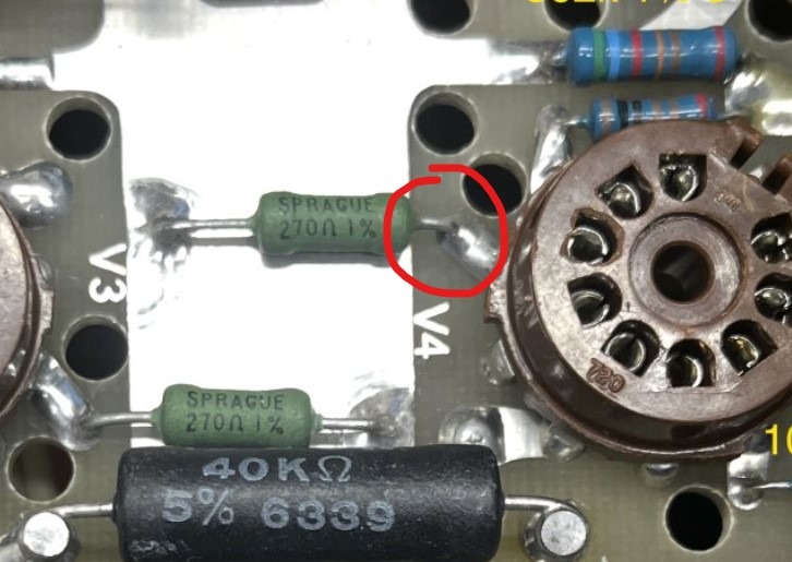

It's the phono input, especially the right channel. The 1k resistors seem to be the most "lively" when I spray them.

Let me see if I get this, somebody who couldn’t fix your problem told you you have a bad resistor, but they couldn’t find it or fix it.
I would first resolder all of the connections on the PCB. A bad solder joint is the most likely cause of noise.
The image you posted shows some not so good soldering.
Unplug the power cord first. With a warm temperature controlled iron you just remelt the joints at the same time as adding a very tiny bit of new solder. Preferably 63/37 tin/lead solder.
That should take only a few minutes. If that doesn’t get it, the next try is to swap tubes between channels. If not possible then identical tubes between gain stages.

I’ll try re-soldering, good idea. What’s the purpose of the tiny amount of new solder? Does it make a better “alloy” with the old solder?

Adding a bit of solder reduces the chances of a cold solder joint.

Based on the type of noise/distortion/etc, and the fact that swapping tubes didn’t help. Replacing resistors that reacted to the freeze spray was successful on another similar amplifier of similar age.
I never thought of reflowing the solder joints… replacing a resistor would have the same effect. Maybe the new parts didn’t even effect the outcome!

As far as the attached image can be trusted, I second what simon7000 wrote....
Oooh, thank you for identifying that! Now I have a better idea what to look for. Tomorrow I'll go resolder everything and see if it makes a difference. Would be lovely not to have to change any parts.
