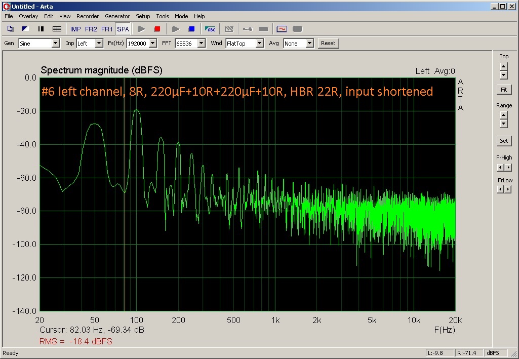

How can I reduce hum/noise in KT 88 PP amp?

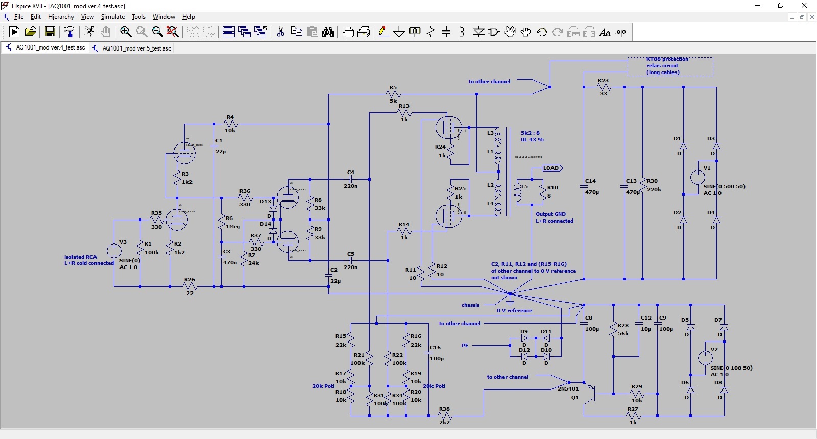

The original doesn't have a choke, the hum/buzz/noise was too high, therefore I took a chocke from a chinese 845 SE (have nothing else).
According to the majority of what I read, this position is as good as the one of the 33R (R23). Some claim the R23 position is better as there is capacitive coupling through the secondary. Others suggest to split the R23 in two, and use one half at R23 and one at L6 position.
The choke has 23R, it was MUCH easier (and safer) to realise the L6 position and it seems to work 🙂, but if you suggest otherwise, just tell me what to do.

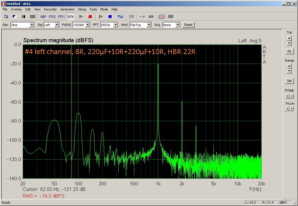

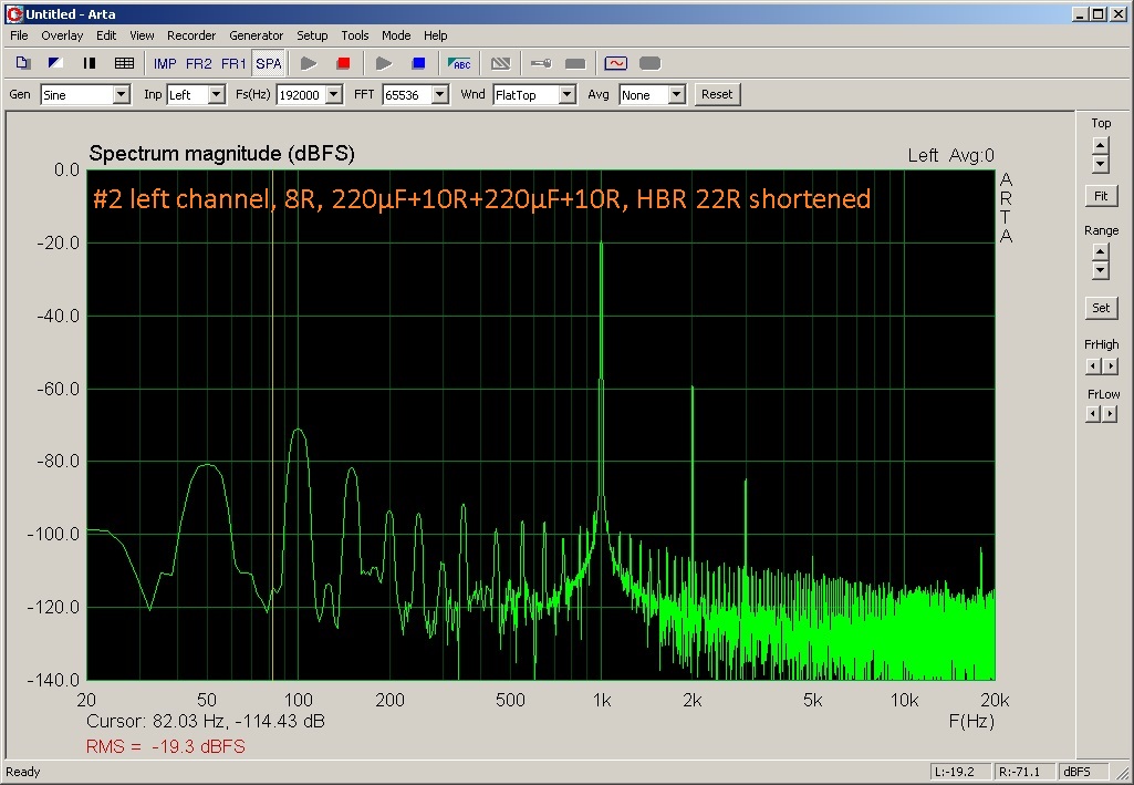

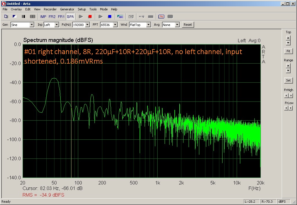

Are you able to go back to just presenting a spectrum plot where only the output stage is in the mix, and to step through making a change to the bias supply to get some confidence that the bias is not the main contributor to your hum.
Sorry, I should have done that already.

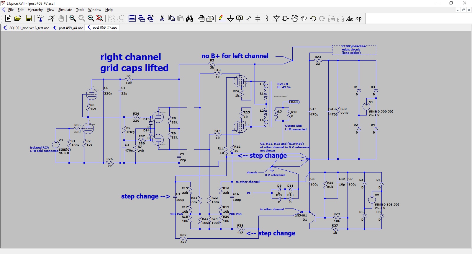

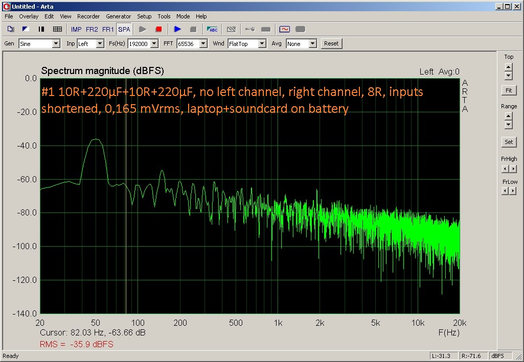

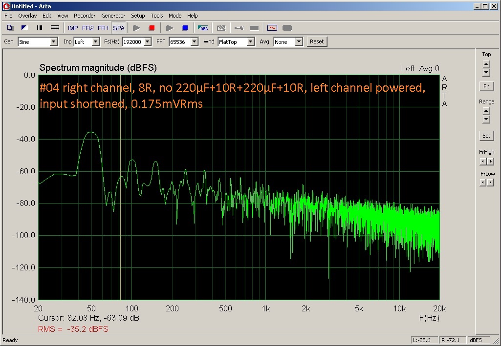

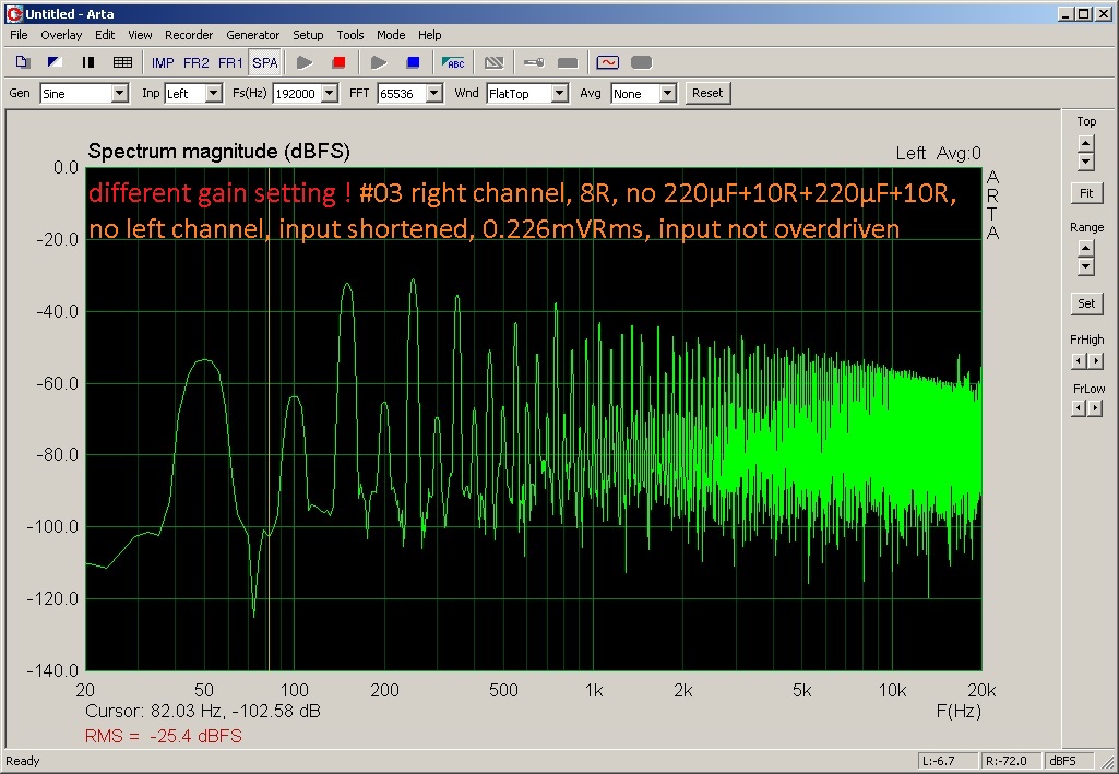

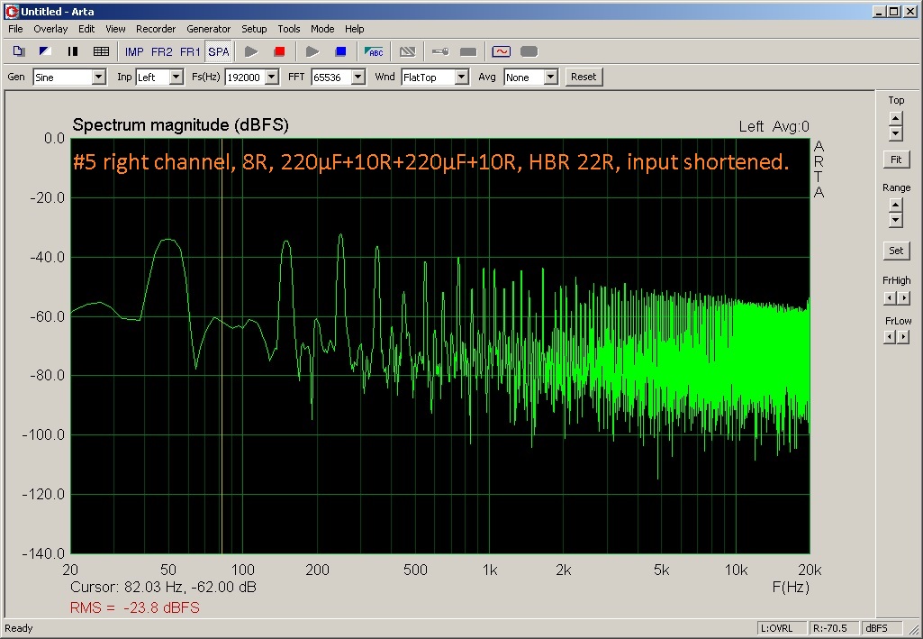

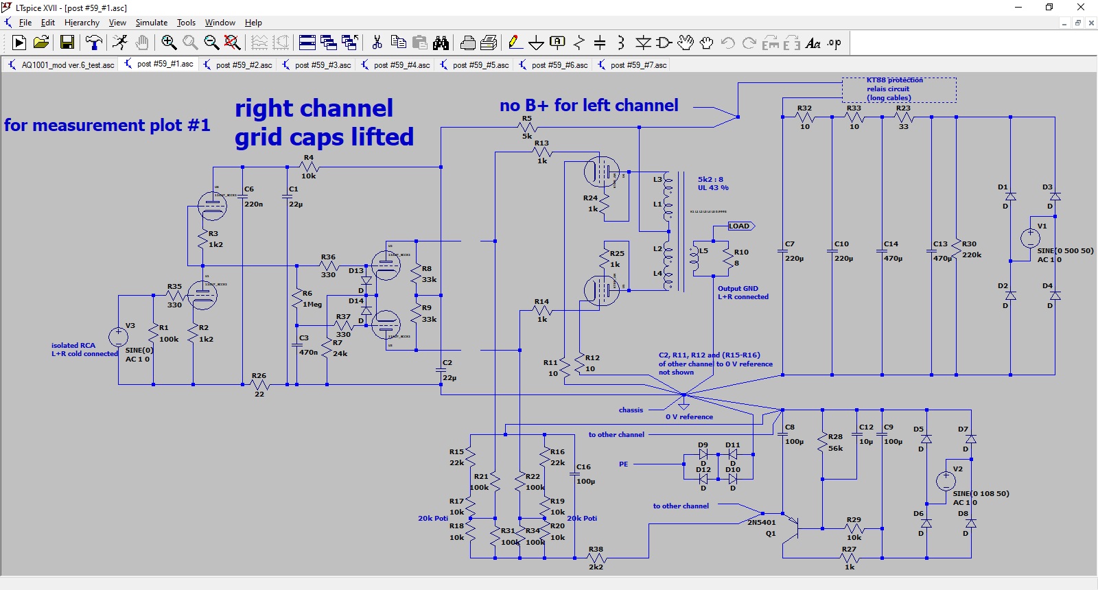

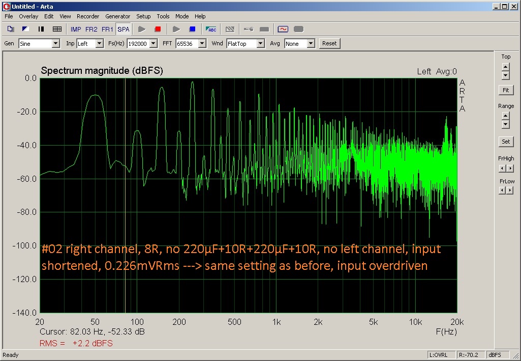

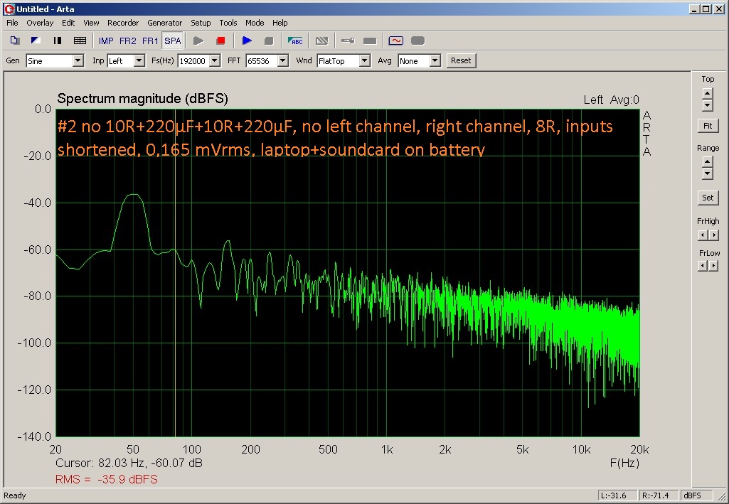

The amp has right channel without 120k / 2M2 local feedback and the grid coupling caps removed, standard bias, no KT88 in the left channel.
Taking into account that you suggested the mod, the sim confirmed the mod and comparing the measurements to the old ones, I didn't rebuild the bias (takes me about an hour for everything). If you think it is necessary I will do it, please advise, otherwise I just repeat - thank you !
The two last measurements are the old ones for comparison.

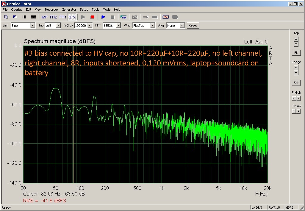

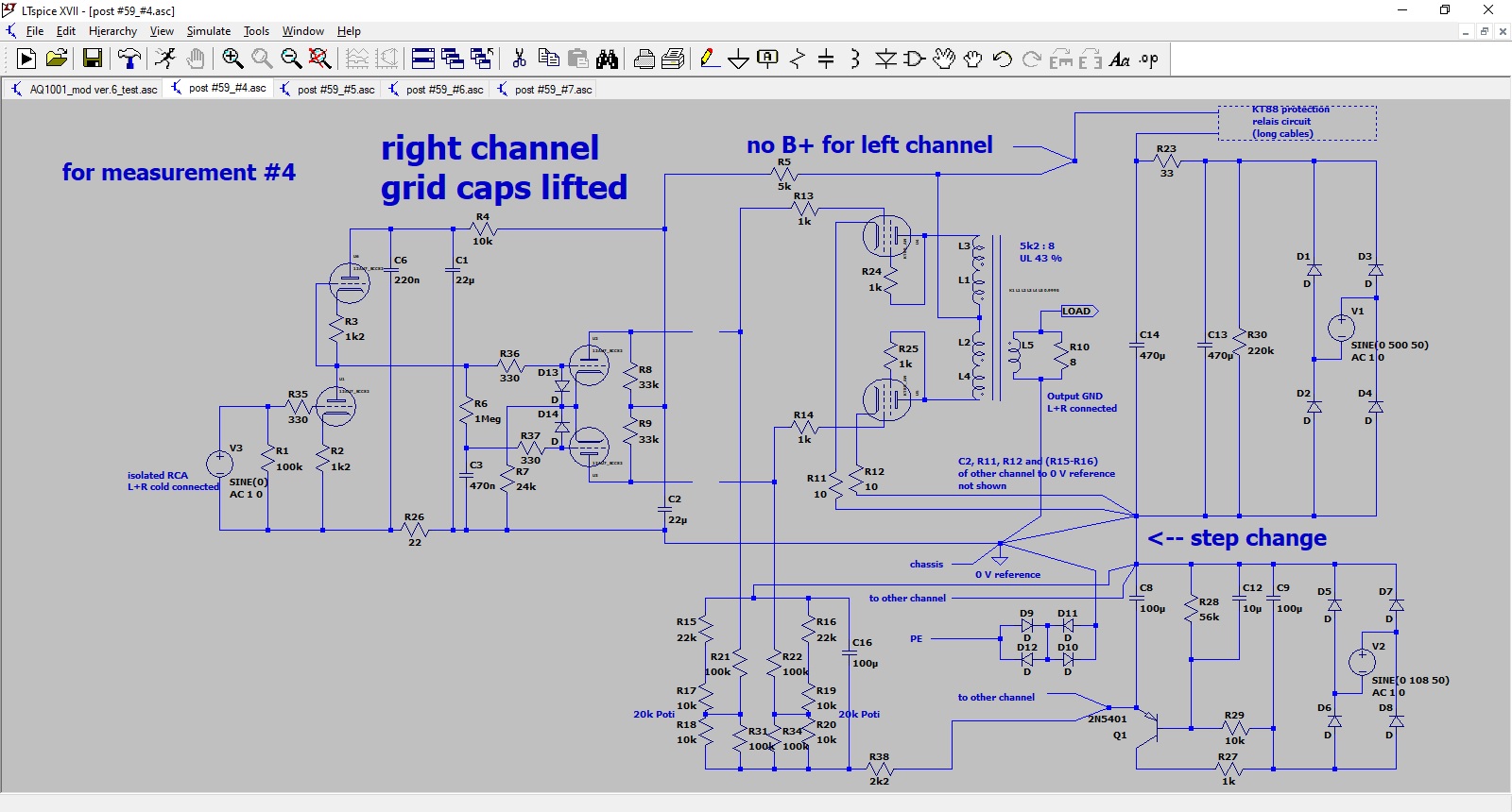

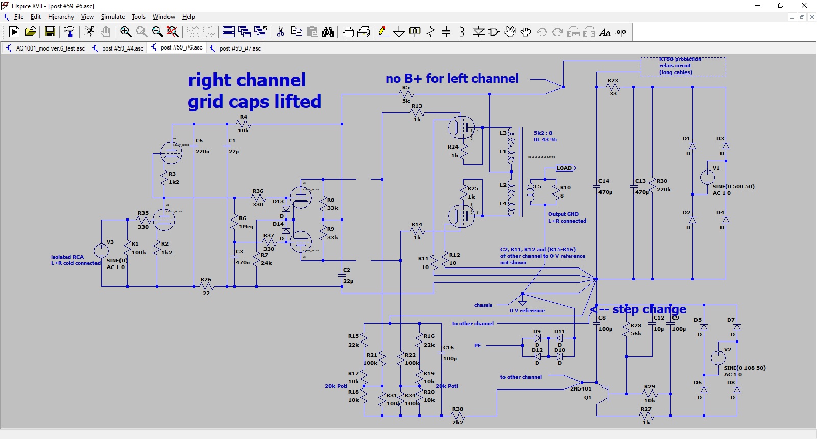

Apart from bias related hum, a step change to B+ related hum, and to screen related hum would seem to me to be the first steps to take.

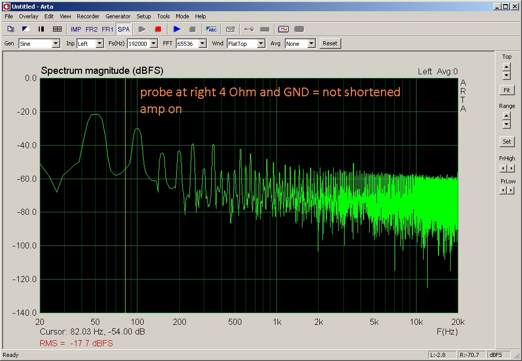

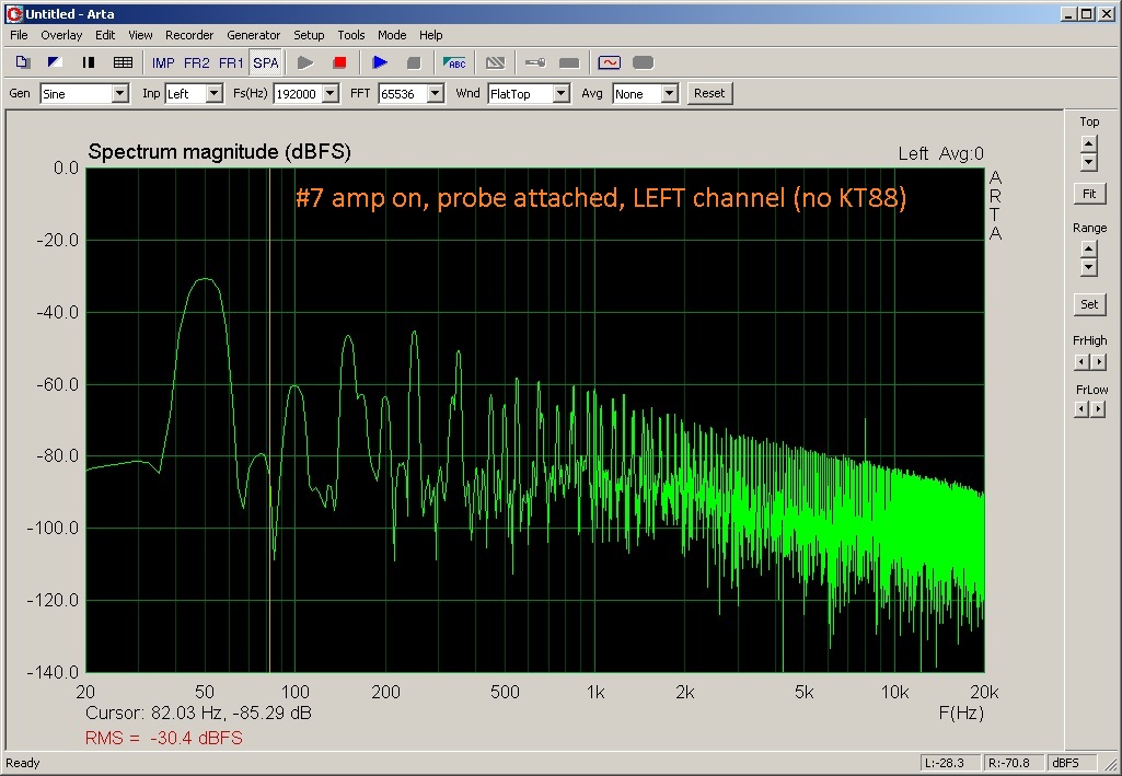

Oscilloscope setting 2ms, 5mV, 1:10 probe I get about +/- 150 mV steps on the bias worst case.
I can confirm the bias is 'jumping' opposite to the HV, if the HV increases, the bias decreases, just as if one would vary the mains voltage. The mains voltage is slowly fluctuating about 10 Vrms during the day(s). The short term variations seem to be about 100 mVrms, which would be about 50 mV for the bias, the osci is faster than the DMM (the DMM steps appear to be slower).

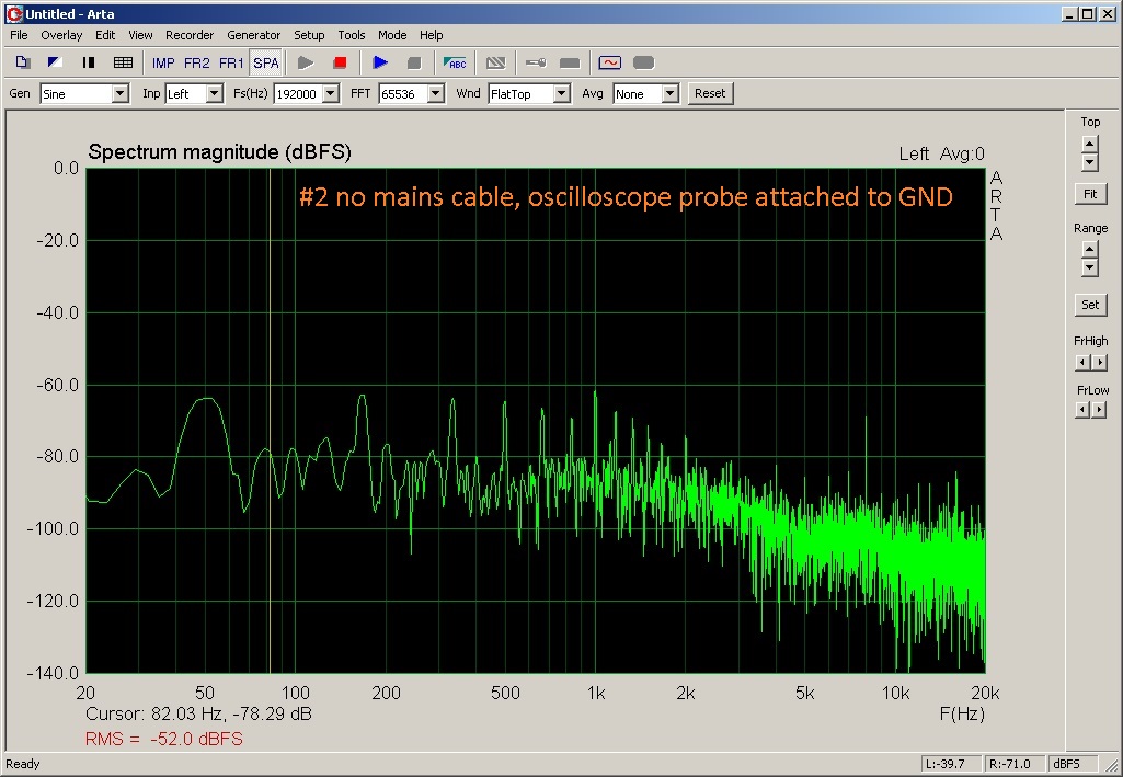

I am sorry, I don't know how or what exactly you want me to measure or modify, please advise.
If there is still significant hum being measured, then the focus probably turns to grounding, and to magnetic interaction between PT and OT.
While measuring I slided the pot on and off the PT which didn't show even a tiny change in the spectrum. The pot is made from 3mm aluminium.
Orientation is OPT-PT-OPT (90°) and the axis of the windings of the PT is pointing at the KT88s. Is there a number how big the distance usually has to be (the OPT and the PT pots have less than 1 cm spacing) ?

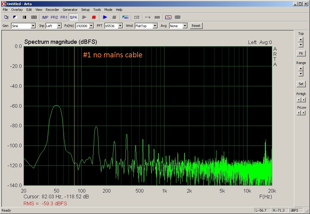

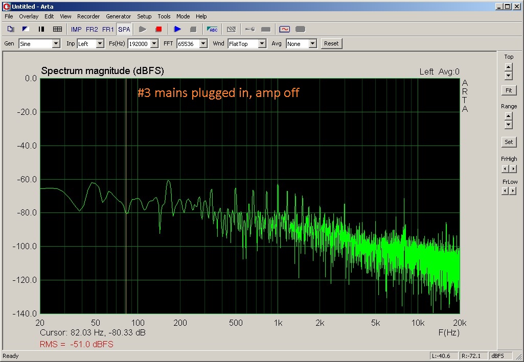

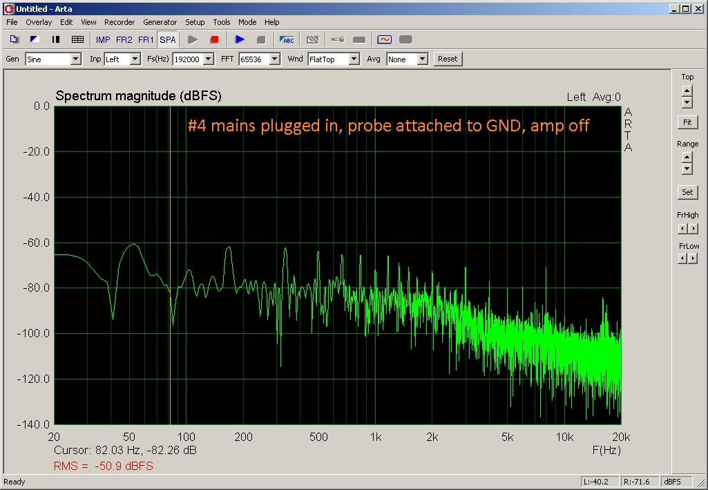

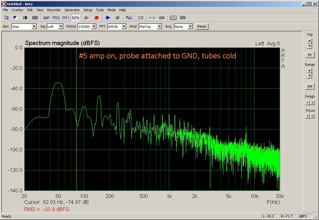

  • #05 mains cable plugged in, osci attached, amp on, tubes cold, right channel 8R.jpg

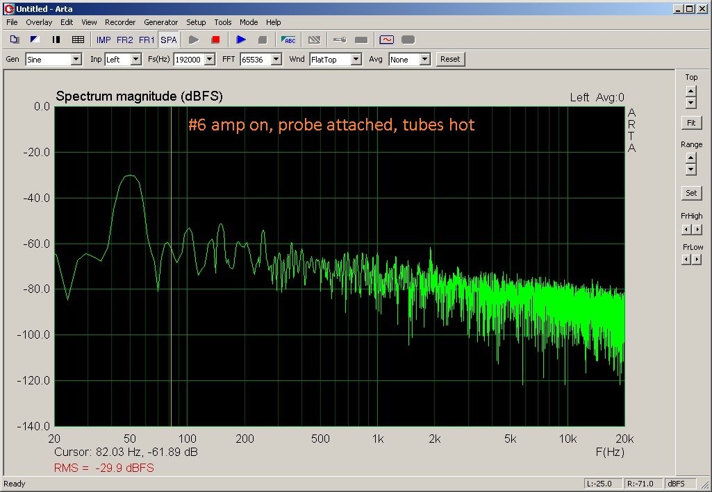

  • #07 mains cable plugged in, osci attached, amp on, no KT88, left channel 8R.jpg

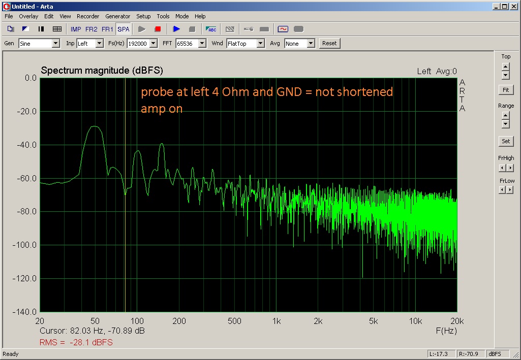

Sometimes Hum and Noise is caused by Ground Loops from, you guessed it:
The amplifier under test, and the measurement equipment (and computer if present).
Mains fundamental, Mains harmonics, switching power supplies, etc.
Even your CFC lamps, LED lamps, etc.
All these have have Conducted EMI and Radiated EMI.
Devices that meet all the EMI regulations, can still interfere with one another.

An example ground loop is from Amplifier, to probe, to scope/computer, to mains power of the scope/computer, to mains power of the Amplifier.
And no isolation transformer is perfect. It can still conduct high order mains power harmonics and switcher noise.

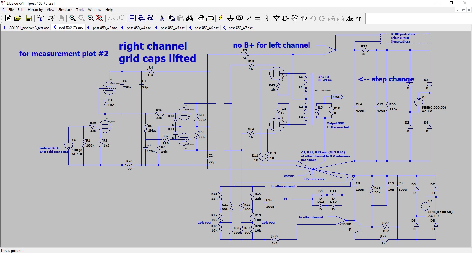

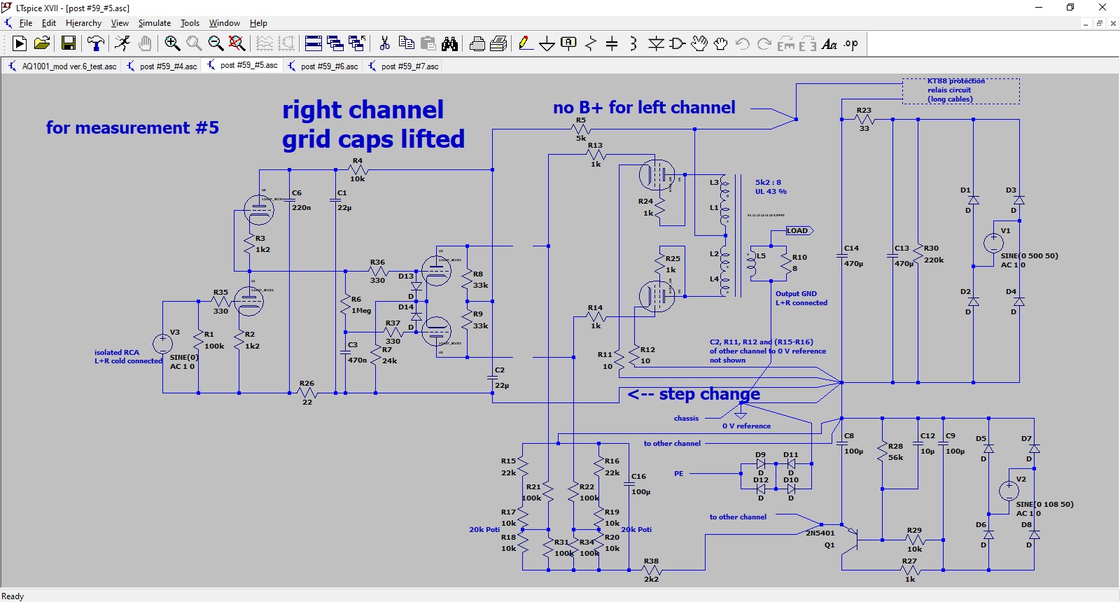

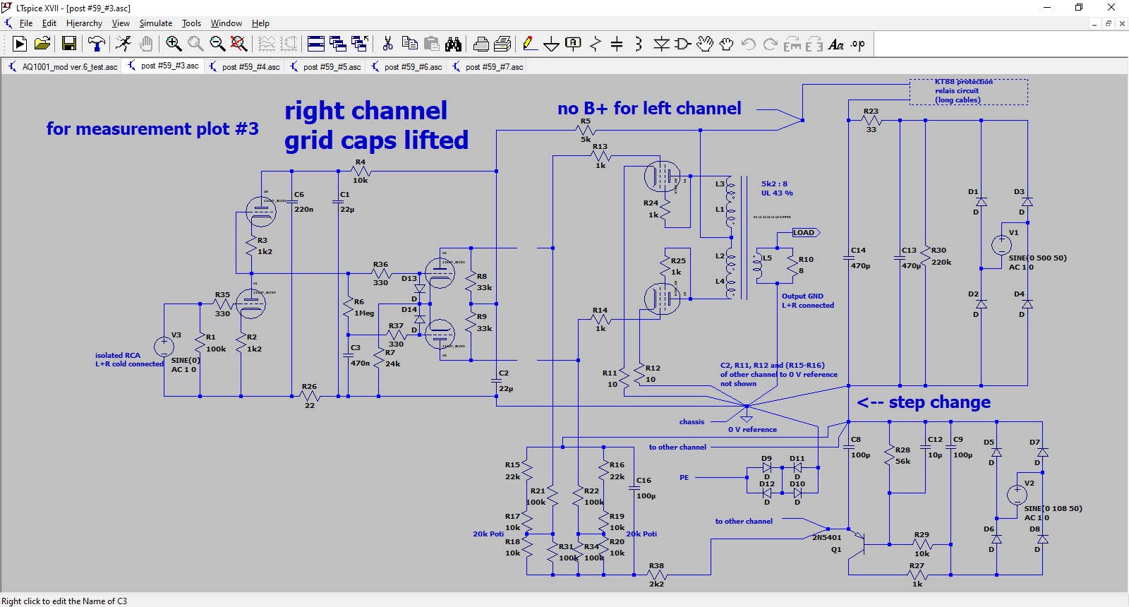

"The amp has right channel without 120k / 2M2 local feedback and the grid coupling caps removed, standard bias, no KT88 in the left channel."
Can you clarify which plot is the right channel speaker output for this configuration?
I could suggest that configuration would be a good 'base case', from which to do single step testing (ie. make only one change to a part of a section, and take a plot measurement and identify what if any change occurs to the plot).
Single step tests could include:
- doubling the final filter capacitance used for smoothing the bias supply.
- doubling the final filter capacitance used for the B+ supply to output transformer.
- making a temporary common RC filtered screen supply (ie disconnect the UL connections and take to the filtered screen voltage.
The above tests just aim to indicate if any one supply is introducing significant hum.
If there was no change to the plots, then the focus would move on to other possible causes.
I would suggest removing the L6 choke for the moment.
When temporarily connecting any additional filter capacitance, make sure the capacitor terminals connect as directly as possible to:
- the OT B+ lead
- the end of the 10 ohm cathode sense resistors
- the top of the bias pots
This is in case you have some additional common wire paths with your existing wiring that may be introducing hum.

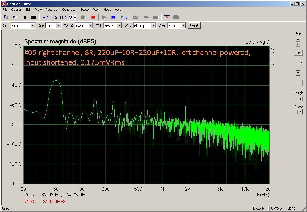

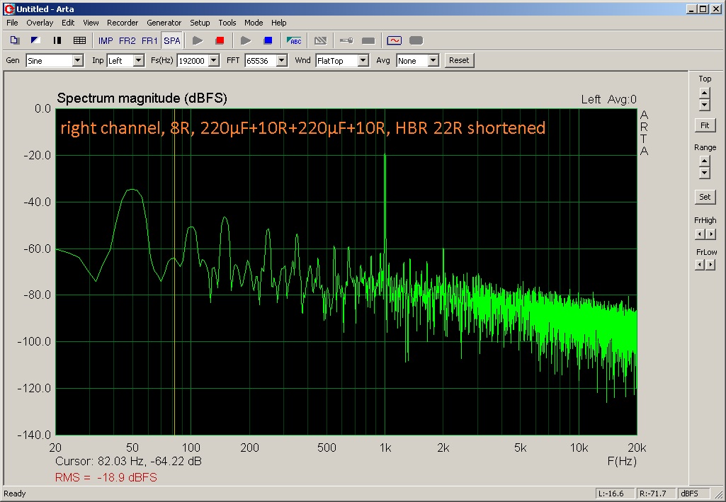

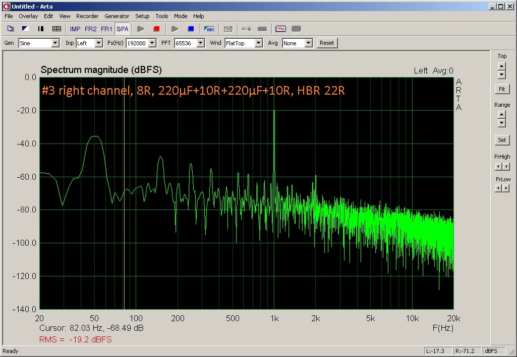

Sorry, I was lazy with the description. The first 6 plots (#1-#6 in the filenames) are right channel plots, #7 has left in the description as the two old plots.

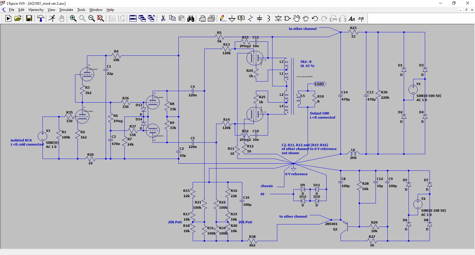

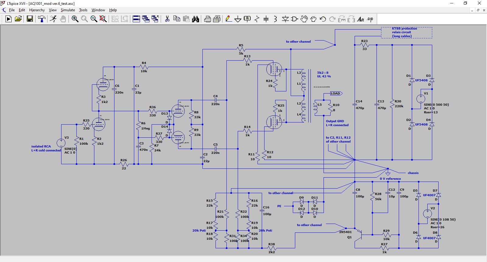

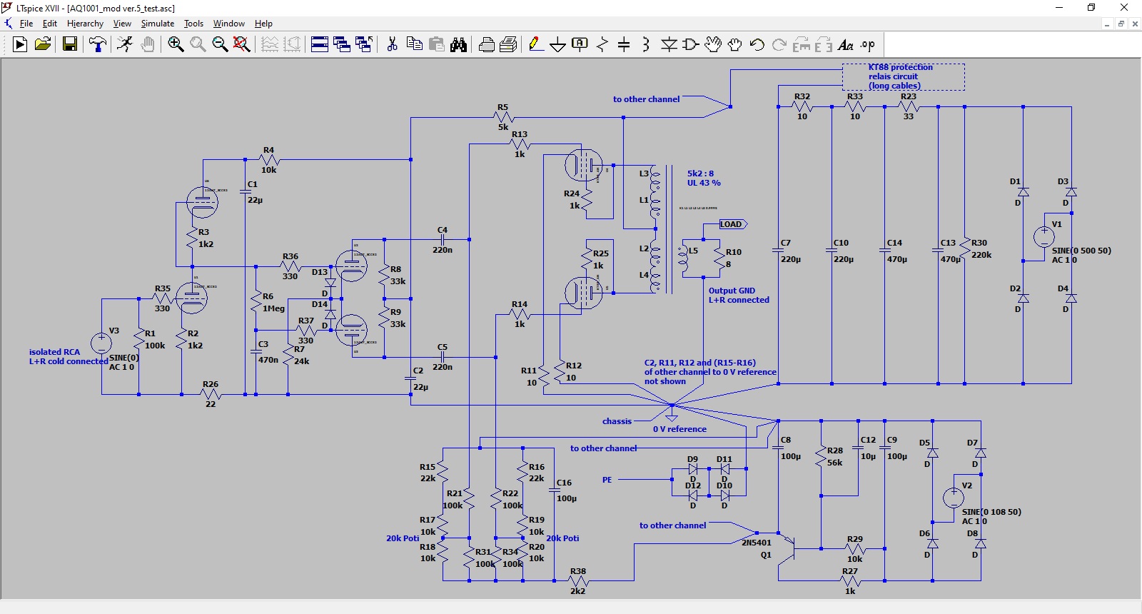

I am still far away from your sub 100 µV mark. Do you see any problems in the attached schematic ?

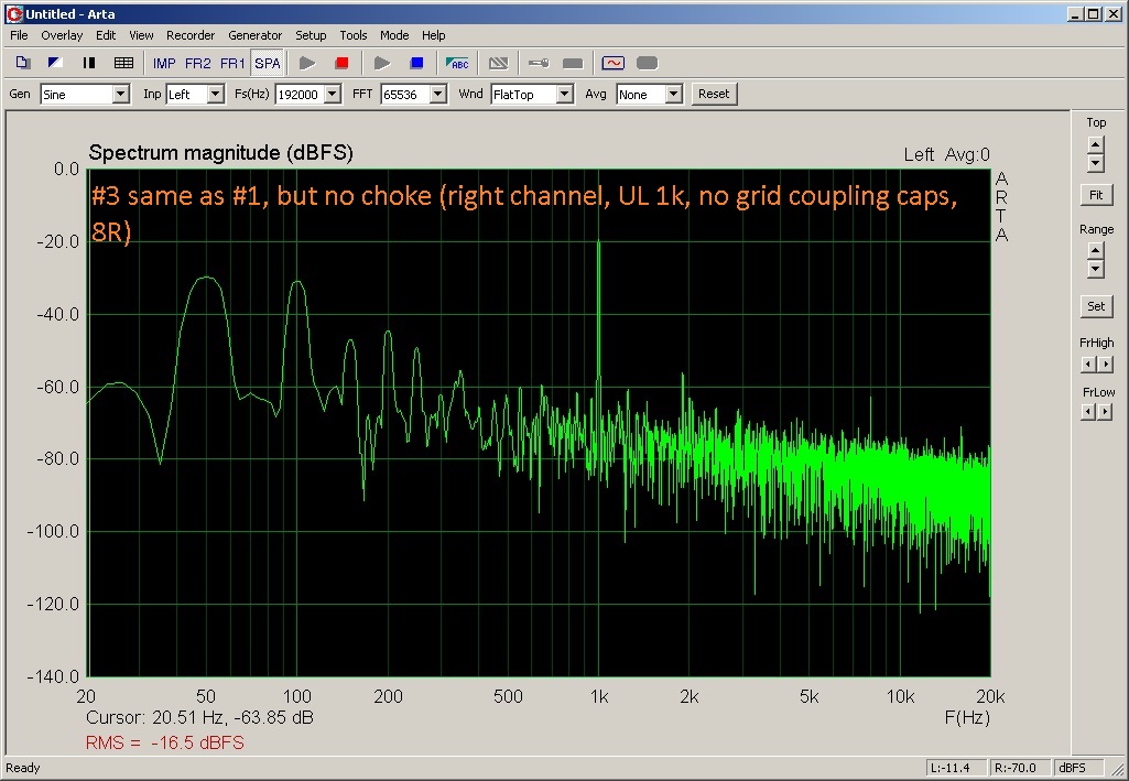

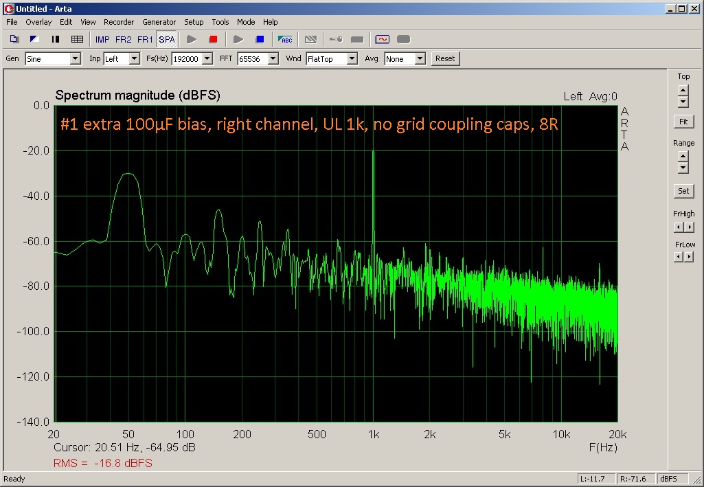

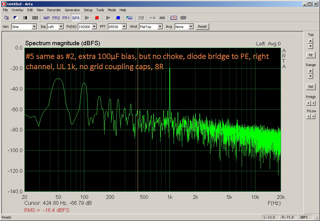

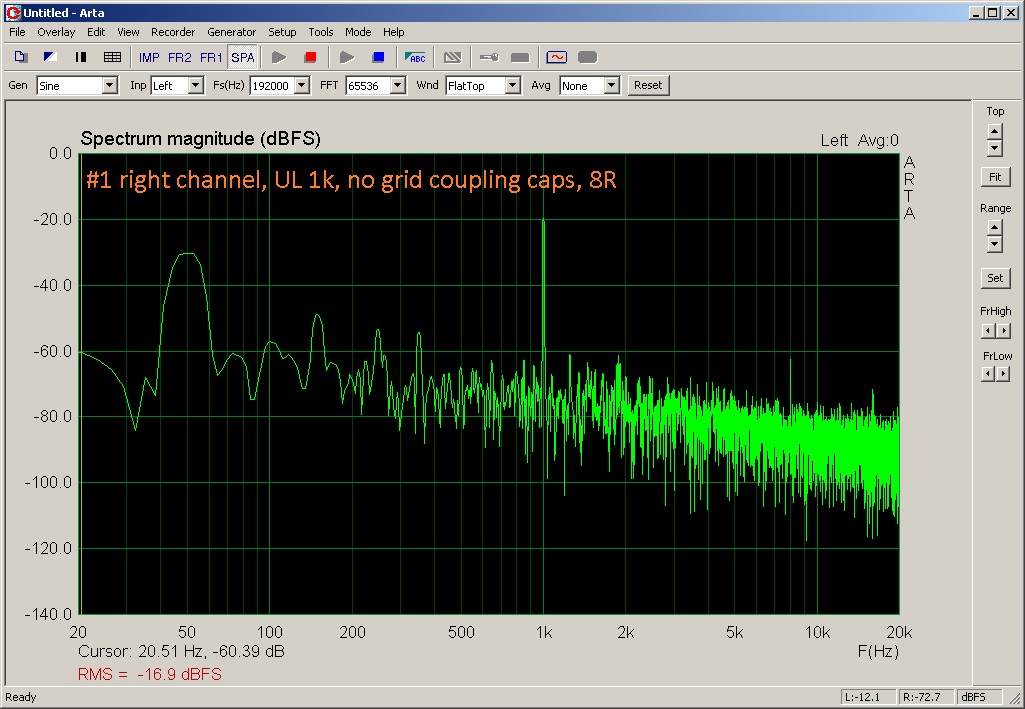

I did some more measurements. The amp as in the previous post, but grid coupling caps disconnected at right channel and 1k||120k and 2M2 open to remove local feedback('Supertriode'). The additional extra 100µF filter capacitance was added in the best possible position.
I am a little bit concerned to kill the tubes by switching them on/off quite often for the measurements. Would it be a good idea to buy a dimmer to ramp up the voltage during 30(?) seconds and than short the dimmer ?
Will post additional B+ filtering tomorrow.
First 5 plots are done with the switch in UL mode, last one switched to triode mode. Plot #2 and #5 have the extra 100µF for the bias (C16 doubled). The rest is wether with/without choke or GND (0 V reference) connected directly to PE or through the diode bridge.
The choke and the diode bridge make audible improvements.
  • #2 extra 100µF bias, right channel, UL 1k, no grid coupling caps, 8R_SPA.jpg
  • #3 same #1, but no choke, right channel, UL 1k, no grid coupling caps, 8R_SPA.jpg
  • #4 same #1, but no choke, diode bridge to PE, right channel, UL 1k, no grid coupling caps, 8R_SP.jpg
  • #5 same #2, extra 100µF bias, but no choke, diode bridge to PE, right channel, UL 1k, no grid co.jpg
  • #6 same #4 but Triode mode, no choke, diode bridge to PE, right channel, Triode mode 1k, no grid.jpg

Well, I notice 3 things about the schematic:
1. Both the SRPP input stage, and the Phase Invertor stage have what I call floating cathodes (they do not return the cathode to AC ground).
A bad tube (and there are many) that has lots of filament to cathode leakage, will pick up hum and noise from the filament winding
(I use spiral-wound-filament tubes in my input tubes; phase inverter tubes; and driver tubes).
The filament winding gets mains power fundamental and 3rd harmonic; and gets other noise from other mains power users; and gets some of the transient charge current noise of the B+ secondary and its rectifier and first filter cap, that is transferred to the filament winding.
2. What is the purpose of R26, 22 Ohms. It may be intended to reduce a ground loop, but instead it creates a ground loop.
Any wire (wire milli-Ohms, and wire inductance), and any 22 Ohm resistor are just the thing that any loop current will develop a voltage across.
Develop a voltage across the 22 Ohm resistor, and then potentially inject that voltage into the cathode of the bottom triode of the SRPP.
3. KT88 Fixed Bias:
</= 35 Watts, R g1 220k Maximum
>/= 35 Watts, R g1 100k Maximum
As drawn, with your 20k bias pot centered, each grid, g1 sees over 220k to ground.
That is a violation of safe operation.
And why are you worried about turning the tubes on and off?
What is the quiescent total plate and screen dissipation you are running in the KT88?
Unless they are overheated (above maximum ratings), they are meant to be turned on and off.
alujoe2,
You put L6 in the ground side of the B+ circuit;
and R23, 33 Ohms in the + of the B+ side.
Yes, L6 reduces (localizes) the B+ ground loop.
But then R23, 33 Ohms puts all of the remaining ripple current (and voltage) on the top of the second filter cap, and the second cap "floats".
Try putting L6 in the B+ lead between the + of the first filter cap, and the + of the second filter cap.
Then use separate wires in the ground path.
One wire from bridge negative (-) to first filter cap negative (-).
One wire from first filter cap negative (-) to the second filter cap negative (-).
One wire from the second filter cap negative(-) to the amplifier's central ground point.
Uh, you did use a choke that has a high enough voltage rating to not arc over when B+ goes to maximum voltage before the tubes warm up and draw current.
Otherwise, get a new choke before putting it in the + side of B+.
Also C1 is not very effective with R26, 22 Ohms in the circuit. Jumper across R26.
If you have bad problems with signal source ground loops, find a way to fix that outside of the amplifier circuits, not inside the amplifier circuits.

(but I love starting with a schematic, Thanks!).
You are for sure correct, but I tried DC heating before and nothing changed. Seems to me that the elevated and bypassed AC heating was good enough before the improvement with the RC on the bias supply. Will keep an eye on that and try DC again.

The HBR seems to work for problematic gear and might be a little bit worse on the bench in isolation.
Soundcard outputs on amp inputs and amp 8R output attached to sound card:
The DMM claims 1.029 mVrms for the shortened HBR 22R and 1.027 mVrms for the HBR 22R in place on the right channel with the disconnected grid coupling caps. On the left channel (ready for music) the values are around 396 mVrms and I can't detect a real difference (too much fluctuation).
Inputs shortened, soundcard not attached:
Right channel 0.186 mVrms and left channel about 1.1 mVrms (fluctuating). Shortening the HBRs seems to increase the readings in the left channel a little bit 1.2 mVrms(?) and it shows a lot more fluctuation. The right channel shows identical reading 0.186 mVrms (as it should be).
See attachments.
3. KT88 Fixed Bias:
Fully agree, but I have the excuse it was just prototype testing with an amp being equipped with an overcurrent protection relay 🙂.
Anyhow it is history, as I ditched the 'Supertriode' circuit yesterday and switched back to Triode mode, no more UL.
alujoe2,
I need a new choke, this one was pulled from a Chinese 845 amp with known bad reputation. It was used in the GND line - I am not brave enough to try it in B+.
That is about all I can see at this time.
Good luck pushing the hum and noise down.

Post #42 plots indicate that bias related hum is not noticeable, but do indicate that B+ related hum is an issue (and that includes hum ingress from the screen via the UL connection to B+).
I fully agree, I need to reduce B+ hum/buzz/noise.
If the focus turns to the B+ supply, have you done two comparison plots for just the output stage (driver coupling caps disconnected) where the base case doesn't include the choke (to provide a simpler circuit - so just filter caps and the 33 ohm CRC filter), and a step case where you add a flying 470uF cap to the B+ OT lead and the 10 ohm cathode sense resistors? You may have done those plots, but best that you pick them out.
If there was a noticeable hum drop between those two setups, then can you confirm the original 470uF capacitor that feeds the output stage is connecting to the same physical circuit locations as your added test capacitor, and the 0V link back to the power supply bridge and first filter cap is not connected to any other 0V point.
Another issue is the 2nd channel also has such a 0V node at the output stage 10 ohm sense leads, and that is going to be a hum loop situation. So can you do a comparison test where the 2nd channel has its B+ connection in place, and then with no B+ connection (ie. no circuitry or filter caps get powered, and hence no 0V link currents from that channel).
First of all, the local feedback in UL mode is history, I went back to Triode mode. The amp is still slightly different, as there is a ECC99 as driver in the left channel and a 6N(H)6P in the right channel. Right channel with lifted caps, left channel as per schematic.
Attached find the changes I did in the two schematic drawings. The drawings are rather accurate (except input and driver, there is a left/right difference on the PCBs). Yes, there is common impedance from C14 in ver4 (C7 in ver5) to 0 V reference.
I did some measurements, but as you can see from the plots, they don't make much sense (at least for me). I noted the DMM measurements to see if the soundcard is delivering non repeatable non sense or not.
I tried to show the effect of additional RCRC 10R/220µF/10R/220µF and mitigating the common impedance by not connecting the left channel.
The effect of the choke was shown clearly earlier and I expected the RCRC to show an improvement.
What shall I do ? Proceed to the 'attach a cap to B+ and 10R' or ... please help :crying:.

  • #05 right channel, 8R, 220µF+10R+220µF+10R, left channel powered, input shortened, 0.175mVRms.jpg
  • #04 right channel, 8R, no 220µF+10R+220µF+10R, left channel powered, input shortened, 0.175mVRms.jpg
  • #03 right channel, 8R, no 220µF+10R+220µF+10R, no left channel, input shortened, 0.226mVRms.jpg
  • #02 right channel, 8R, no 220µF+10R+220µF+10R, no left channel, input shortened, 0.226mVRms.jpg
  • #01 right channel, 8R, 220µF+10R+220µF+10R, no left channel, input shortened, 0.186mVRms.jpg
It looks like the plots in posts #51 and $#53 now include the whole amp, and with multiple changes. If so then imho they represent apples, not oranges. All I can suggest is you make a new baseline plot, with just the output stage, and no interaction from other channel, and make a plot for single change steps, as a means to clarify where and how hum is ingressing given your new arrangements.
If you are settled with baseline plots for just the output stage, then I suggest only adding one stage of the amp test channel at a time, and ensuring each new stage has a grounded input. For the PI stage that probably means inserting a high bleed resistance between the first and second stages (to provide a fixed bias), and decoupling the PI stage input to ground. For the input stage that means a temporary link from input grid to 0V end of R2.
NOooo, I don't want to drive you mad 😀.
I think I followed the rules....
I should have written more about the measurements.
1) The amp changed from UL including local feedback (Supertriode) to a standard triode mode setup as can be seen in the first schematic (ver4) in post #53. There are no other changes (only corrected the drawing to better show reality). The second schematic (ver5) shows the RCRC for the B+.
2) All measurements are always only relative to the first baseline plot of the individual post. Do not compare left and right channel or old and new plots, only compare left channel plots of the same post and right channel plots of the same post. I try to keep the same gain settings, but sometimes I have to adjust the gain. Never ever take the ARTA numbers as absolut numbers, as they are not calibrated. The only absolut numbers are the DMM readings.
3) There is a big difference in the noise if the inputs are shortened or if the inputs are connected to the soundcard generator.
4) Regarding post #51: I wanted to see/show the influence of the HBR (R26 22R). I was assuming that the additional RCRC for the B+ as per ver5 schematic would drop the B+ noise and therefore show better the influence of the HBR. On the right channel the grid coupling caps are disconnected. Therefore (new) baseline plot for right channel (#1) and for left channel (#2) HBRs shortened, than one step to plots #3 and #4 with the HBRs not shortened and another step to plots #5 and #6, this time the inputs are shortened.
5) With the same spirit, one step at a time I tried to do the post #53 plots.
All plots are right channel, caps lifted.
The baseline plot is - you guessed it - #1. It is/should be the same as plot #5 from post #51, except that the left channel isn't powered - B+ disconnected.
For the second plot - one step move - I disconnected the RCRC (now ver4 schematic instead of ver5) and as expected the noise increased. The soundcard indicated that the input is over driven, therefore plot #3 using reduced gain from the soundcard input to show the noise spectrum and not the clipping spectrum of the soundcard input.
Next single step to plot #4 was powering the left channel again. DMM indicated less noise than plot #1, but maybe I just have to wait a little bit longer to get an equal reading as in plot #1. This would indicate it doesn't matter in terms of noise if the left channel is powered or not - the common impedance problem from 0 V reference to C14 in ver4 schematic is not reflected in the measurement. Not what I expected, but who knows...
Next single step to plot #5 was adding the RCRC (ver5 schematic) again, same as plot #1 but powered left channel. Same reading on the DMM as in plot #4. Removing RCRC and no left channel B+ (#1 -> #2) leads to more noise, but adding RCRC with left channel B+ doesn't change anything ???
Comparing #4 and #5 leads to the conclusion RCRC is worthless, I don't believe that...
Comparing #1 and #5 leads to the conclusion, it is better to have the left channel powered, no really intuitive for me...
... therefore, must be something wrong with my thinking or measurements. Please explain ...

Some more plots, done with the laptop and soundcard battery powered.
Again right channel, coupling caps lifted, no B+ for left channel.
#1 using the RCRC, gave exactly the same result on the DMM as #2 without the RCRC. #3 without the RCRC, but bias cap C8 connected to HV C14 instead of 0 V reference. The other steps where moving the 10R (R11+R12) returns to C14 and the last step was moving the C2 return to C14.
In short, I was not able to show the effect of the additional RCRC in the B+, same problem as in the previous post. Still a mystery for me, why there is no change.
I could get rid of some common impedance issues which results in ver6 schematic. Actually I had this already some time ago, but it didn't show up in the other noise.
If I switch the amp on/off, the DMM immediately responds, which I think indicates that further improvements could be gained by increasing the distance between PT and OPT. I measured 0.077 mVrms amp off, 0.157 mVrms without tubes and 0.115 - 0.120 mVrms in the final (ver6) version.
Can someone please tell me what a good distance between PT and OPT is ?

  • #3 bias connected to HV cap, no 10R+220µF+10R+220µF, no left channel, right channel, 8R, inputs .jpg
  • #2 no 10R+220µF+10R+220µF, no left channel, right channel, 8R, inputs shortened, 0,165 mVrms, la.jpg
  • #1 10R+220µF+10R+220µF, no left channel, right channel, 8R, inputs shortened, 0,165 mVrms, lapto.jpg
For post #57, you show a schematic with C16 as the final bias filter cap, but then describe the step change as changing the location of C8, as well as making two other changes. Does that mean three changes were made for #3 plot that weren't made for #1-2 plots? Are you able to show a plot with C16 connected directly to 10 ohm cathode senses?
Are you able to show a plot with 220uF connected directly to OT B+ and to 10 ohm cathode senses? You show the B+ filtering cap positive feed being distant from the OT B+.
The above suggestions are aimed at trying to identify if your pre-existing way of connecting bias and B+ filters are somehow causing hum ingress. If they show no change, then can I suggest some photos.
As an aside, it is quite difficult to quickly interpret plots if there is no directly related schematic for each plot in the same post. That situation exists for most posts so far, and any kind of comprehension requires finding past schematics and reading multiple posts and trying to interpret what is in and out of circuit.
Is there a reason for choosing 1k screen stopper? 1k is higher than I have typically seen used.
This is basically repeating post #57:
No, again, I don't make more than one step, at least not intentional 😀.
I made schematics for every step, I hope it is clear. For the first 3 schematics there is the equivalent measurement plot. For schematic 4+5 use measurement plot #3 as there is no visible difference (only the DMM tells me success).
I don't think you want me to try schematic #6 or do you ? Is #7 what you want (it is hard to do, because of space) ?
My main(?) problem is the available space. The tubes and the PT and OPT should have more space between them. Tube orientation is wrong, there is no space for a choke, but I think I need one...
Yes there is quite a big distance between the 10Rs and from the 10Rs to the cap. Basically impossible to fit it in the chassis. If I do it using long wires to the outside it is senseless I guess. Are you satisfied with 1R+1µF RC ?
I am sorry, hopefully you like it the way I did it for this post, if not, please tell me.
Original value is 100R, but the KT88s oscillate at 650 kHz as the scope told me and I found this, therefore 1k, maybe 470 is good enough as well, didn't test it :Screen grid modification
I am thinking about switching to KT120 (less THD, more deep end I have been told). Needs more heater current and 51k instead of 100k grid resistor.
Can you please tell me a reasonable f3dB frequency ?
