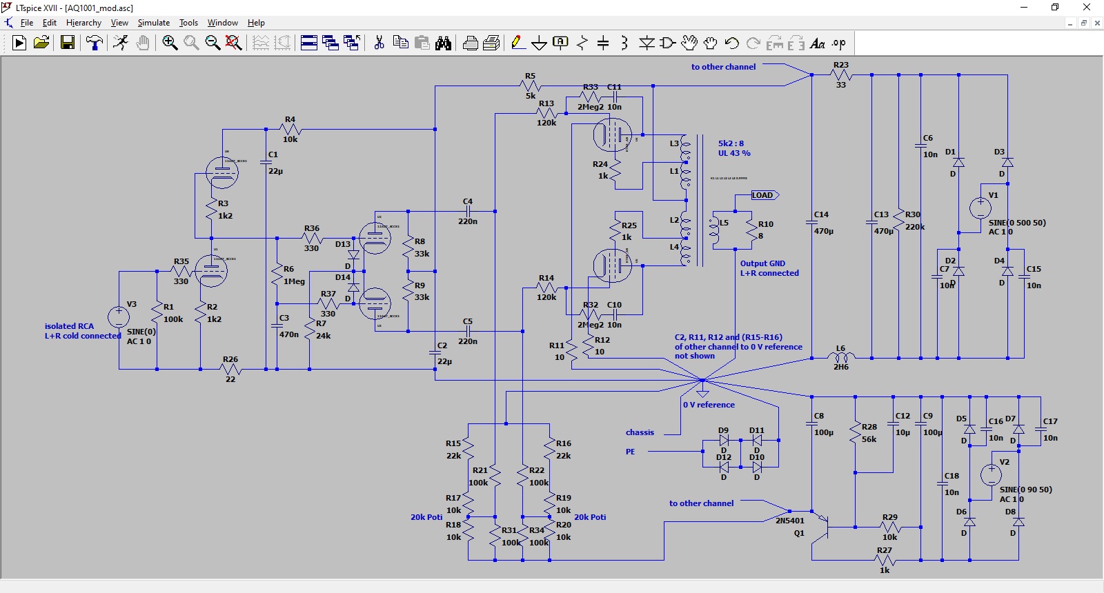

@trobbins
I attached the schematic, I feel ashamed to show pictures 😀, but if it helps I will make them.

Try grounding the grids of the KT88 with clipleads or whatever you have and see if the noise goes away.
That the noise is gone when the amp is switched off to be expected as it now basically runs on batteries and all AC except for the input signal is gone. A picture of the internals would be interesting.
The schematic is sort of trying to show a 0V layout. Does that mean the output stage cathodes go to the 0V star first and not to the negative terminal of C14, and the same with the output transformer B+ not going directly to the C14 positive terminal ?
Why is the input stage not directly decoupled by C1? You show a 22 ohm ground rail resistor.
Do you only have a DMM, or do you have at least a scope, and preferably a spectrum analyser?
Have you balanced the output stage idle current?
Why is there feedback from anode to grid on the output stage sides?
I don't understand why I should put the grid at 0 V, this is fixed bias, I guess I should turn the KT88 off by maximum negative bias - at least that is what I did.
The left channel drops to 290 µVrms, right channel drops to 330 µVrms.
Balancing the bias doesn't have any effect, the only thing that matters is how much current is drawn. I can have one tube at the standard 50 mA and if I increase the other tube the noise is rising, on the other hand, if I reduce bias, I get the lowest noise reading not when both channels daw the same amount of current, but when one tube is cut off. I can further reduce the noise by reducing the other tube as well. In short, output noise is proportional to bias current.
Yes, it is the usual 2-channel one PSU amplifier. What I have not drawn is the protection for the KT88s. The voltage over L+R R11 and R12 is monitored by a comparator which opens a single relay to cut off all 4 KT88s from the single PSU.
Actually one wire from C14 plus terminal (mounted on the left side) runs to the relay (mounted on the right side), from there back to the center and from there split into 4 wires, 2 (one L+R) to the OPT and 2 (one L+R) to the PCB.
The HBR to break the ground loop, look at the links in post #3, it works.
I can borrow a scope with a mediocre FFT and I have downloaded ARTA demoversion.
Yes, didn't make any difference, see above.
Because Menno van der Veen says this is Supertriode 😀. I don't like the typical harmonic distortion pattern in UL mode (dominant third harmonic), I always used those amplifiers in Triode mode. This modification dropped the third harmonic and I like that - triode sound with UL power.
