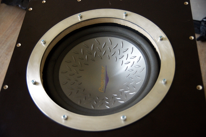

I want to put a car subwoofer in my room but I am at a loss on how to do it. I installed them in my car but that seems to be completely different than putting them in my room. So I am wondering if anyone could possibly explain how to hook up a car subwoofer in my room and what I would need to do that?

So go purchase a 12v converter to hook up amp (not just any make sure it can do the job) and place where ever you can that sounds best.

I use 2 low profile car subs in my flat. They are in very small sealed enclosures which is nice as I don't have loads of room space. Amplifier power is cheaper for me than room space, I'm using two Hypex UcD400 modules. I also use the Rod Elliot EAS sub controller:

You need a rather powerfull mono amp and active two way filter around 80/100hz.
Plate amps do all.
This kind of speaker have parameters allowing to mount them in small boxes, closed or vented. Closed boxes though going not so low than vented , sound better and are simpler to build.

Of course, plate AMPS is cheaper and easier to integrate. But I like the DIY process - the creation of PCBs, soldering, cabinet making. Then I will compare the sounds produced by my factory subwoofer which I use now with sound and of the DIY subwoofer( made of all available in the garage
