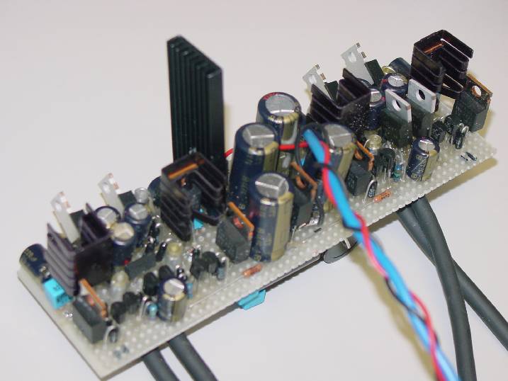

I am planing on designing a PCB for the I/V stage. I want to replace the 4 opamps in my DAC to this.
Is anybody interested?
I want to use silver mica for the small caps.
Panasonic FC for the electrolytics.
I probably will use 4,7 uF MKP caps for the output.

The key massage: find your own bias current! The sound is changing really radical from 3mA up to 10mA through the 2SK389. Also the DAC current will for sure change the best current value. Put one trimming resistor 150Ohm plus 63Ohm in line in for R2 and adjust the bias current. Then set R1 to U_b/2 and listen…

The pic shows the mini sized D1 clone I/U + buffer stage. Fully symmetrical (4 "channels") and two voltage regs a la P1.7 in the middle. The 610/9610 lock somewhat pressed in, because I originally layouted for smaller FETs. The sound is unbelievable nice. I trust in Nelsons circuits and just copy them.
Hopefully the other day a nice, small PCB would be available for this stage. Small to bring it into given packaging situations. By adjusteing two R´s and the filter cap it can easily by adapted to each DAC with symmetrical current output.
