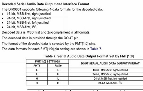

Hello
Is it Standard Japanese input format ?
I have some DIR9001 receiver chip, can it work for it ?

Looking at it, no... the nearest mode would be FMT1=FMT2=0, but the bits are clocked in the wrong way round and the LRCK is inverted to what the DAC requires.
It could be that TI and Toshiba use different meanings and it would actually work. You would need to invert LRCK from the reciever to feed it to the DAC, which is simple enough with a 74HC04 or similar.
I think if you are really keen, you need to try it. Make a small test board with just the DIR9001, and hook it to the CD player's board. Cut the traces to the DAC that bring in BCK, LRCK and DATA (pins 3, 7 and 8) and connect them to the outputs on the DIR9001. Remember LRCK would need to go via an inverter, or your channels would be swapped.

I will try it, it is much for learning about digital, since if it not work I will wait for the PCM1792A that I did ordered and try to use it with the DIR9001 or the CS8414. That one would be for my friend since I would use for myself my TDA1541A chip in non-os.
