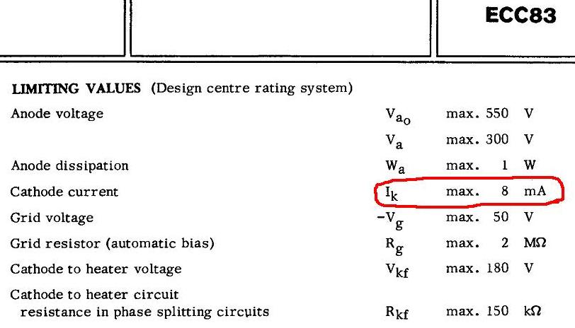

Could you suggest another tube .. remember the other triode is running at only 1ma at a plate voltage of 144V
scratch that, I see you did...
It is probably best not to push this triode too hard as it looks like a unity gain buffer before the tonestack...

Disclaimer: I don't have any experience in instrument amps. For hifi use, I'd tend toward an ECC88 or ECC81 for normal requirements. 2.6mA is not unreasonable there.
I'd be inclined to control distortion elsewhere, probably in a voltage amp stage. But if an experienced IA designer recommends otherwise, listen to him, not me.

PS I just looked at at datasheet that quotes 1.2mA plate current?

Good morning Nordic,
the ECC 83 can handle up to 8mA. 🙂
