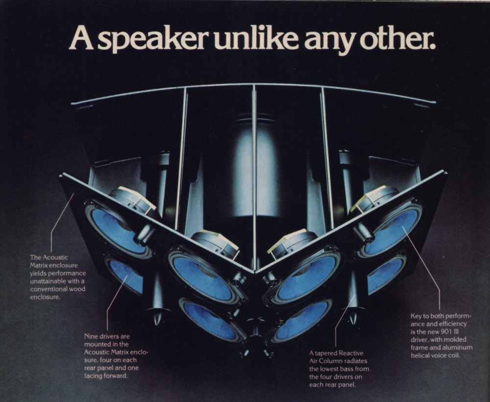

Not only doubling the volume. Ideally, you should divide the internal space by the wall. Just like bose did with nine identical fullranges. You do not want one affecting the cone of the other. Ideally.
Reactions: noyan
Yeah, I debated about mentioning it, but I've done a lot of multiple driver vented boxes using unmeasured same-same drivers with no issues, not even in prosound where any issues multiply seemingly exponentially.
That said, as good a way as any to add bracing with minimal Vb loss.
As for your example, they apparently had to based on some of the measured specs I've seen. 🙁
