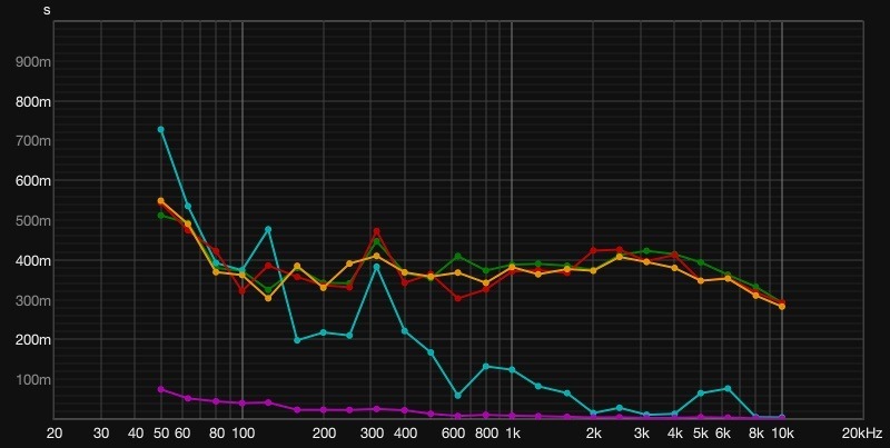

before and after...

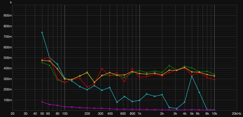

RT60 Decay:
before:
After treatment:
previously, there was a high plateau out to 40Hz, then somewhat high out to 500Hz. With the new measurement, the plateau falls off at 35Hz and is significantly lower out to 600 HZ. While not perfect, given the paucity of information below 35hz on most recordings, I’ll call it a win and I’ll call it a “bass trap.“ it’s a marked improvement that’s both measurable and audible.
Before RT60:
After:
seems like modest improvement in the midbass section.

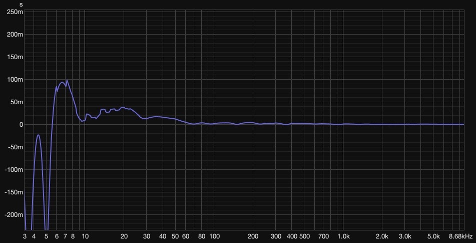

group delay is not awful:

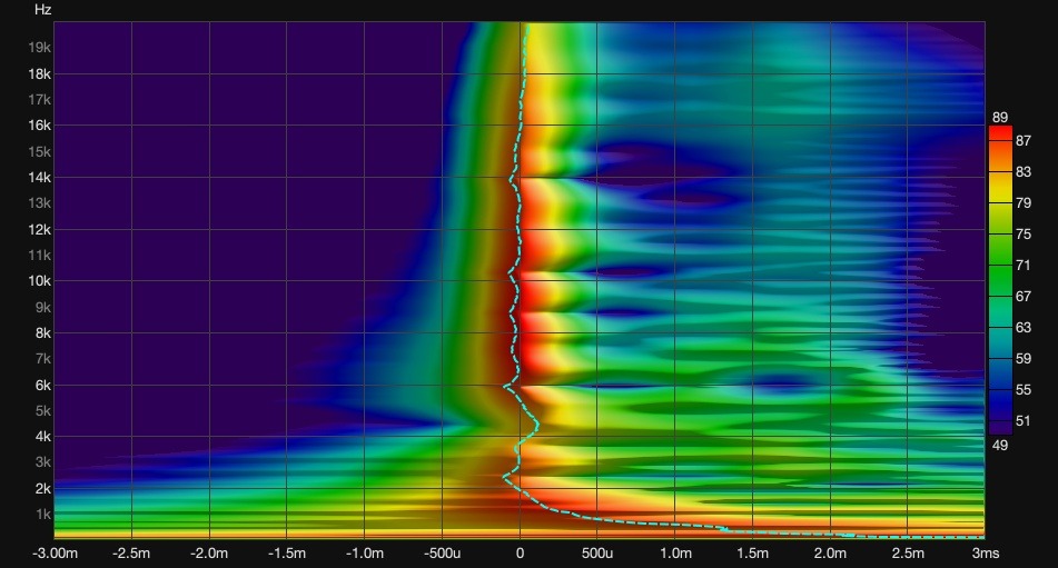

nor is the impulse response:

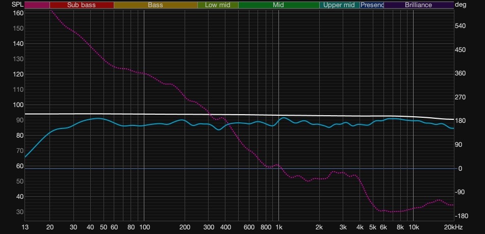

The phase is significantly improved over both an active crossover with "named" filters and several orders of magnitude better than a passive. Still, I'd like to get it flatter. It may be time to dig into RePhase and start learning how to generate FIR filters.
for laughs, I listened to it with a simulated stock crossover, with 6db slope filters and no delay. I should have measured it (I can always do that later), but I'll just say that I understand why a lot of people don't like horns. It was nigh unlistenable compared to what it is now.

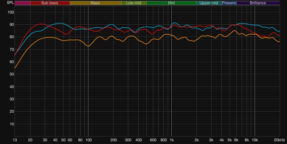

lastly, I tuned the left speaker and have them pretty close, although next time I'm home alone, there's still some more tweaking to be done.
the left is in red, the right is in light blue, while the ochre is from the MLP. The left could use a little boost in the upper range, while the right could stand some boost down low, but the latter isn't particularly noticeable. All told, the end game is in sight; after that, improvements become prohibitively expensive: the next level DAC is a couple thousand or more, ditto for just about every other component. I may have to find another hobby and just relax and enjoy the music!
Even though they're not doing anything under 35Hz, I'm going to keep calling them bass traps.

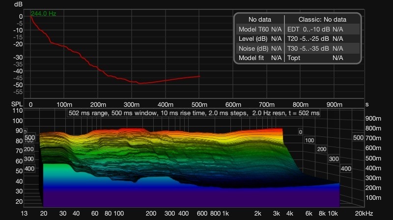

RT60 Decay:
before:
After treatment:
Before RT60:
After:

Did you measure on EXACTLY the same mic and speaker position? A few cm can change LF behaviour a lot.
What you see in the RT60 graph is what to expect with absorbers of that depth in the corner. From 100Hz and higher, that's actually good for these.
Compared to a well treated room where you hear the music and not room chaos ... that's still not THAT much ;-).
Bringing the first surfaces in a "naked" room gives quickly a noticeable effect. But still a bad room.
Increasing treatment shows the remaining problems (like flutter) - which can be pretty unpleasant.
But when completing the concept you are aiming for the parts come together and the system starts showing what it's able to do.
Not always easy to do in an existing living room, easier and cheaper to do during building or set up a room.
