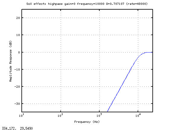

Let's see response of the 12dB/oct (2 poles, 6dB/oct each?) "highpass" filter of sox at 10kHz:

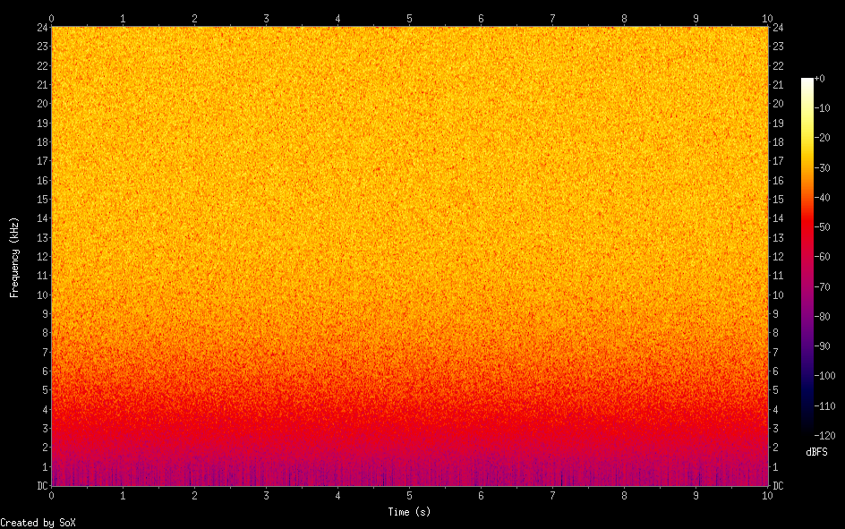

What does it do to the spectrum?

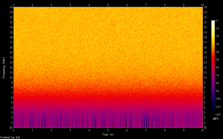

24 dB/oct - let's stack two filters on top of each other:
This time I specified in sox the name of the output wav file instead of the "no-file" parameter -n and the file white-hp24.wav with the spectrum above was stored for further use.

sox --plot octave -n -n highpass 10k > highpass.plt
octave highpass.plt
Code:
Code:
sox white.wav white-hp24.wav highpass 10k highpass 10k spectrogram -o spectrogram-hp24.png
