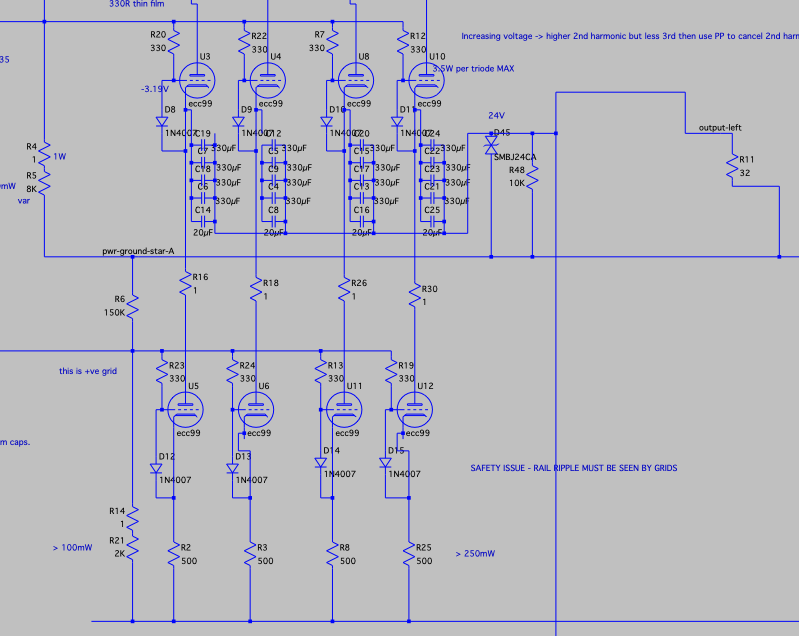

This is the brute force mess of a totem with independent biasing but requires separate biasing for each pair - something that a DC model would work but be a pain in reality:

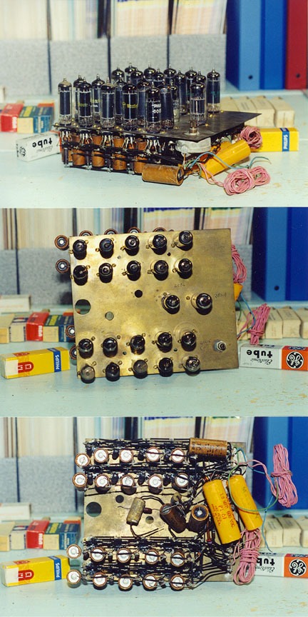

Somewhat like this, done circa 1960. 20X 6AQ5 in a stacked PP arrangement.
It used two regulated 300V lab supplies. The output was nominally at zero volts. But not DC coupled.
And was used to drive a 120V synchronous motor. So NFB sampled output current
& adjusted the output voltage up as frequency increased. Was capable of >100W.
Today can be done with far less complication using FETs. 😀

I may be a sissy, but the thought of a failing tube amp output going to B+ wired directly to my head is not something I enjoy.
Indeed OTL needs some safety. An intermittent B+ short will sendup causing a high voltage through a coupling cap too yet the majority of commercial OTL amps uses a non X class to couple, less so a transformer unless it shorts over the insulation.
You could have a trip sensing overvoltage with a relay to short a B+ fuse between the tubes and the smoothing cap.
For a DC coupled Totem Pole output stage, if the bottom tube opens up, and you use a shorting relay to short the output to ground,
Then you just blew out the top tube too.
When the relay grounds the top tube output to ground, it just might take out its driver tube along with it.
Shock proofed, yes.
But you doubled, or tripled, the parts failure count.
