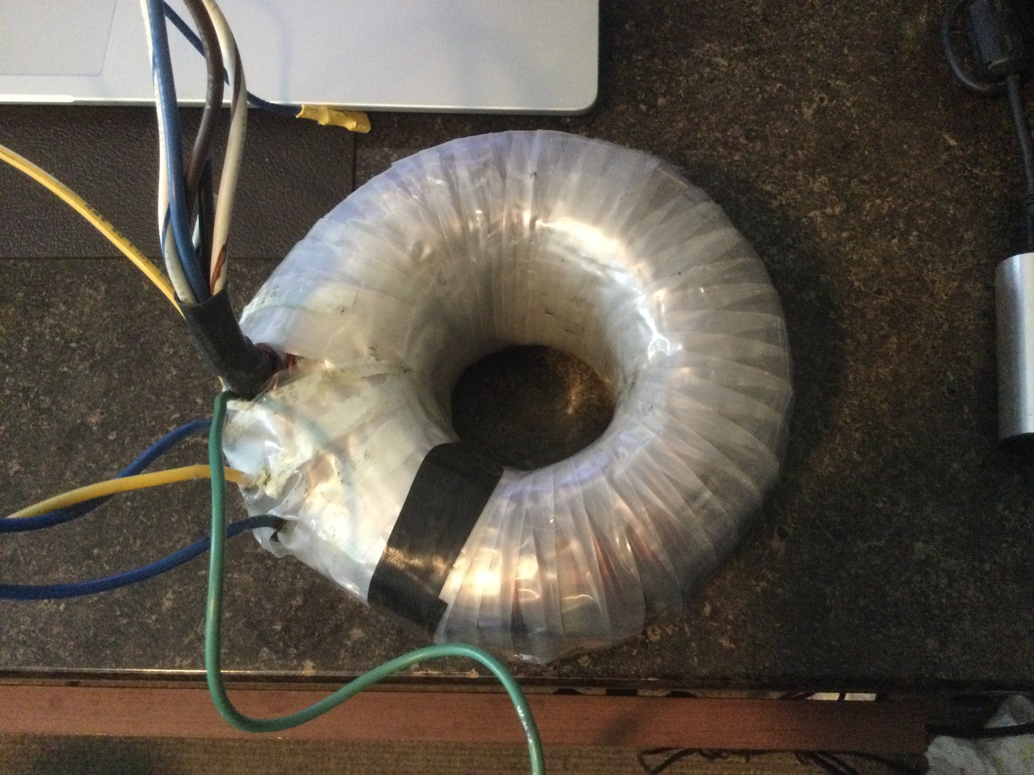

Winding machines are too rich for my blood, but I’ve never had problems just using a hand shuttle. Even with two #10 or up to four #12 at once on the largest cores. I don‘t wind my own primaries for toroids - I’ve always left that job to someone else. Toroid Corp (Maryland, USA) still sells the prewound primaries, and I’ve used their 1400 VA units. And pulled secondaries I can’t use off existing ones and put on the secondary I want. And added tertiary windings to off the shelf units. Something bought for $25 on the surplus market that’s too low a voltage to be useful (THE most common scenario) can easily be turned into a suitable power trafo for 100 to 200 watts per channel, with just a roll of #13 or 15 and some elbow grease.
