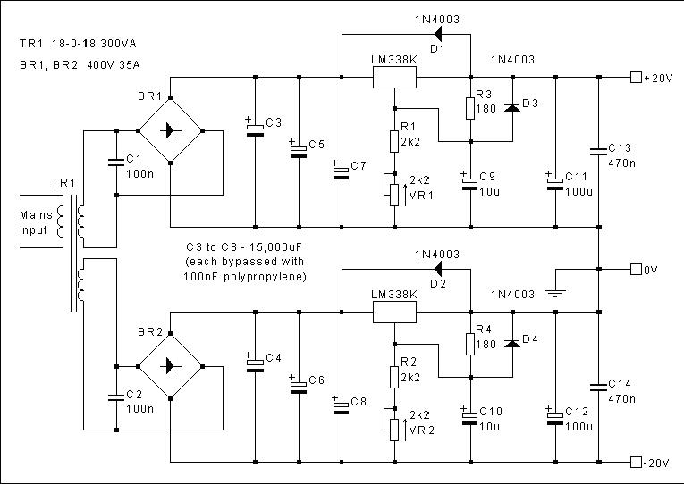

How many I can really use? 8 or 4?
Before I place order to Zalytron for
14 Gauge Super Silicon Grain Orientated Steel Core Q Coil with 2.00mh, 0.101 DCR @ $7.52
I am planning to use them between C3 and C5; and C4 and C6 from the diagram attached (From Geoff'site) of my power supply.
Can I use 4 of them for 1 PSU for 1 mono block amp, or is this a waste for the inductors in the ground rails too?
Thanks,
Chris
