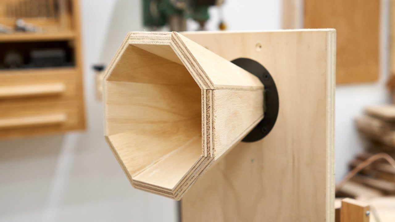

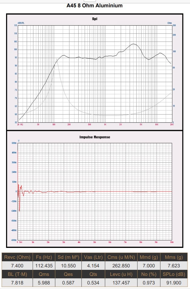

1/ The driver is not really suitable for baffle mounted use due to the rising treble response (see attached datasheet). So, right off the bat I expect I'll need to address that limitation. One option is to shape the frequency response of the driving signal, either a filter network at the driver, or at line-level. The other option is to shape it physically by employing a small front horn, something designed to help flatten the frequency response rather than provide directional control - I'd actually like wide dispersion if possible.

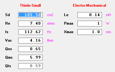

2/ The driver is not really suitable for generating bass, it's got limited cone area and limited x-max. I guess it's good down to 200Hz to 300Hz at moderate listening levels suitable for a small room. Other than accepting limited low frequency output the only option would be to add a supporting woofer.

b) A modest compound horn, i.e. a back loaded horn (e.g. Lowther Alerion for which I do have the plans) perhaps with a small front-horn on the Lowther. A separate sub is possible. What about a double mouthed horn - worth the extra wood ?

Bigun, you will never get any serious bass out of that midtweeter, no matter the enclosure. Even jlow, kleinhorn or jericho horn, no real bass. Not to mention complicated construction.
If you accept this fact, and go for simple 2way, woofer plus extended range, crossed at say 150Hz, all can be pretty simple. Lowther in small closed bookshelf box, woofer whatever you stomach.
