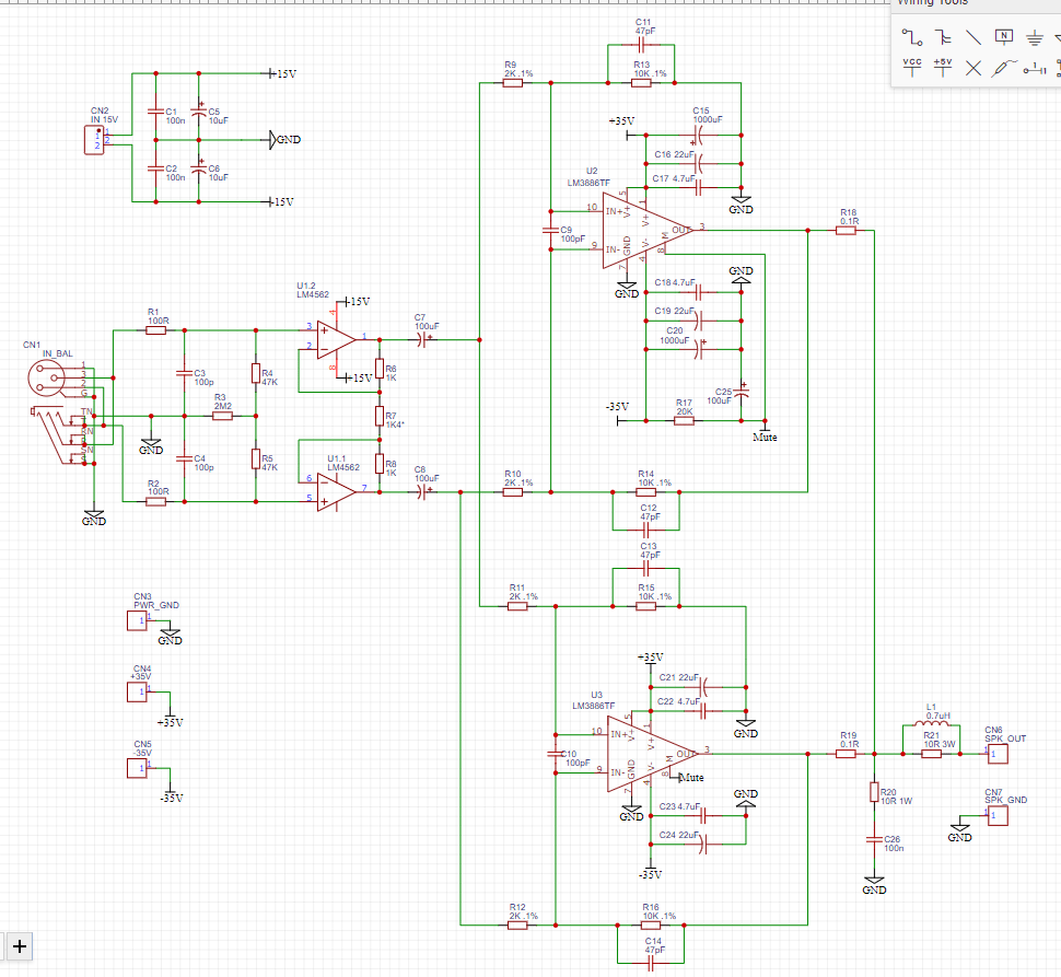

I therefore wonder how bad will the standing current will be in the below schematics? Is servo absolutely necessary or I can do without?
Help much appreciated!

I looked it up for you in the data sheet ;-)
It is specified at 1mV typical, 10mV max.
The DC gain around the chip is 1, so worst case there would be 20mV difference between the two outputs, assuming max values and opposite polarity.
With 0.2R total ballast, that would, worst case, give I = V/R = 2*10^-2 / 2*10^-1 = 10^-1A = 100mA if I did my sums correctly.
That's a lot. But if you assume typical values that drops to 10mA.
There's also the input offset current, worst case 0.2uA, which would cause an offset voltage across the 10k feedback resistors of another (2*10^-7) * (10^4) = 2*10^-3 = 2mV. Typical value would be 1/20 of that.
I don't know if that would add or subtract, depends on polarity. Worst case it would add of course.
It would be very rare for two chips both being worst case offsets and opposite polarity, so I would go with typical values but do a health check after the build.
Maybe Tomchr has some info on the typical values he sees in his builds.

High output standing current is not necessary a bad thing. This current will keep the output stage in class A witch is required by some audiophile peoples.
Paralleling voltage sources usually have those kind of problems. From two batteries, two transformers, two amplifiers... Also usually it is done in order to get more power. But given you have all the circuit balanced to ground, keep it balance up to the output and bridge them in place of parallel them.
At DC, the like branches of the subtractor circuits are connected together, not to (AC-) GND as it were the case for AC. That might change the differential DC gain for DC offset, ideally you just insert a 10mV DC source at one single OpAmp input pin in the sim and check the outputs (I haven't checked).The DC gain around the chip is 1
Normally, we want to have each section use their own coupling caps so that there is no coupling at DC between sections. A servo (one per section) might be a better solution as the capacitors are smaller and can be precision type and tolerance, which avoids fighting conditions at near DC frequencies where cap tolerances will cause different output voltages leading to cross currents.
That said, I've paralled outputs of LM4780 duals with 0.1R in a composite and ran some 20 amplifier modules at 10x down to DC with no DC cross current issues, always less than 100mA. Not a guaranteed spec but with a bit of care I think you can eliminate all DC capacitors and run the circuit DC-coupled, placing an input DC cap at the input of the preceeding buffer.

OT but wanted to point out the input bias network formed by R3, R4 and R5.
I've advocated for this approach for a long time.
It has a high Zcm (and modest Zdiff) without using bootstrapping.

Thanks everyone for replies!
So is it possible to match two LM3886 chips by offset voltage value? Will that be a good idea practically speaking?
In principle yes, but in practice you will have to build them, including soldering, mounting, smearing with grease, the works.
FWIW in my book paralleling voltage sources is bad engineering so I avoid it like the plague.
This silly idea became popular because chipamp sellers get to sell twice as many (or 4 times as much) and beginners find them simple and cool.

For a proper paralleling a kind of current share mechanics must be done. Ussualy there is an outer voltage loop controlling the gain and distortion but the is one or more internal current loop that tryes to distribute currents in all power devices more or less equaly. Unfortunately, the inner current loop must be done whit a BW somewhat more limited than the voltage loop in order to avoid oscillations.
As I said, use with care and always check independent offsets first before fitting the current sharing resistors.So is it possible to match two LM3886 chips by offset voltage value? Will that be a good idea practically speaking?
There's plenty of instrumentation field amplifiers that use simple load sharing between a bunch of similar closed loop output stages, so I wouldn't say this is bad engineering per se.FWIW in my book paralleling voltage sources is bad engineering so I avoid it like the plague.

You can split a supply like this, but you need to use a divider across the two rails for the positive inputs instead of a single resistor to the (floating) ground. Or you can add a ground ~regulator that soaks up any bias current that might pull ground towards one of the rails.

When paralleling power amplifiers, which is the case here, each one has its own "brain" (differential stage, main gain stage, most important: its own NFB net), hell bent on setting a definite output voltage.
Having 2 (or more) "brains" will result on them fighting each other to death to impose its own "solution"
I stand by my idea that paralleling voltage is a bad idea, bad Engineering, and recognize that in some limited cases it can be done, sort of, only becuse they deviate from being a perfect voltage source.
So they are not such any more, and hardly a rebuttal to my concept.
The clumsy cludgy way to (sort of) "solve" that very real problem, self created I might add, is to:
1) make those "fighting brains" think alike .... which is not easy:
a) use exact same type and model chipamps
b) use high precision (0.1%) resistors in the NFB network, so they "think the same", meaning they "agree" on output voltage.
2) nuke the "voltage source" by adding a series resistor so it´s not so any more.
(did I mention bad engineering?)
3) on a practical side, pray those amps are stable, components do not drift, a bad resistor does not need to be replaced in the future, etc.
4) "but ... but .... it´s "only" 0.1 ohm added"
Think again.

The best way to force two circuits to properly share a load is to have one master and one slave (apology to anyone offended by the terms but they are the industry standard) with their outputss tied together. Monitor the current in the master with a resistor in the output and force the current in the slave to be the same.
I'm sure the Neurochrome site is just fine, but there's this other document on bridging and paralleling those chips that you may want to read. I dare say it's as trustworthy as Neurochrome, because it's from the chip manufacturer:
