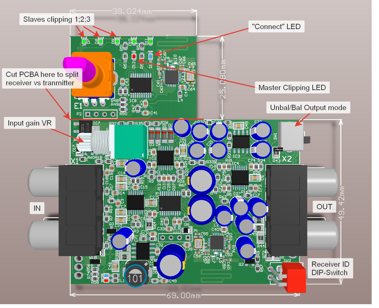

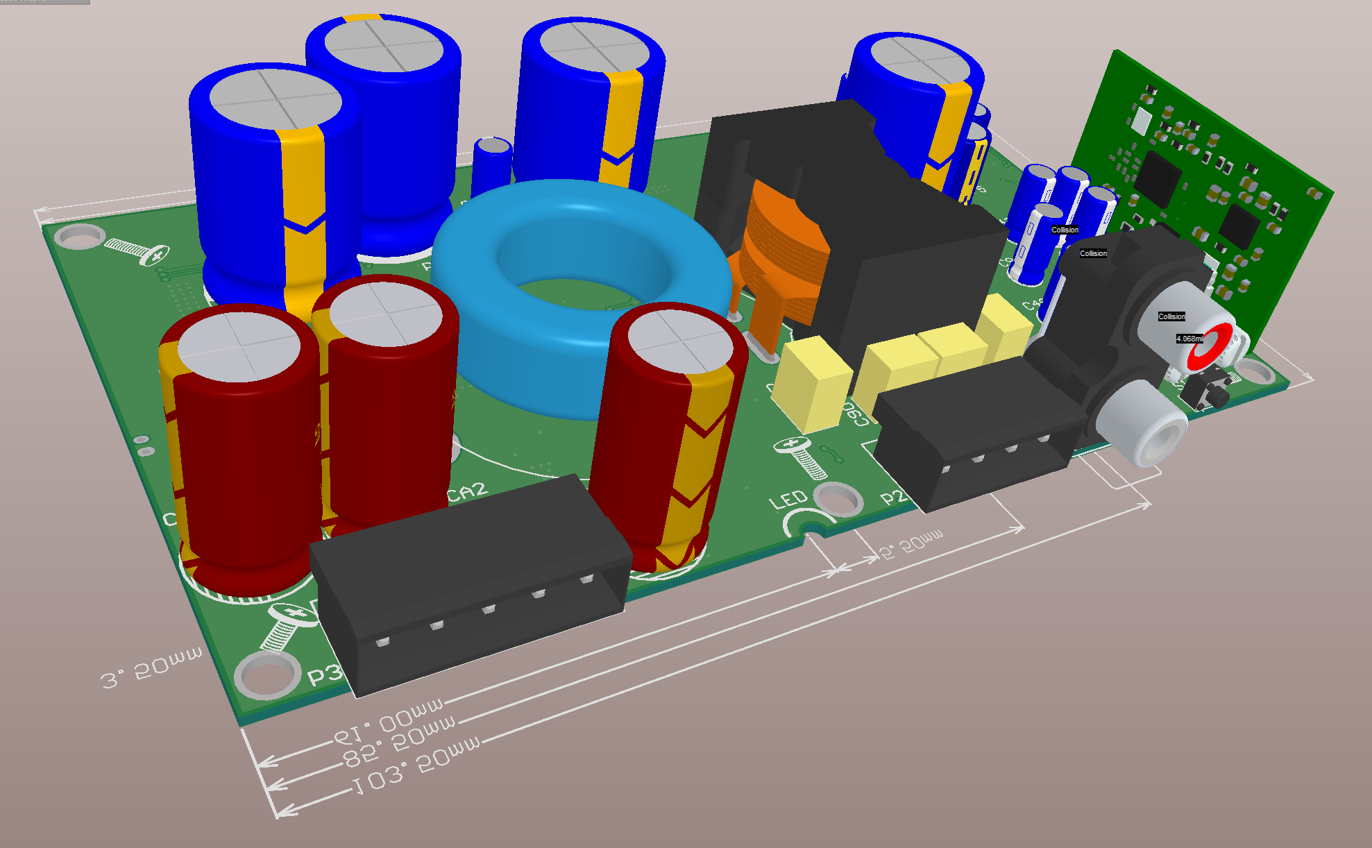

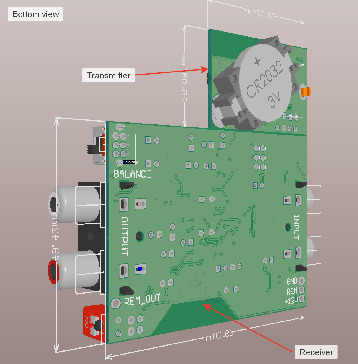

I believe, you guys will be surprised how cheap BOMs for caraudio amps. My 500W mono model with "anyload" ability (4/2/1/.5 ohm loads 250/500/500/250W output 1% THD+N). $13 PCBA (i.e. electronics only)! $16 for the same but with BT low energy IOS/Android DSP control with a minimum phase FIR filter (2.9Hz resolution, range 20:500Hz, 5mS total latency) for "room compensation"(see attached). Another example, I've designed the wireless Volume controller $5 BOM with balanced inputs to avoid "engine noise" problem and balanced 10VRMS outputs(it is the line driver actually with "remote" output and DC turn On detector), single knob could control up to 4 "receiver" boards with individual clipping state indication. However, OEMs think it is too expensive for car audio market )) BTW, OEMs continuously try to cheat about money i.e. want to get new models for free, that's an obvious sign that the market is deathly cold. Certainly, this market is dead to me, I won't spend my time for that anymore ;)

i get that, im talking about similar amps. as an example: kicker has a 400W mono block for about 300 bucks. its average in size, nothing special in power delivery, a basic amp in the market. here you have an amp that is physically 1/5th (or less), from components it would appear to be far less expensive than 300 USD (no?) and delivers more or equal power.
so why spend the extra money and size on another amp when the one you have presented does all the same things?

NCC74656, which one kicker is 5 times bigger? For instance, I made for them PX500.1 it was a comparably sized amp, you just see the PCBA itself without heatsink. BTW, kicker always reduces power for pretty much the same amps but released as different models, so 600/500/400w monos or 1500/1600/1800 or 800/1000/1200 are same things essentially.
