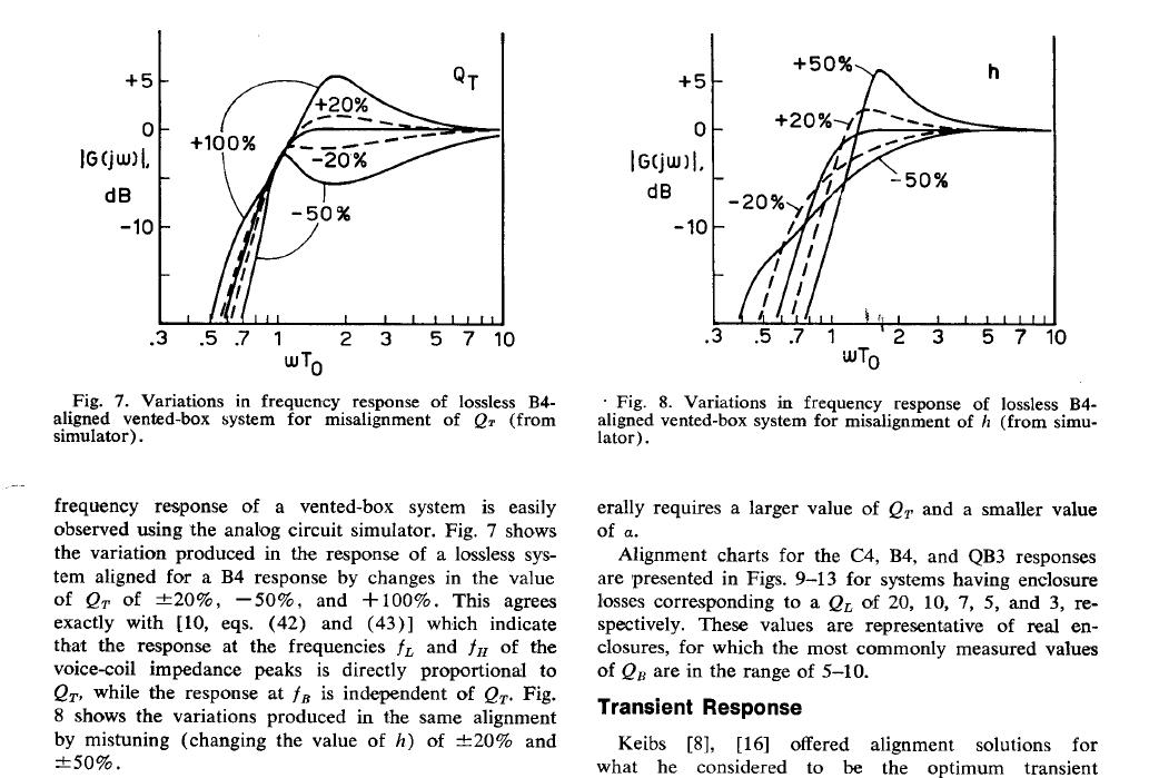

Here is an answer in graphical form from the Dick Small vented box paper. The left graph shows variation due to changes in Qt and the right curve shows variation in h, the fb/fs ratio. (So tuning error is h error). You can see for the case given (lossless B4 or 4th order Butterworth) you get a band edge error of about 1 dB for every 10%.
So if you consider that static T/S can be on the order of +/- 10% and dynamic changes even more....
