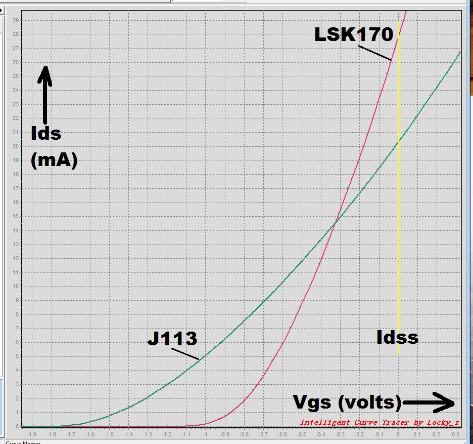

Yes just simulated in ltspice the distortion is relatively higher in these. So what is the substitute now?
A bit of measured data. The J113 has a lower transconductance "gm" (the slope of the curve).
If you are interested in complementary pairs for followers or as CFA
input stages, my preferred parts are the 2SK170, 2SJ74 (or the Linear
Systems equivalents). but the J113 and J176 are good enough for most
of these circuits.
For 10 mA of bias, you would put some resistance between the sources,
typically something in the 22 + 22 ohm range, taking the output off the
center (or maybe use a 50 ohm pot)
The output impedance without degeneration is about 40 ohms, for a
combined gm of about 25 mA/v, about half that of the Toshiba/LS
parts. For the F5 they result in about 6 dB less open loop gain, not
a problem.
The random noise floor for a pair of these is about 1.4 nV (per square
root Hz), compared to about 0.5 nV for the Toshiba parts, which is nearly
a 10 dB difference. A problem when your signal is 10 uV - not so much
when it's 1 volt.
Distortion driving a 10K load at 1V is about 0.015% thd, mostly 2nd
harmonic due to gain mismatch, which can be nulled out or ignored.
In short, these are workable parts.

So many questions.
If you simply match Idss the Toshibas/LS you can get .00X numbers,
and with enough testing you can hit .000X. The J176/J113 parts do
not go this low.
10 mA is a nominal number for bias. With the push-pull circuits the
performance is not heavily dependent on this, so a figure like this
works generally. You can go higher or lower as you like, within the
constraints of dissipation on the parts.
You note that I used the J176, which has a lower Idss than the J175.
My J175 parts come in around 30 mA and the J176 around 15 mA Idss.
Your results will vary, but you get the idea.
