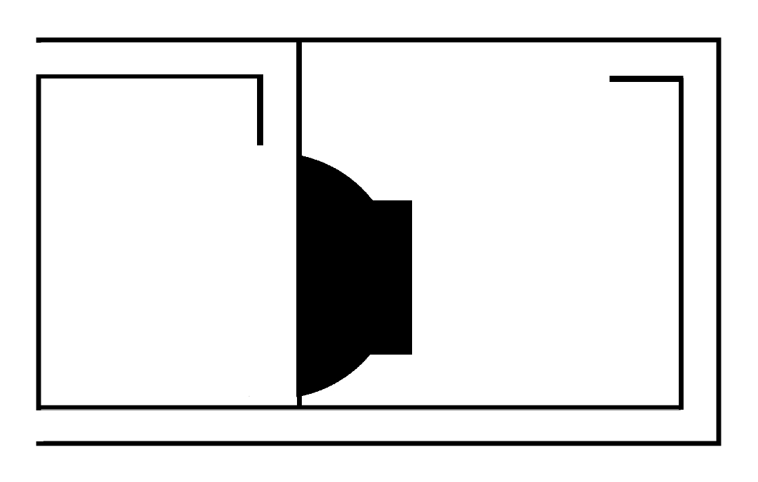

I moded my 6th order bp idea to fix that air-compression thing and here it's (just a sketch, not scaled).
Could someone please sim this for me, cos I don't know how to...?
I'm now ready to build this and looking for dimensions.
If space is your concern, I have enough space in the room to place any large of a box.
For t/s reference, here's the driver I'm gonna use.
https://www.bcspeakers.com/en/products/lf-driver/12-0/8/12tbx100
Thanks in advance... 🙂

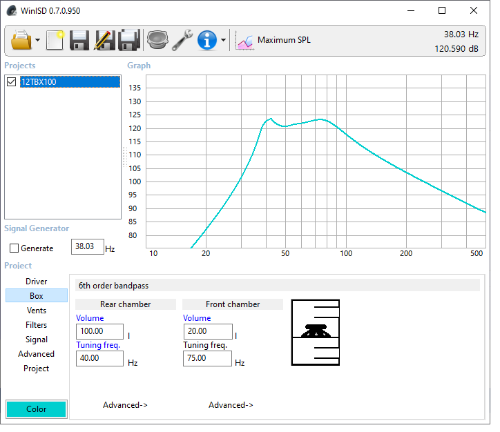

I think the shape needs to be changed for a 6th. Here is a quick run on 1000W. Ports are not that different in length, but the boxes are.

There ya go! Except one must note the short comings of that program are very real. I stopped using it quickly after my first look as horn response later showed the reality of ‘lumped sums as pressure vessels’?
Horn response drops a dime on the 6/8th order pipes ive made and i cant even believe how the impedances mimic the first few in tiers so well. Very well played by David mcbean! In fact, most folded t TLs might need to consider the TH sime with 0.01cm as the last segment. If chasing that void around up top to see where it went or is potentially.

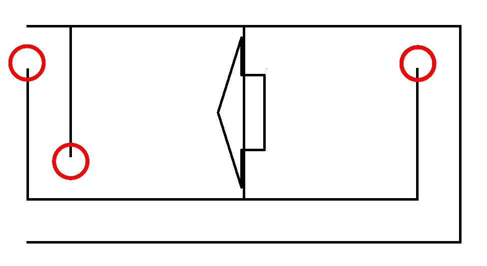

Alright, now it's clear, I guess you were talking for this whole time since we met about the "air velocity", I always had this doubt, if air pressure is manipulated between the chambers to flow one faster than the other (just realized the 3:1 ration you explained plus short vent big instead of long), the criss-cross won't occur, problem solved!
If you mean the below red markings by "helmholtz", there are three...

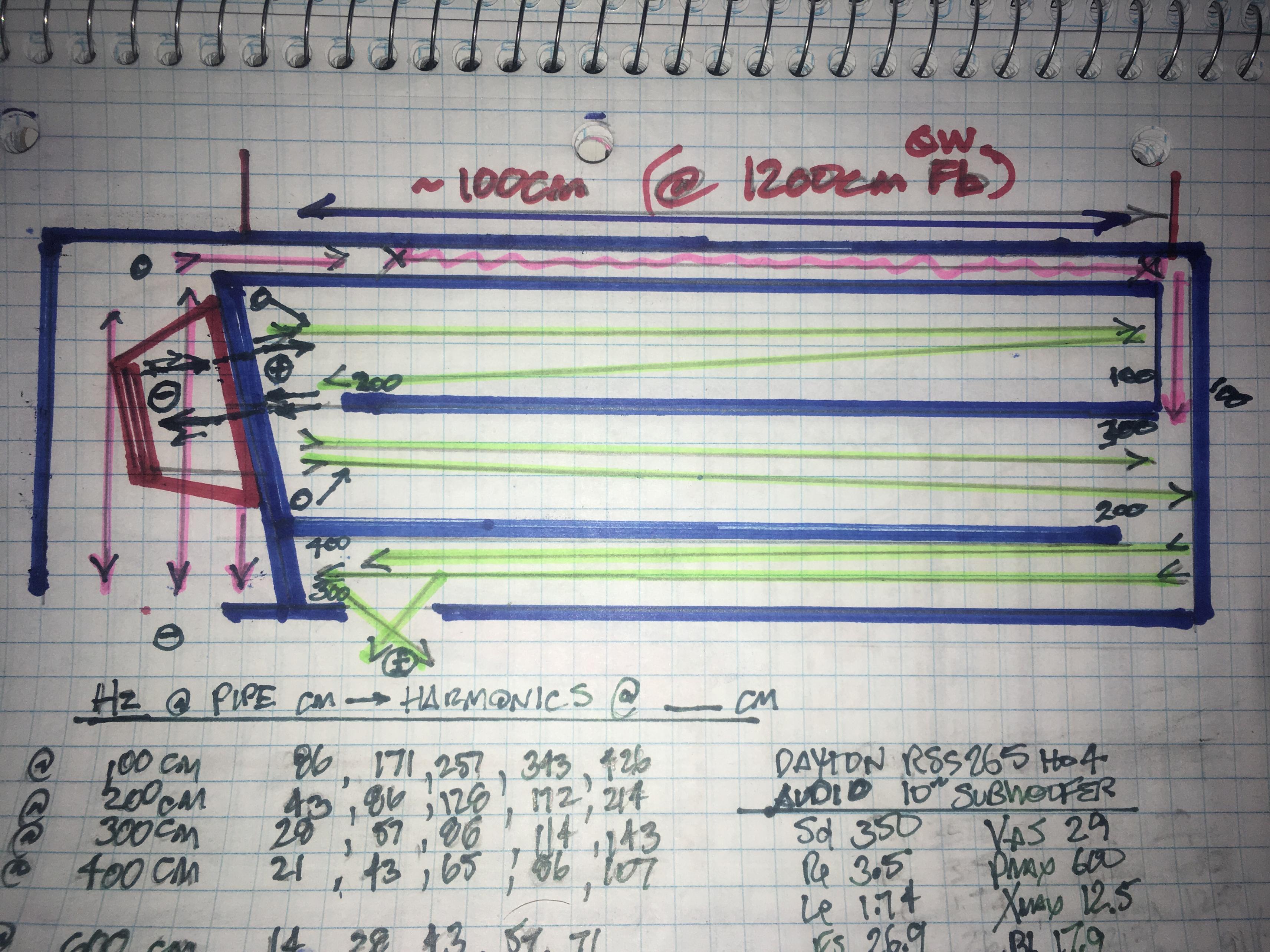

Lol!! Im not sure either but they all look funny but sound funny tooo(in a good way). Still need another fold and ipper tier on this one that zigzags back in another larger pipe segment as long as these that proceed it. A lo filter or resonator doen the middle maybe as well?
Is this one of your builds...?
Thats this (pic), but ignoring the pink ‘extras’ and exit detail as theyre a seperate part of a different function and more ‘bolt ons’.
I'm seeing this kinda TL for the 1st time, mostly in TLs one side of the driver is sealed, but in this front air comes 2-way to rear and rear is open-air as well, thinking thinking... 😎
Yeah, it seems the offset driver position runs bandwidth up to the 5 (1/4 wave harmonic instead of the null often seen at ~ 3 x the ( qw )fb.. if i sim the full
