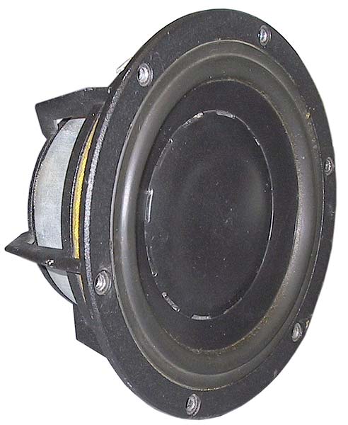

I have a pair of Dynaudio 17W75 woofer and D-28/2 tweeter.
I like the Dynaudio 17W75, it have very clean sound, but it have only 85dB for the SPL at 1W/1m , I would like a loudspeaker box who would boost the overall efficiency of my Dynaudio 17W75 and having a clean sound.

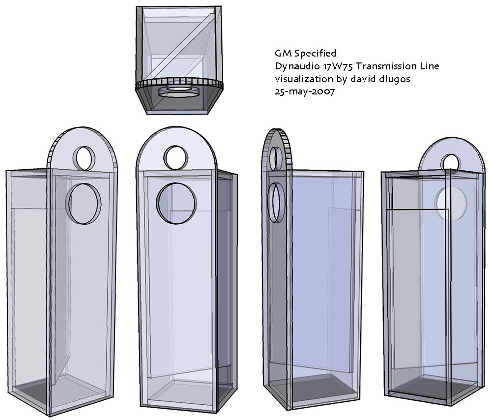

According to some old Dynaudio specs, they recommend 14 L/52 Hz F3 with a variovent, but if this is acceptable, then it's medium high Qts makes it suitable for an end loaded max flat impedance TL that's much better damped:
L = 60.042"
CSA = 38.504"^2 (7" dia.)
stuffing = 1.0 lb/ft^3 polyfil shown
Round up the dims to your preferred units, fold it as required to get the desired listening height with the tweeter on top and stuff to suit.

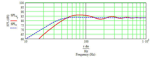

I just 'ran the numbers' and loaded them in MJK's Mathcad program to get a sim for you, so no drawings. It's up to you to turn them into a cab that suits your sense of shape/style.

GM said:It's up to you to turn them into a cab that suits your sense of shape/style.
Here is what i would do with those numbers.
You might want to move the drivers a bit off-centre and make mirror-imaged pairs. The vent could also exit out the top.

GM said:Sd = 120 cm^2, so if this is accurate, then so is the 4.866" dia.
But with the way Dynaudio names their drivers it is ~ 17 cm (6.5") in diameter

planet10 said:Here is what i would do with those numbers.
Works for me, thanks for the help! Maybe one of these days before Oldtimer's disease finishes me off I'll learn a Cad program.
OK, that is the actual cone .... by the time you add the basket you are up in the 6.5" diameter neighborhood -- we were just talking different diameters.

GM said:That's about right for a < 5" effective diameter, but I don't really care about the nominal diameter for box design.........
And i was asking because i was drawing up a representation of the driver for the box.

GM said:Ah! Divided by a common language! The actual overall diameter is 17.7 cm/6.9685".........
Then the driver in the drawing is a tad small and it may be necessary to offset it just to make it fit.

Hello
Very good work and drawing.
Do I put the 1.0 lb of polyfil stuffing near the woofer or all the way inside the box ?
