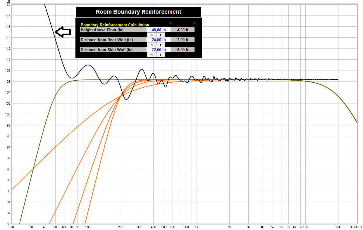

Agree post 14 verse post 15 has nice decay and that should lead to good clear midrange but also as ewollowe note there is really no bass amplitude. Reason those good waterfall think is low Q variation (roll off) from ideal flat response in minimum phase domain where the higher the Q variation leads to ringing tails, exactly the debate why sealed sometimes can be superior to ported. Imagine those waterfalls are anechoic or near field data so to replicate the fine data real world for final build remember to use it as near field speaker because as i see it as soon as speaker has to cooperate with room then responses from post 15 examples probably integrate better than post 14 will do.
Below picture 1 show some data that help see how lower Q variation is superior to high Q variations.
Picture 2 show example typical room mode data from a free Jeff Bagby spreadsheet verse the 5 times band passes from picture 1 and it looks obvious that green will integrate relative flat with room verse orange that will get a dip that will lead to a new ringing tail in waterfall compared when listening orange in near field.
Picture 3 data is all 2. order BW roll offs and think show the lower and flat extension one can get from speaker system all included at listening position the better the waterfall will show clear mids and audio band data from 20-20kHz (ringing tails get moved so low in frq they out of audio tracks area of energy).
