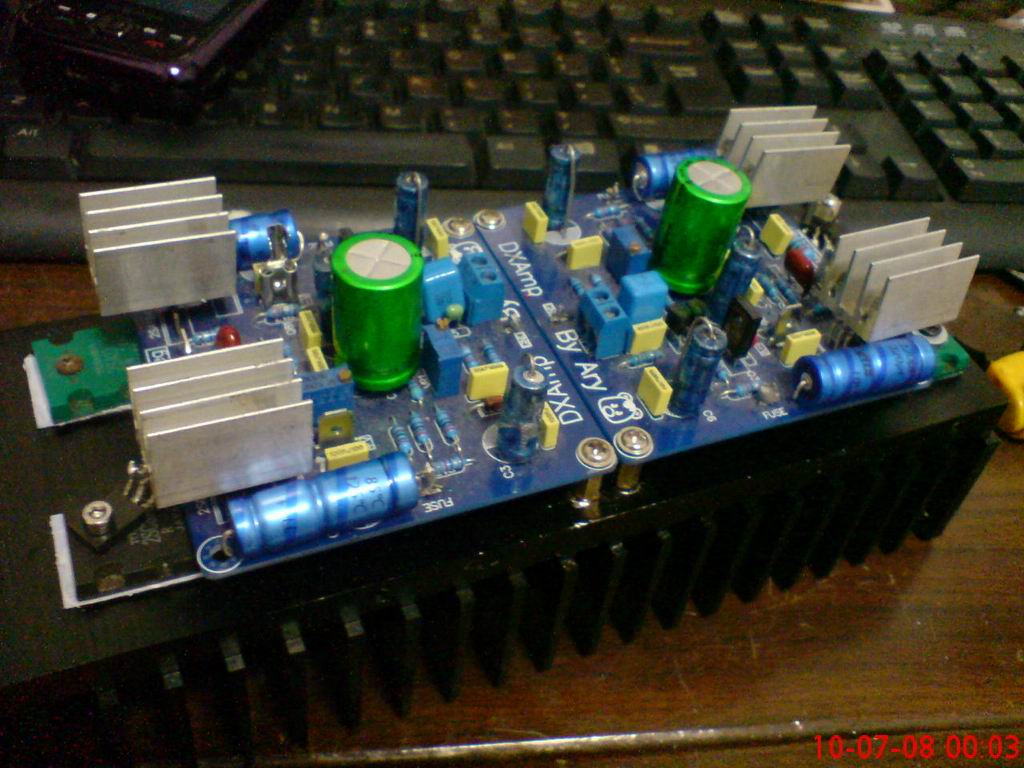

hi guaxian,
Yes I have a DX amp, and I really like the PCB layout you have there. 😀
BTW: I think you posted in the wrong forum.

Very nice , just one thing ... having drivers with separate heatsinks makes for more unpredictable bias. If room/case is cool , drivers will have X Vbe ,with a Hot case or room this will change.
For a type 2 EF the temperature coefficient of both drivers and outputs should be the same. If they are not , amp will be underbiased in the winter , normal or overbiased in the summer (that is if you originally set the bias in the summer).
I did this .. learned the hard way ..Just something to consider.
