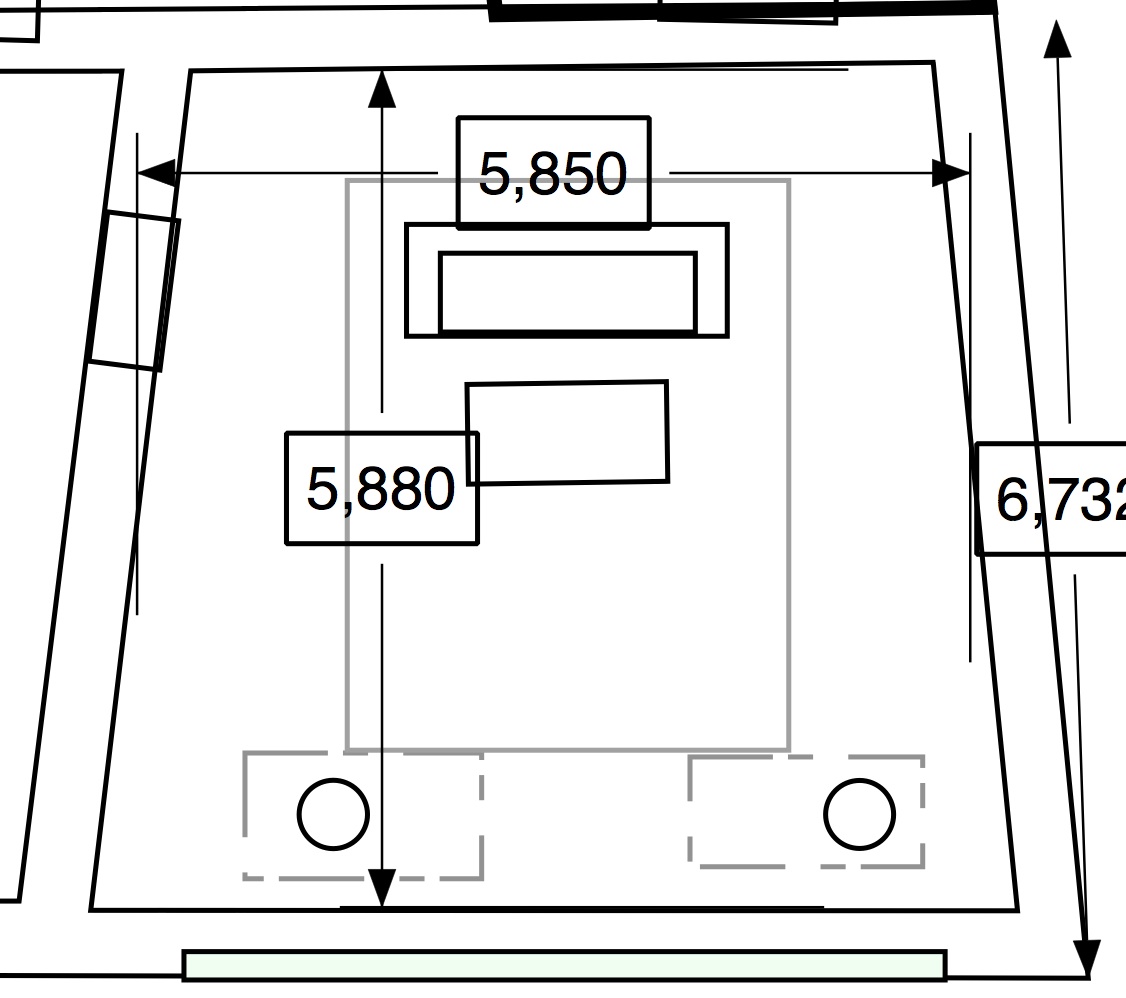

I'm planning the build of a new house where I will dedicate a room for music. I seek ideas and experiences for setting requirements and implementing such room for best possible reproduction of music.
At this stage I seek maybe more general aspects on a room and its fundamental design rather than detailed insight which would require optimization for a certain speaker make/model etc.
Some prerequisites:
- House will be made in concrete, floor, walls and roof. Concrete slab with styrofoam isolation. Walls will be 40-50 cm thick (passive house).
- I'm up for integrating a bass system into the foundation of the house.
- Size something like 35-45 sqm and 3 meter roof height.
- Quite large window - 5x2,5 meter
I'm thinking:
- None parallel walls for reduced standing waves.
- 2-4 100 litre cavities in floor for sealed bass enclosures for 12/15 inch woofers.
- Only one window.
Crazy things:
- Faraday cage
- Concrete pillar, attach to ground, separated from structure to place CD on.
- Bass horn in the slab
You think?

The only advice I would give is that the room proposed is almost square and that is as far as I know about as bad as is possible for room reverberations. Please do some research on this aspect of the design.
My own room is almost as bad being 35' x 17.5'; but it just happened to have a good floating floor on 140mm foam board above and below the concrete slab. The floor surface is 22mm board laying directly on the upper insulation board and not touching any wall. But still a much lower spec than Mr Toyashima would advise!

Its a lot more complicated than your musings and
FWIW non-parallel walls hardly make a difference.*
Good fundamental dimension ratios help a lot.
Practically, 1 to 1.6 to 2.5, Or 1 to 2.5 to 3.2.
rgds, sreten.
* A triangular room by one or two reflections
becomes a rectangular box for standing waves.
rgds, sreten.
Most significant is roof not parallel with floor.
dave
Toole looked at this in detail, and while there is no magic bullet shape for a (rectangular) room, avoiding dimension ratios that are even multiples of another is important -- irrational numbers are your friend.
