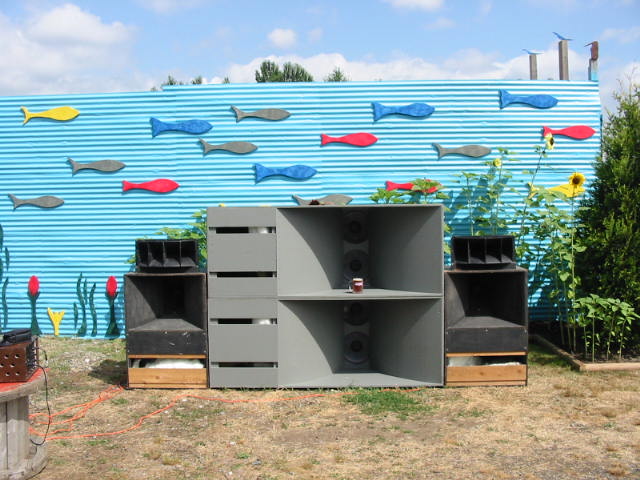

You know, if you put the bass cabinets on their sides they won't look that big to her.
My brother had a folded horn with an 18", JBL 10" mid bass (might be 12's can't remember) and horns in his sun room. Eventually stopped using the 18" out of respect for the neighbours.

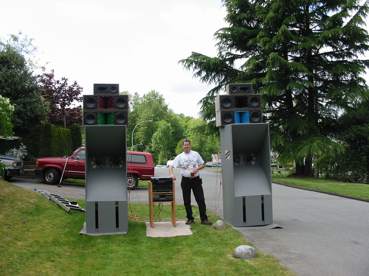

Cal, I bet your neighbors LOVE you!
I see. What blows me away is that the A7s look like bookshelf speaks compared to the monsters in the middle!!!
