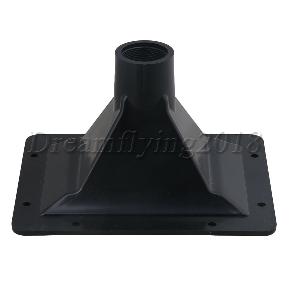

Then there is the cheapest compression driver I found,
https://www.ebay.ca/itm/Pack-of-2-P...ash=item3f7b90b611:g:RPMAAOSwcgNZCdJ3&vxp=mtr
Car stereo but the least expensive driver that wasn't piezo.
Then a ABS horn.
I know Pyle has been around for a while for car audio but no idea of how they perform.
https://www.ebay.ca/itm/Black-ABS-T...008012?hash=item48d39e3c4c:g:Ge8AAOSwmMVdksSH
That does look interesting if they will survive.

Pack of (2) Pyle PDS111 1" Neo/Titanium Screw-On Horn Driver 8-Ohm 1-3/8"x18 TPI | eBay
Then a ABS horn.
Black ABS Thread Diameter Plastic Screw-On Tweeter Horn for Speaker | eBay
Well for better or worse I ordered the above. Anybody have opinions on crossover frequency?
Horn size. Size: 19.5x15.5cm - 7.68" x 6.10"(LxW) So take away about half an inch for the flange, so about 32" mouth area. My brother threw out our copy of the Audio Cyclopedia, never thought to ask me first. I am sure they had a chart to give me some idea where this horn operates at. 2-3 kHz maybe?
