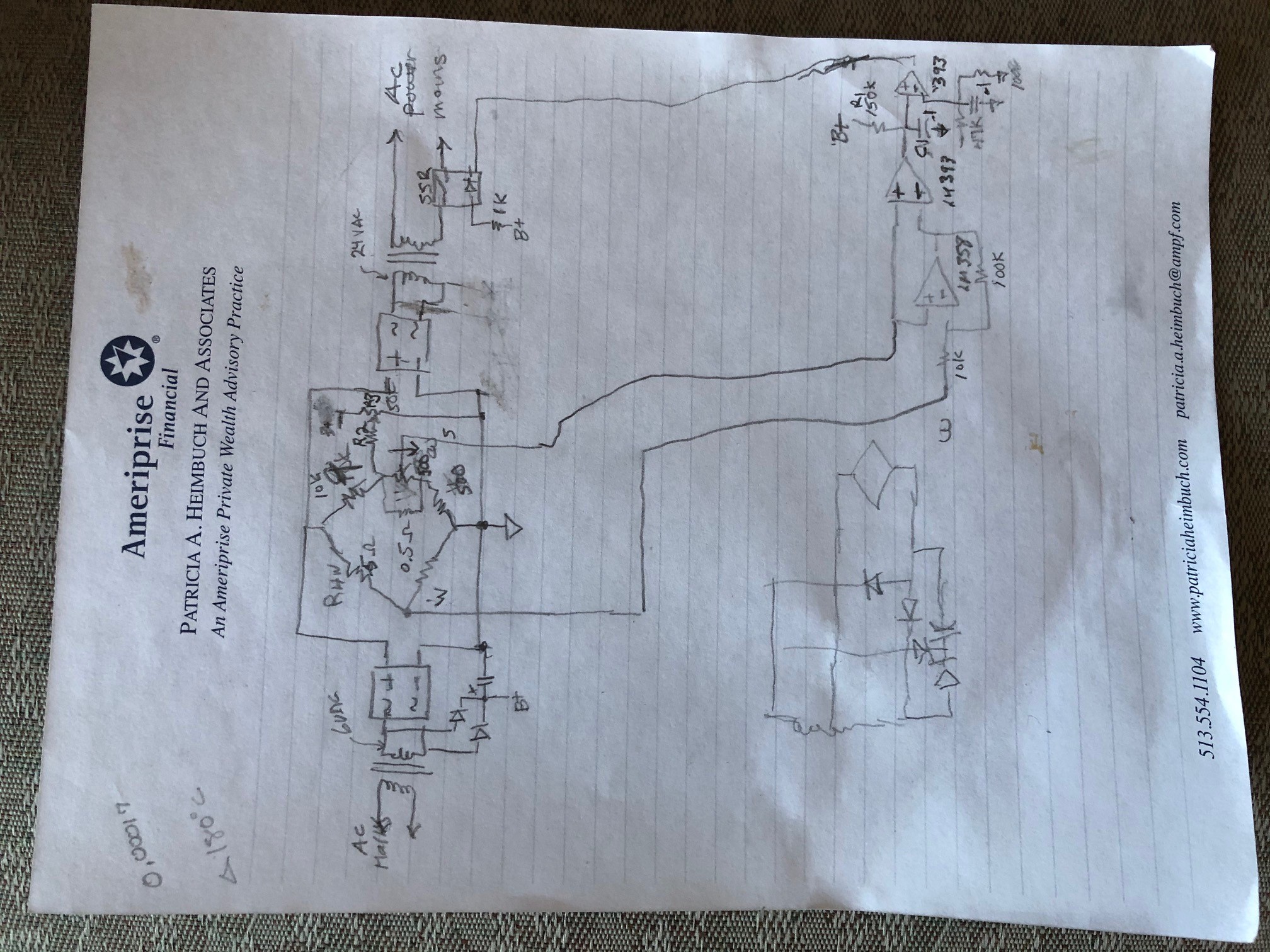

I would make the hotwire one of the resistors
Thanks also for the well considered response, I will think over your circuit and explanation.

I'm sorry if I [was] overly cute..
On the contrary, the circuit is cute in the best way, it's a classic Wheatstone, I like it!

I have a similar application and tried to make a simple control circuit for the FET.
I use a 48V/10A supply and the 6A LEM as mentioned in my first post.
Pot VR1 is used for calibration of the cold wire resistance
With VR2 the desired temperature can be set between 100°C to 300°
the 5ohm wire has 6.8R at100°, 9.05R at 200°, 11.3R at 300° for pure metal like W(Tungsten)
function of the circuit:
trigger from timer switches output to high and stays high as long as the load current is greater than the preset value at -in. When the wire heats up the current ramps down, the moment the preset temp is reached it switches to low. It continuously heats up the wire as long as it takes with 400W start value.
when low the same starts again when the next trigger comes after 100ms.
If the current is lower than the preset only a short 50us pulse is done which we use for the calibration.

The second comparator controls the user interface. On startup the P-MFET pulls up the +in for 3s , D2 latches it on high and only a manual pulse with pushbutton can start it with comp= low
now it compares the preset value with the LEM out and switches only off when the current is too high (short or R<5ohm) or when the stop button is pressed.
It also performs the calibration. Very easy
turn temp control to 300° and R-control to 5ohms , press START
Now we have the 50us full current output pulses and turning the calibration pot slowly up when the proper threshold is reached the comparator switches to low
now the temp can be chosen and the start button allows normal function.
