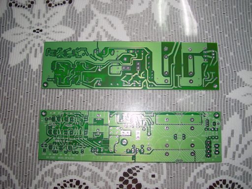

My Power Diamond Buffer is quite stable, and now a Taiwan Audio
company is preparing to mass product this Power Follower with
their own 10dB step-up IPT.
http://www.diyaudio.com/forums/showthread.php?s=&threadid=71557
This is their all-in-one PCB
Power Follower 99C

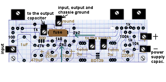

Hello
I'm in the process to give a try to the Power Follower 99C .Unfortunately I don't know how to contact to Andrea .
I do not have his E-mail address .
I have a question
On the schematic there is one 2k2 resistor and one 220R
On the layout there is two 2k2 resistor and no 220R .😕
I dont know which one is correct .Can someone help me lease with these problem .
Thank you very much 😀
Greets gabor
