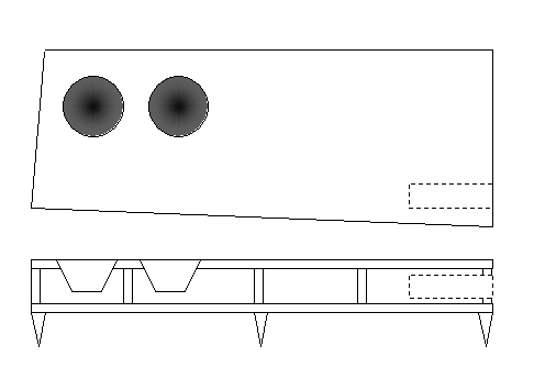

I was wondering: I'd like to experiment with the use of a subwoofer. I don't like having speakers all over my room, and most subs are IMHO rightout ugly.
So, I thought, why don't I make a sub which fits underneath the couch? This would make it long, deep but not high.
I know that this does not meet the conventions of speaker design. But since conventions sometimes only are a remembrance to earlier times, perhaps it might actually work.
Any thoughts on possible positive / negative influences of this kind of box?

When dealing with low frequencies, box shape is not an issue. The only thing that I would be concerned with is providing adequate ventilation of the pole piece at the back of the driver. I've found that when you mount subs with vented pole pieces into very shallow enclosures, you get some nasty noises when you turn it up.
You may want to consider having the woofers fire down rather than up. When stuff from the couch falls into the woofer cones, you're gonna get some disturbing rattles with your current design...

Yeah even better perhaps, but I know of no program to design and optimize the speaker by doing what you propose...
I was thinking to make the spikes re-mountable, so that I could turn the whole sub up-side-down. Just to hear whether there are differences, and to empirically find out what sounds best.
I also wanted to place the amp outside the box, so that I can place it next to the couch and within reach.

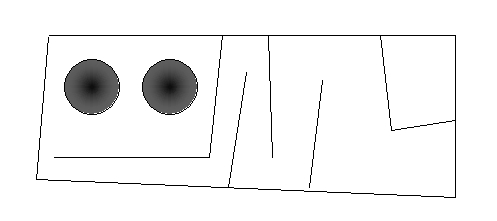

Let's say that the box becomes 1.7 m wide, then the lowest mode inside tha box will appear at 100Hz. So you probably cannot skip the stuffing as you can with more cubic boxes.
Otherwise it is a nice idea, probably you will *feel* the bass more. The (tactile sensation)/(neighbour disturbance) quotient is probably high. 😀

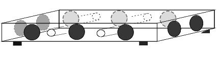

A huge sturdy box, maybe even two drivers, as the base of the couch, then just add a back and some cushions and you have a sofa-sub. Talk about tactile!
(make sure the drivers aren't facing forward, they might take a heel)
If you use this flat box idea, you might want to consider a MLTL enclosure, since it should be possible for it to be rather tall, and still not make much of a footprint in your living room.

Can you perhaps tell how did you did that calculation? I think one could easily design a box which is 90-100liters which fits underneath a couch.

I was also thinking: I need to brace the speaker on the inside, so if i'm gonna do that, why not design a bass-tunnel inside. Like so:

I was not thinking at all about what box volume that was required, I just assumed that you would want to use the entire space under the couch. In that case a width of 1.7 metres would not be unlikely, given the normal size of a couch. The first mode of a box of that size would be c/(2*L) = 340 / (2*1.7) = 100 Hz. Of course if you make the box smaller, there is less problem with this, if it is a problem at all. Sufficient stuffing would take care of the standing waves anyway.
