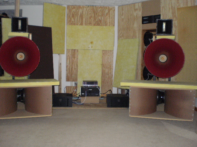

My Audio listening Room is Large 5mts x deep 6mts. The listening distance is ~ 4m. All rooms in the last 6 years, my playback was installed, were moreless this size. After many years listening and experimenting with different kind of horn systems and configurations, i have moved towards a simple 2 way solution, basically direct radiators : Beyma TPL, and 12p80nd. They sound superior by all means compared to my previous big 5 way horn rig. This is making me questioning. Why is that so ? Some systems, which were the most impressive ones, i ever heard, where AV Trio based horn systems. BUT: They were ALL installed in BIG rooms. That means, above 50sqm. That is making me think: what is the correlation between direct radiator x horns, room size ? I remember, when i was a kid, my dad was a speaker builder, he said: These kind of speakers do have the property of launching the sound wave far apart, and the energy/efficiency far away is not being lost. My point is: Could it not be, that hornspeakers shine only, and give THAT impressive sound, when the sound waves emitted through horns do have the hability to evolve enough in the room they are in ? Maibe some experts could give their opinion on this.

I have also reached a very nice and unexpected synergy in an all horn system. In my system, the "Bell-Labs" midrange is handled by one section.
It's a Tang-Band 1772 driver mounted in a vintage round horn. It's effectively a point source, and in a horn system like this, baffle step is non-existant.
The mid-bass is a hybrid horn of sorts, fed by a ppsl motor housing 2 @ Eminence 4012HO drivers. This affords me the "punch" I have always sought after, yet, at the same time is very smooth and graceful in the lower mid-range; male vocals are superb. The very deep bass range is handled by an infinite baffle system extending down to 17Hz. Highs and super highs are easily and effortlessly expressed through the Stage Accompany Ribbons.
This is by far the best I have done after 41 years of "tinkering". You have also seemed to have reached something you are exicted about enough with to want to share with the entire audio community- and that is good. Point being, there are many paths to audio nirvana depeding upon one's own personal tastes and, as you say, a system "fitting the room". My listening room is somewhat larger than what you had descibed for your past systems, but not to a huge degree. Life-like dynamics and a realistic presentation are the 2 lumps in my "cup-of-tea", but many others will disagree and place some other aspect of "sound" in their priority list. To that I say: to each their own and......HAPPY LISTENING !!

Hi Scott
i follow the evolution of your system already a few years. Very interesting outcome. What are the crossover points, and what it the room size ?
It seems your approach is to make the Tang Band to play in a wide range, and only reinforce the two frequencye extremes , and so getting high coherence ?
Your eminence 4012HO has a very linear frequency plot from 100hz up to 800hz without hornloading.
http://www.eminence.com/pdf/Definimax_4012HO.pdf
The Tang Band 1772 has a slight efficiency increase of about 10db above 1khz, below its very linear as well.
http://www.tb-speaker.com/detail/1230_04/w8-1772.htm
Have you measured your channels individually ? Theoretically, you should have a decreasing frequency plot in both horns.

It's a 4-way. The TB covers 250-3.5kHz
Sub-bass below 60, midbass 60-250, Ribbons above 3.5K
Slopes: sub/24/midbass/48/mid/48/tweeter

Yes, it's an ecellent driver, but I wanted to try a ppsl compression chamber driving a horn. Can you say dynamics ?

The horn actually "lifts" the response as it decends in frequency.

Angelo,Could it not be, that hornspeakers shine only, and give THAT impressive sound, when the sound waves emitted through horns do have the hability to evolve enough in the room they are in? Maibe some experts could give their opinion on this.
The greater the distance between the radiating elements, the further the distance required for integration of the individual sources. In a small room, the reflected sound of multiple widely spaced radiating elements off-axis response can degrade both image and frequency response.
In addition to basic sound quality issues in the near field, there is the imaging problem of the perception of sound "walking" with frequency up and down a large multi-way system when you are too close.
One can "cheat" typical separate component horns with DSP and time align to a close listening point, but the overall room response then is degraded.
If one tries to use physical time alignment of a large multi-way horn system, the horn length differences often will cause mid and high frequency reflections and diffractions from around the various horn mouths.
If one "lines up" all the horn mouths on a single baffle to avoid those problems, the problem of a changing acoustical source off axis comes in to play.
Multi-way systems like Danley's Synergy horns avoid all the above problems of typical separate component horn systems, and can sound excellent at any typical listening distance, even including your ears within the single "full range" horn mouth.

I apologize for not answering fully. My overall room size is 24x29 feet.
Right now, my listening area is off-center. I sit 13 feet away from the speakers which are 8 feet apart. A very, very large percentage of the room's surfaces are covered with acoustic foam and/or 2" thick rigid fiberglass. It's an
acoustically dead listening area. I'm hearing mostly direct sound. That might have something to do with your theory. Hope this helps, be well.
