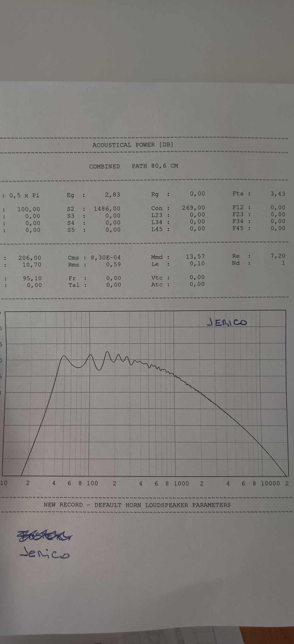

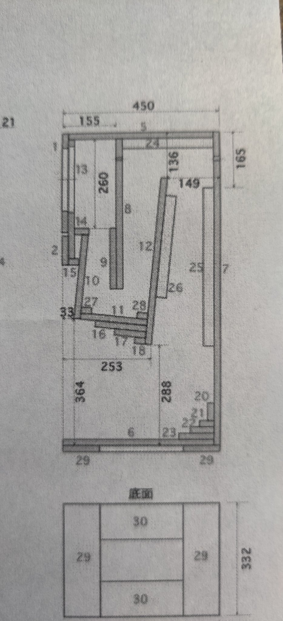

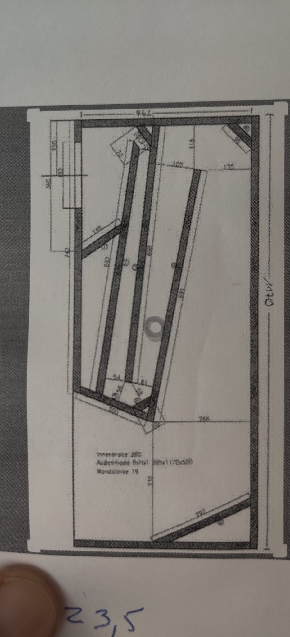

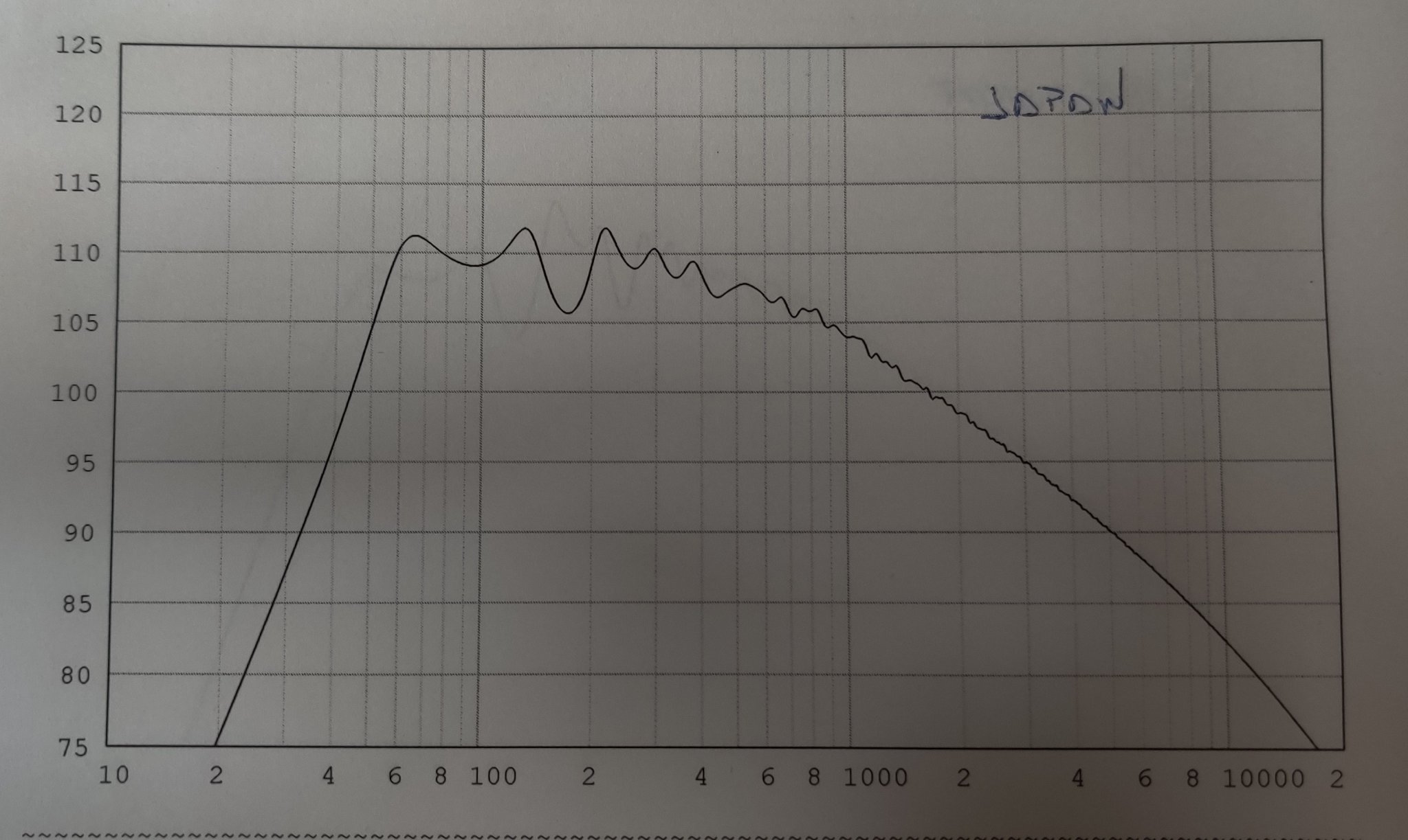

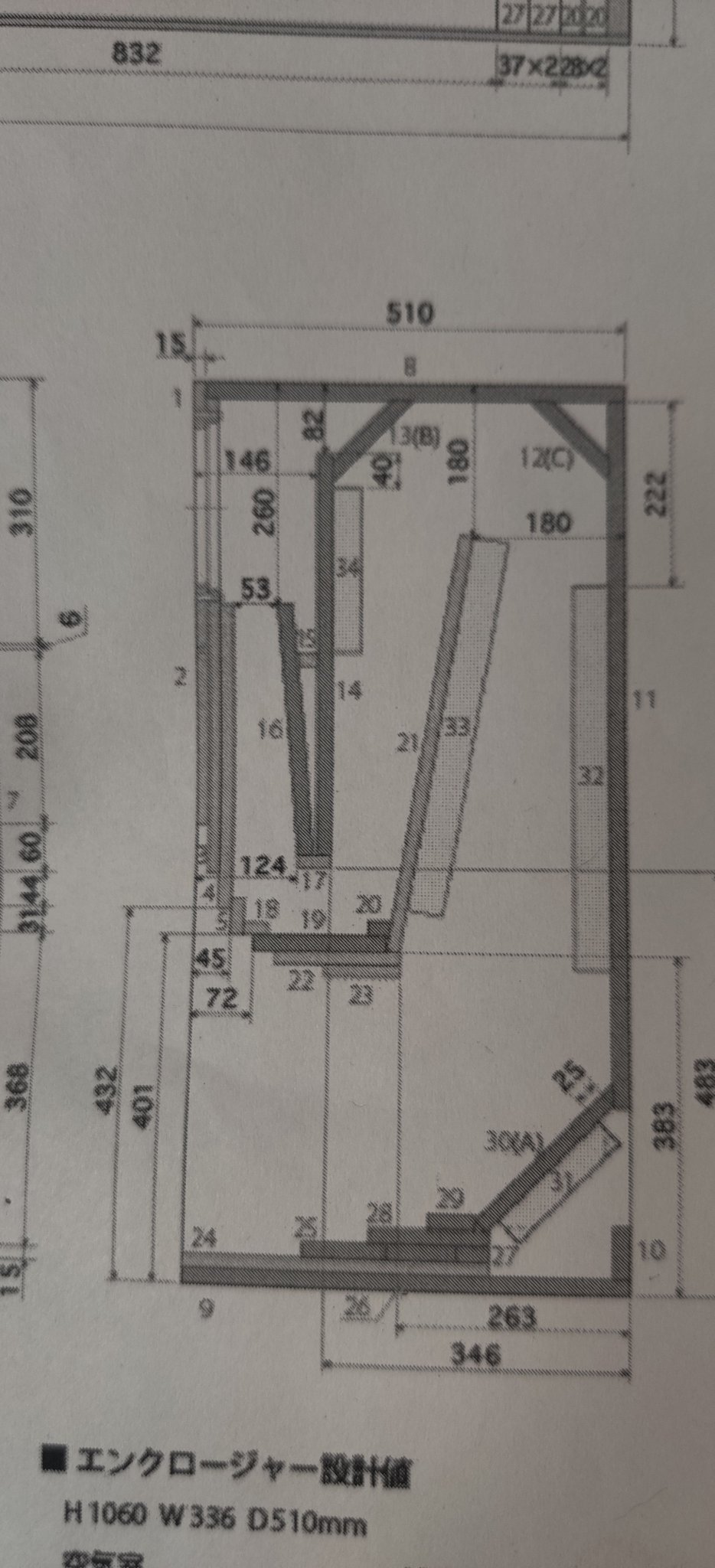

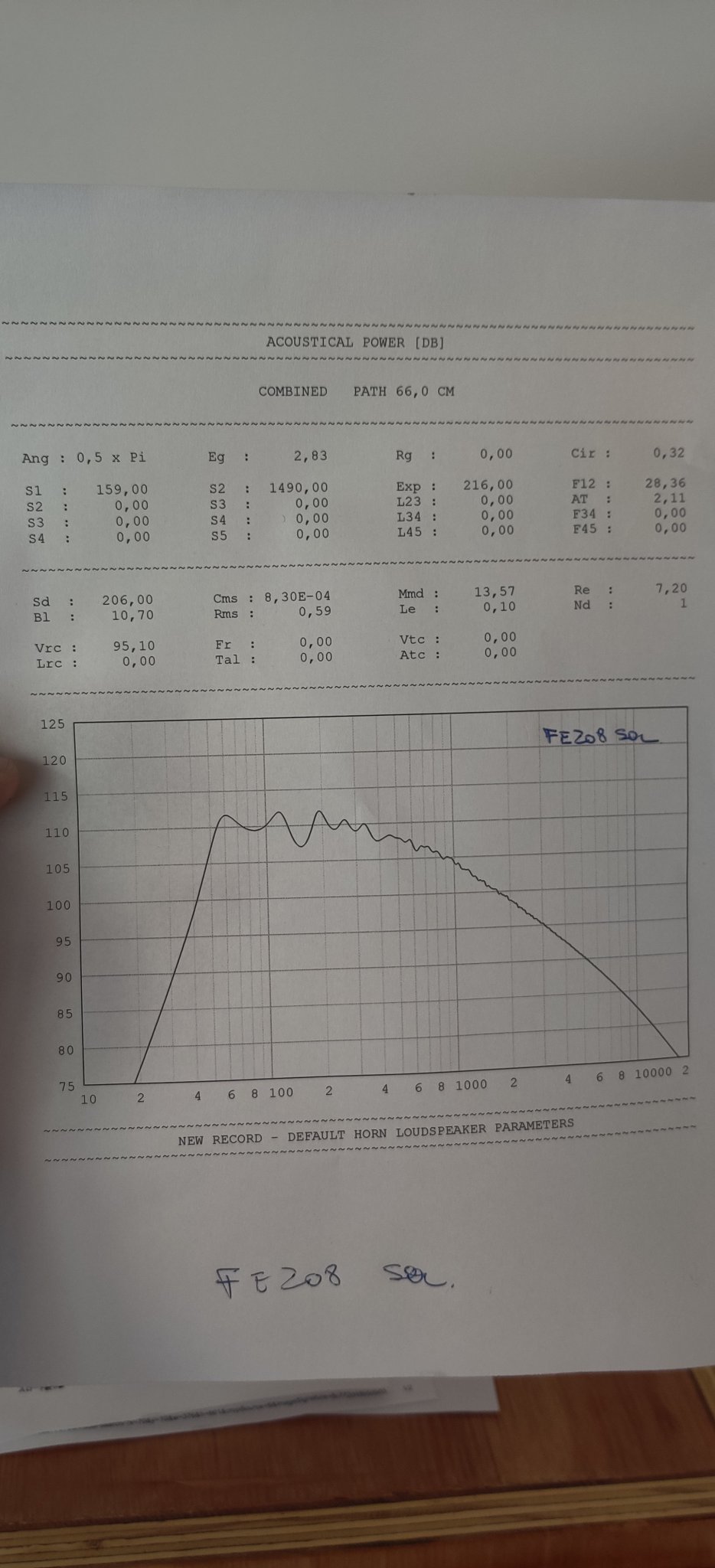

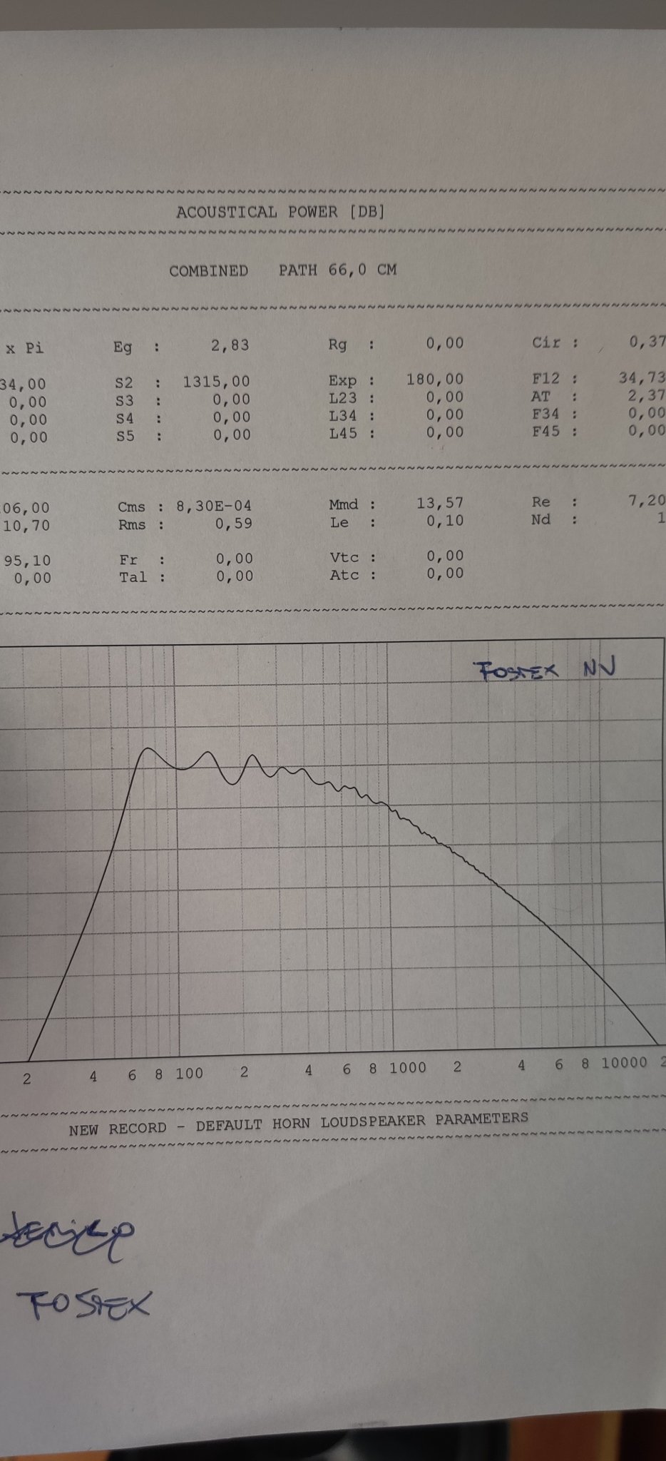

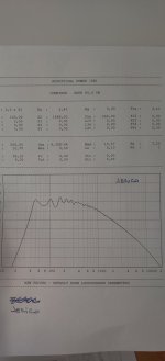

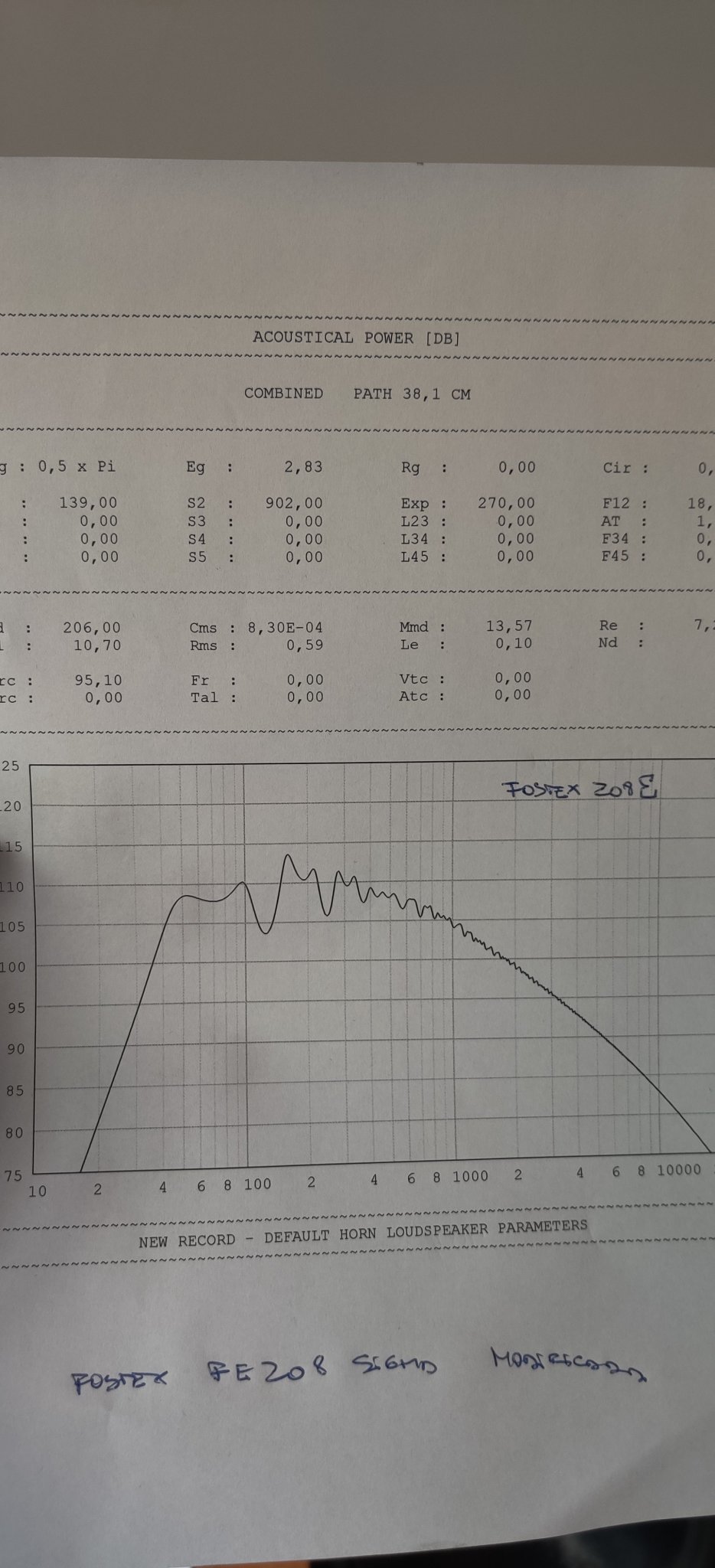

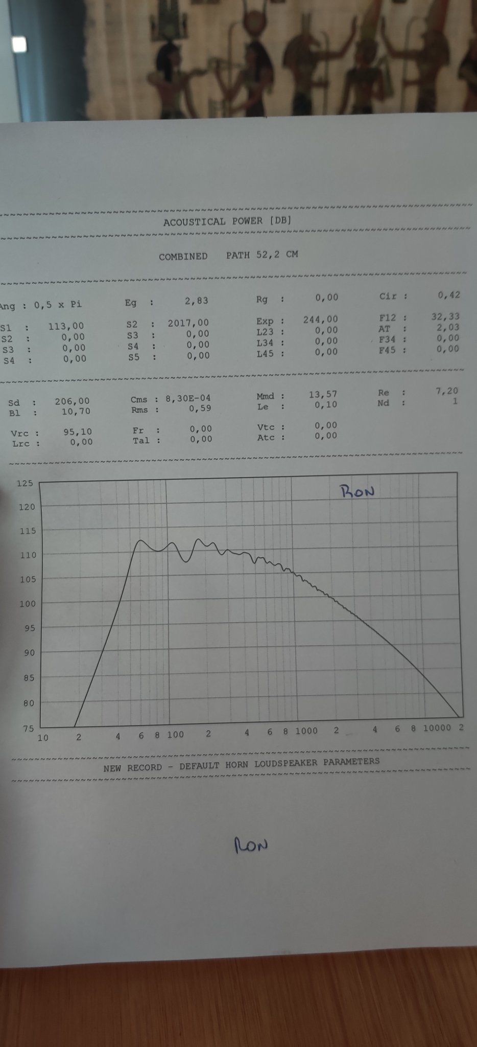

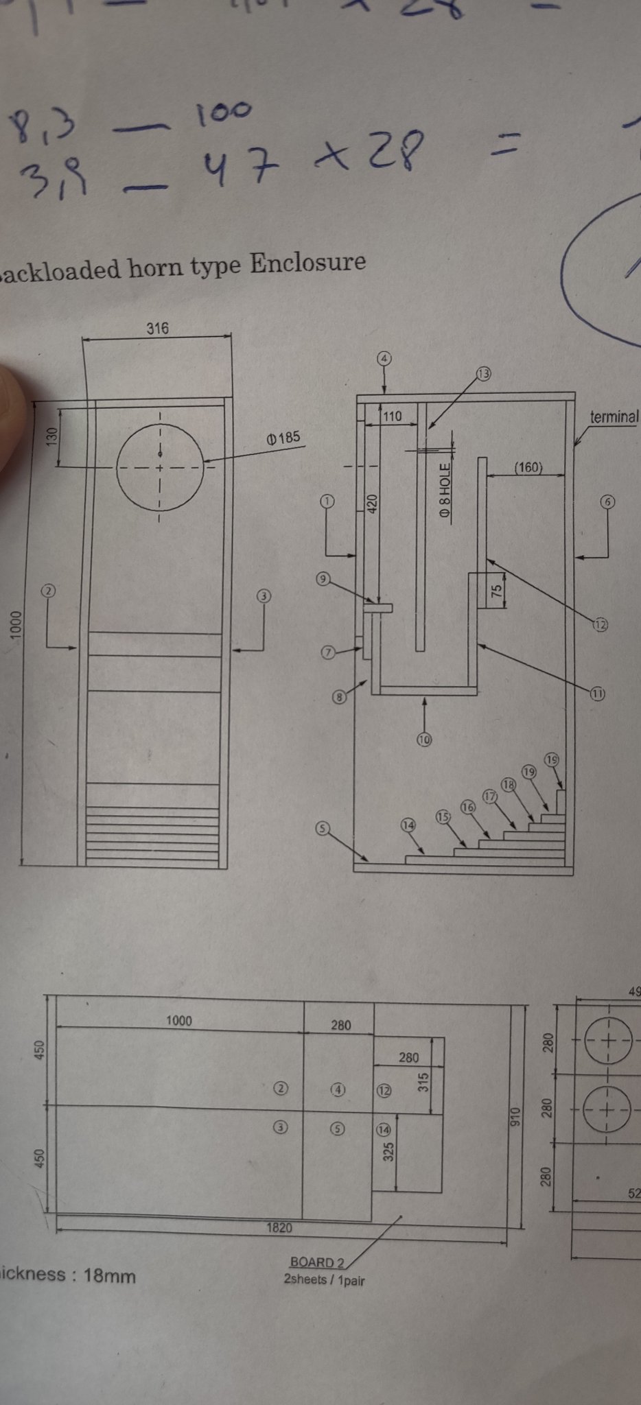

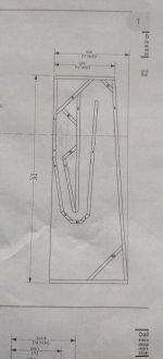

Hello. I learned to use the Hornsteps. It's not hard and I simulate the Horns that I found for the Fostex FE206NV. There is very little information on the NV as it is relatively new. All the information there is for the Fostex FE206EN. I share the simulations and the Horns.
Fostex modification

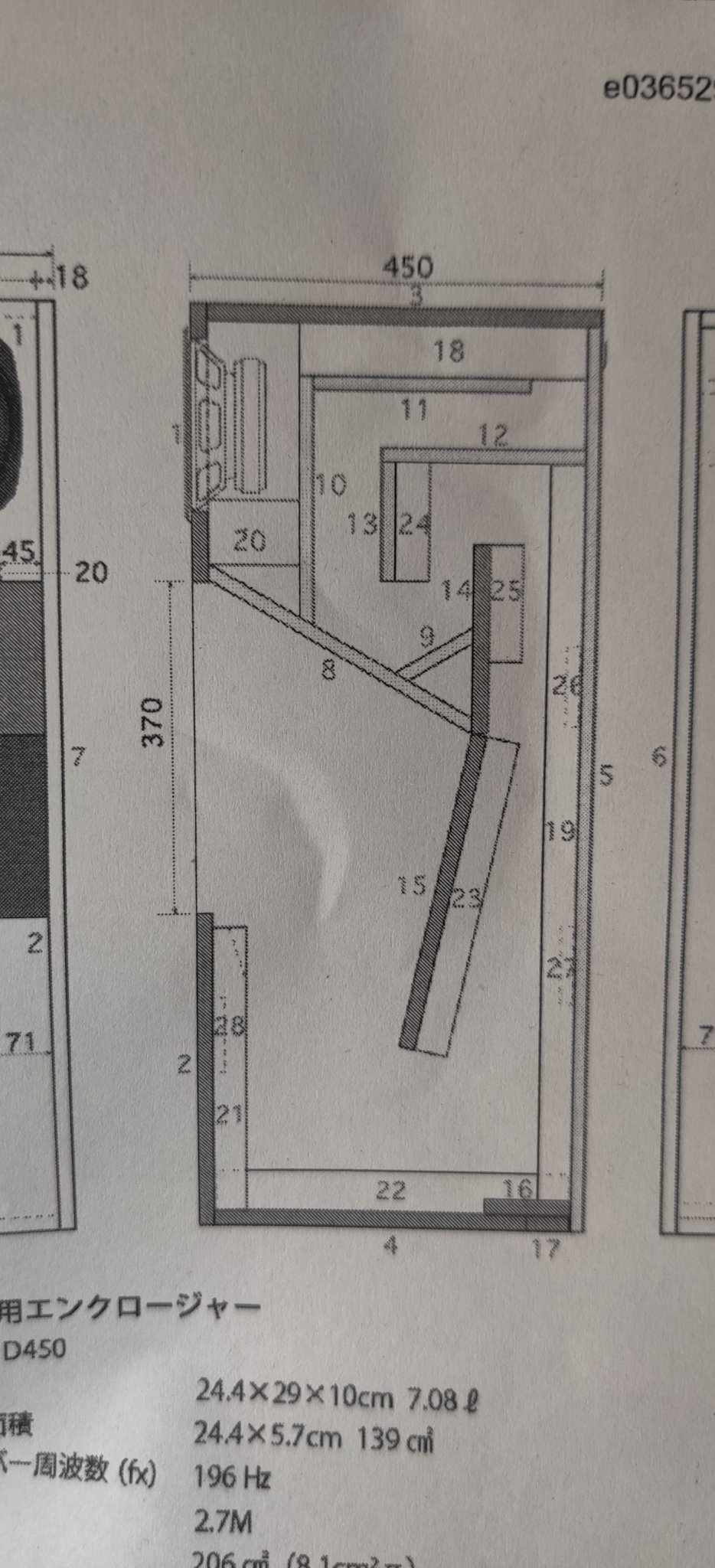

Ron's horn is difficult to build without the correct tools. I like Jericho. What do you think?

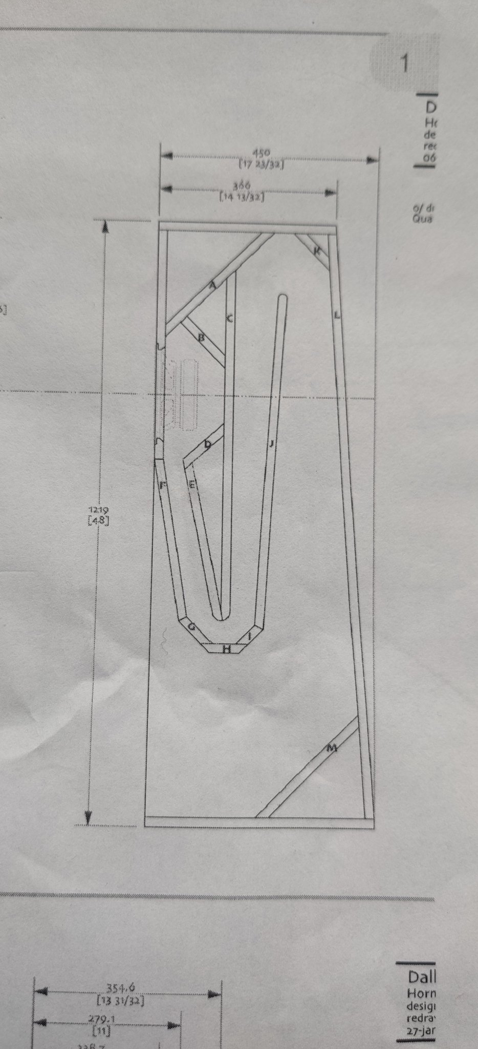

I discarded the Jericho horns after I built the Dallas II.
As I said in the other post, they are not that difficult to build, just need some care.
Also, I know nothing about the software that you are using, but I am surprised that your plots are so similar for different builds.
I wait for experts to comment.

I would like to build Dallas II, but I don't have a bank circular saw. I always made my boxes with a jigsaw. On the other hand, for me the graphics are not similar. All are differents.
