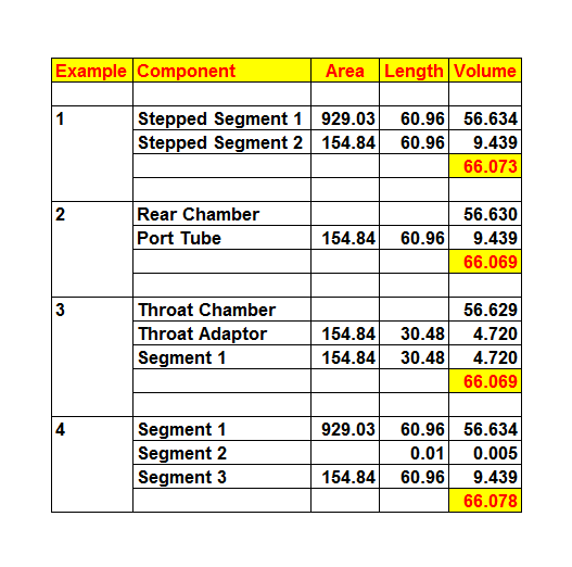

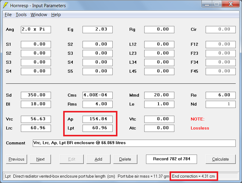

I'm guessing the 50.70 version of HR is the reason for the volume variance between the Stepped model (66.073 liters) and the other 3 models (66.069 liters).
The volume of each component in litres is rounded to 3 decimal places and the rounded component volumes are then added together to obtain the system volume. This is why total volumes for seemingly identical systems can sometimes be slightly different.
The breakdown of volumes for the 4 examples you gave are shown in Attachment 1.
Notes:
1. Because example 2 uses Ap and Lpt to specify the port tube, an internal end correction of 4.31 cm is automatically added to the length used in the calculations, as shown in Attachment 2.
2. The length of segment 3 in example 4 should be 60.96 not 60.90.
Reactions: BP1Fanatic

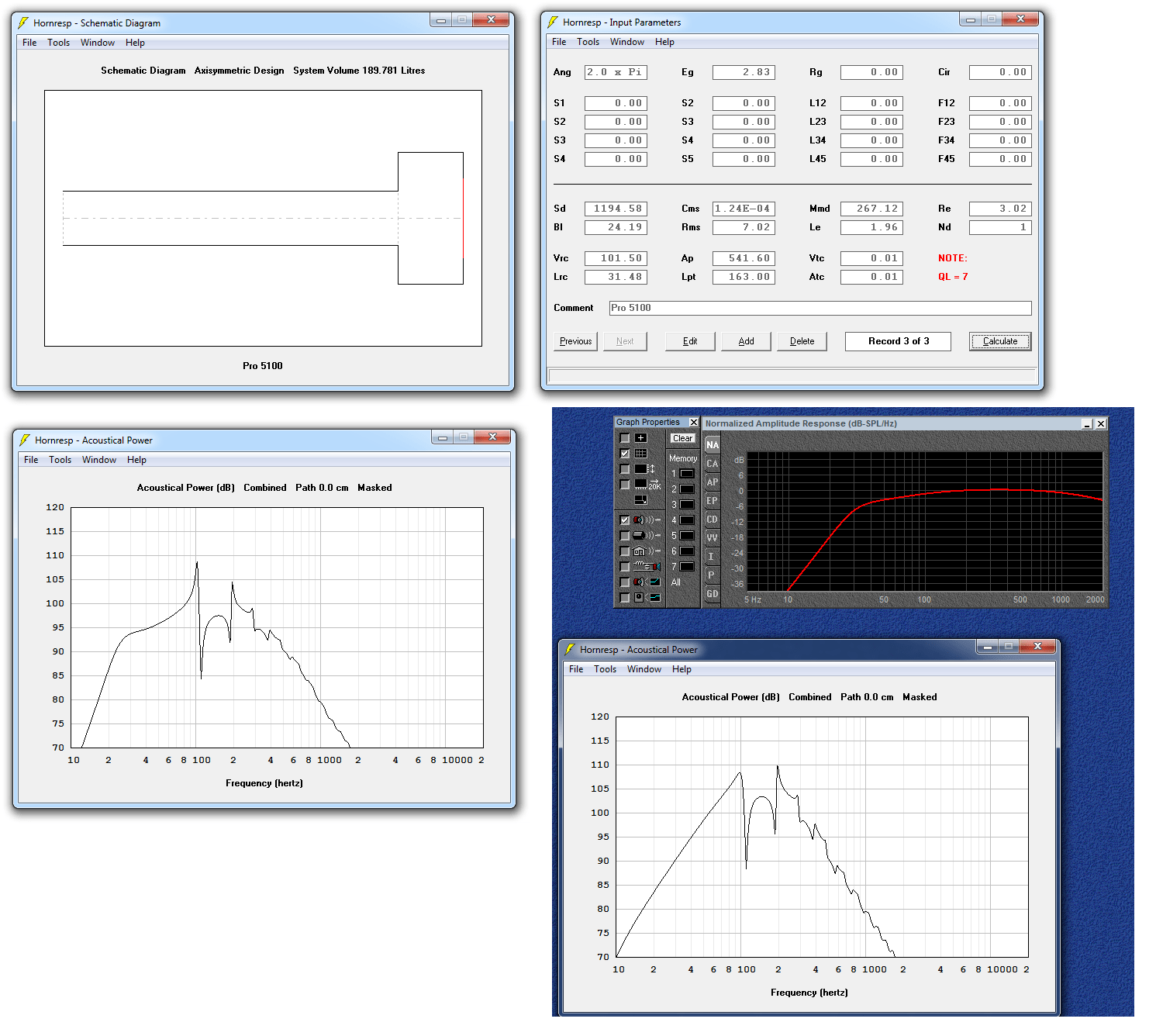

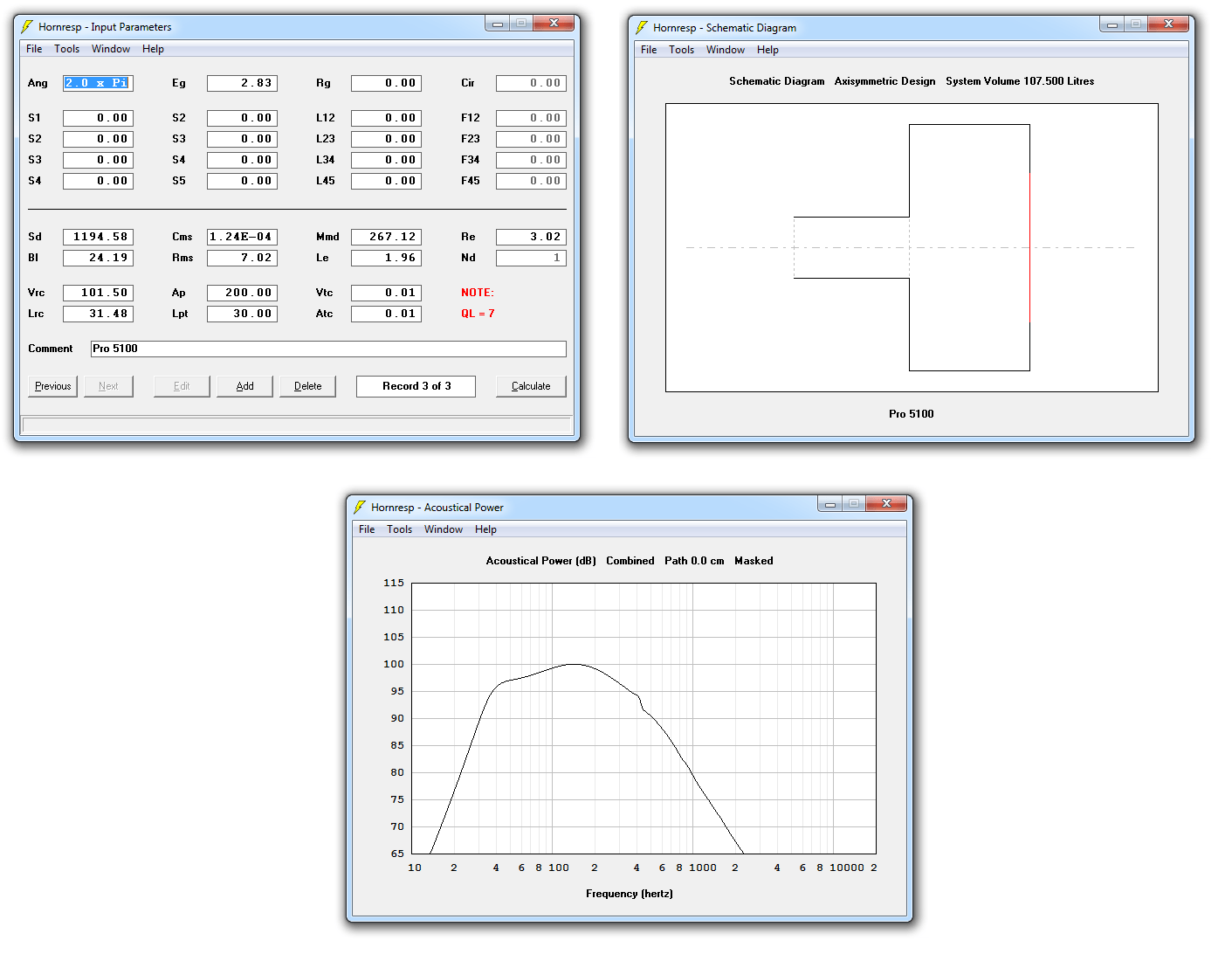

Not surprising I got very different results. Can anyone spot what I did wrong?
Also am I supposed to subtract, add driver volumes? I figure since we aren't asked to pick a driver to identify it, driver volumes aren't considered, so I am guessing we are looking at box volume only... So I have put in 101.5 litres.
So when we are entering port length are we supposed to add that extra number, or are you merely telling us that is going to be added to the length?
If Ap and Lpt are used to specify the port tube as was done in example 2, then Hornresp will automatically add the end correction.
If a segment is used to specify the port tube as was done in examples 1, 3 and 4 then the user needs to be aware that an internal end correction will not be automatically added, and account for that accordingly (it cannot be automatically included because Hornresp has no way of knowing what the segment is being used for).
Reactions: Kravchenko_Audio
Also, you have specified 4 drivers in Hornresp.
Not sure how that happened think it carried it over from something I tried before.

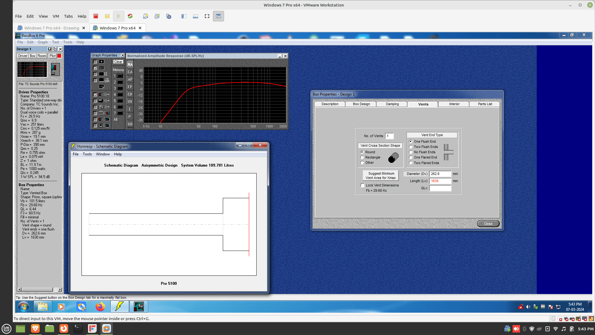

This looks a bit closer. Your right that is more like a transmission line. I put a far more sensible port in (not suggested to achieve xmax) and it still show the same response curve, so clearly it is not factoring that in. That being the case how can I trust it to build a box (and how far out is stuff I used it for before)...

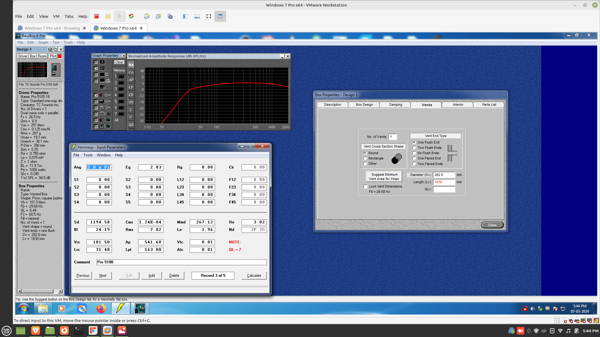

Took a guess at something more like what I think a port should be, and I got something that looks like a woofer frequency response. I don't know what things like vent velocity are going to be, or if it is going to exceed xmax, as I can't see that info in the program. But I now have a starting point for a simple BR box.
How do you tackle things like acoustic dampening? Just add a bit to the box volume?

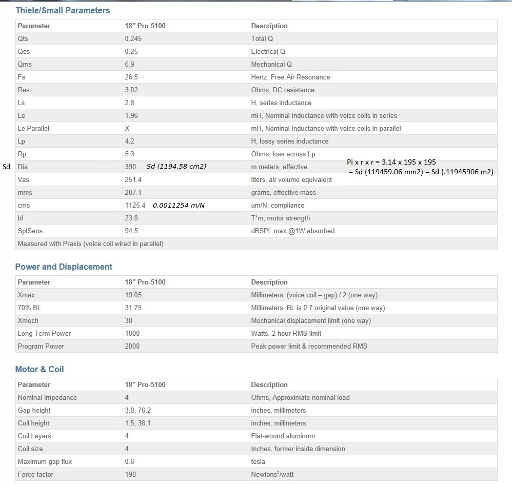

It would be worth checking that the driver parameter values are correct.
Bl is specified as 11.9 T.m in BassBox and 24.19 T.m in Hornresp, for example.

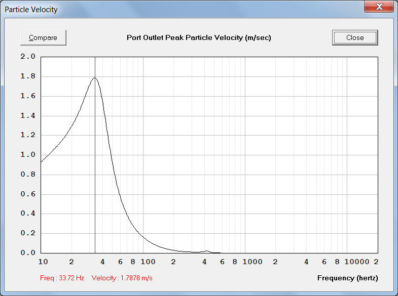

1. Calculate the acoustical power response.
2. Select menu commands Tools > Output > Port.
3. Select menu commands Tools > Particle Velocity > Port Outlet.
Not necessary - you are using the 'resonances masked' option.
